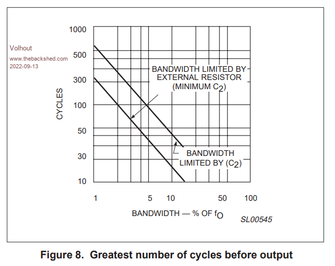

About the LM567
It is a PLL tone detector. It has a variable oscillator with centre frequency (set by component values) and a build in tuning range for that frequency, the "lock range".
From the datasheet: the maximum lock range for the single LM567 is 14% (typical, maximum 16%). This means that you need worst case 1/0.14=7 cycles to achieve lock, and that is reflected in the attached graph (from the datasheet).
This means that you may have a good chance of detecting 8 cycles of 2400Hz (not guaranteed, but possible), but 4 cycles of 1200Hz is far below what a single LM567 can do. If you narrow the range, it takes even more cycles to lock (detect).

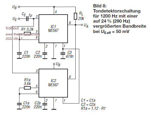

There is an application note where they use 2 LM567's each with a 14% lock range, to expand the lock range of the set.
This circuit diagram should fulfill your needs for the 1200Hz detector for FSK cassette tape. Ue is the input (20mV..200mV input voltage, Ua is the digital output, when powered from 5V (Ub) this circuit will output 5V logic).
Good luck...
P.S. NE567 and SE567 and LM567 are compatible.

So, if I use one set up for 1200Hz(1) and one for 2400Hz(0)  - with 10 cycles per "bit" with 10 cycles of "silence" between each 1 and 0   -- granted I've just made my own encode / decode protocol, but about as simple as it can be.
I could "detect" each on a separate pin or OR (NOR? as it goes low) them together....
Got to do the day job now (sigh).
N
Posts: 6169
Posted: 10:06am 13 Sep 2022
I think the silence in between is not needed. Just 1200 and 2400.
In advance of any tone there will be silence.
If you route both detectors to separate pins you can detect
"11" = silence
"01" = 1200Hz
"10" = 2400Hz
"00" is fault

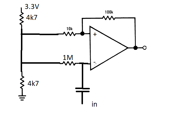

You may have to adjust the pins used to suit your setups.
Tested with the picomites running at 250k
A bit_time of 3.0 for sending and 3.1 for receiving is reliable on my setup.
Set the CONST dir_mode to 1 for sending and 0 for receiving.
I used the simple audio filter so there was some 44kHz noise.
No effort has been made to streamline any of the functions.
The only additional IC is a LM324 op amp configured as a comparator with a bit of hysteresis. It runs happily on 3.3V, noise and all.
