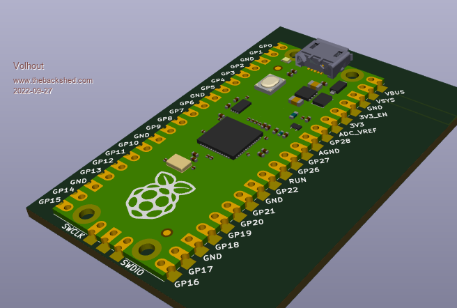

Posts: 6169
Posted: 06:22pm 26 Sep 2022
KICAD has a nice PI 3D symbol....
Posts: 9185
Posted: 06:34pm 26 Sep 2022
I had a play with KiCAD some time ago. I thought it was very good to work with providing you didn't need to create new components. The hassle involved in that really put me off it. Even following (or trying to follow) the manual was a real chore for me as it deemed to assume that you already knew a lot about PCB design.
