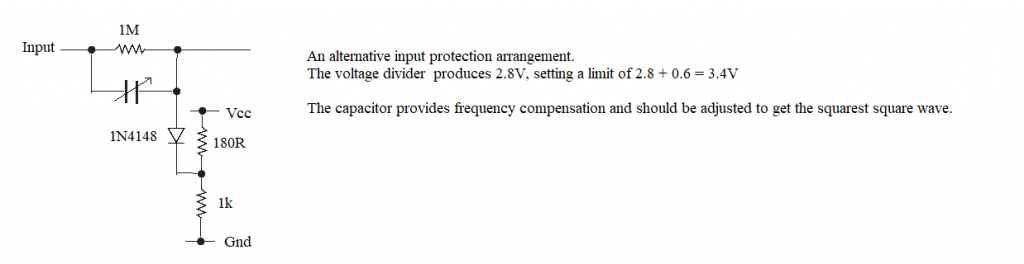

Ah - it may have internal forward-biased diodes to VCC and you are seeing leakage. You'd be better using a simple BS170, 2N7000 or similar MOSFET on each output, driving the gate directly from the pin, then switching them on & off. You'll get a good open drain output then, at the expense of a bit of board space.

  OA47 said  What I was trying to achieve is an auto ranging resistor network to measure DC voltages on the Analog IN pin. I have used this circuit on the ARMites and MicroMites.
OA47
Should R4 be connected to the input (like the other resistors)?

  Quote  Should R4 be connected to the input (like the other resistors)?
Sorry John I had left off the junction spot.

Posts: 3411
Posted: 11:39am 28 Sep 2022
Volhout said:
" For this diode to work, it should be a shottky diode. And these tend to have high leakage (1uA). "
Could that leakage be the problem?
Temporarily remove it, leave the input open circuit then measure the voltage on the pin in all conditions.
If that is it then some other protection measure will be needed.

Posts: 3411
Posted: 10:47pm 28 Sep 2022
Assuming this input attenuator is for a scope, frequency compensation will be needed to get the best out of it.
Since the Pico input has capacitance you need a capacitive divider that matches the resistive one.

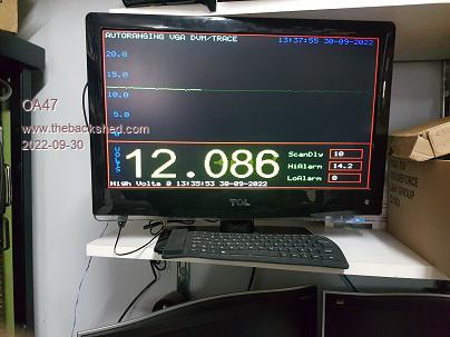

  Quote  I am not sure OA47 is going to build an oscilloscope, so the capacitor may not be needed.
Here is a screen shot of the project. Not a desktop DVM but a shelftop DVM, one I can monitor from many meters away.

Posts: 6169
Posted: 05:56am 30 Sep 2022
Nice project! A monitoring system.
And yes, readable from a distance...

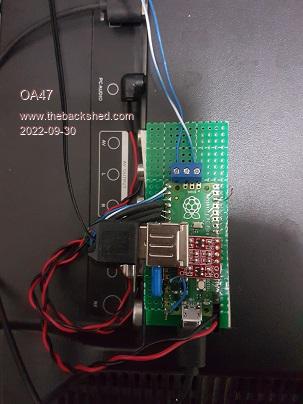

The use of an old LCD TV makes things easy as it can supply the pico from USB, has VGA input and audio input all readily accessible and the system can be powered down via IR remote.
Here is a pic of the prototype pcb so far.
