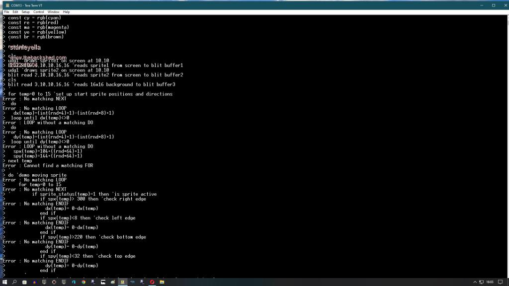

"So how did you stop the program from MMEdit?"
  stanleyella said  in mmedit
OPTION EXPLICIT
OPTION DEFAULT NONE
option autorun off
halted the code and turned off autorun and now Teraterm is working as "normal".. I try not to use a terminal. So happy days and sorry for wasting your time.
I thought option autorun was a terminal command when it was a permanent command.
odd it stops teraterm though??
ctrl-c works after a few seconds, gives several >
Trying again after repower and ctrl-c does nothing?
Edited 2022-10-03 06:03 by stanleyella

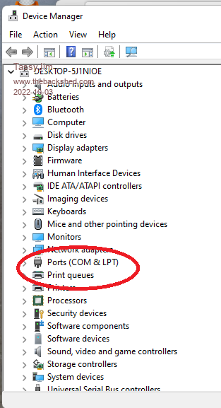

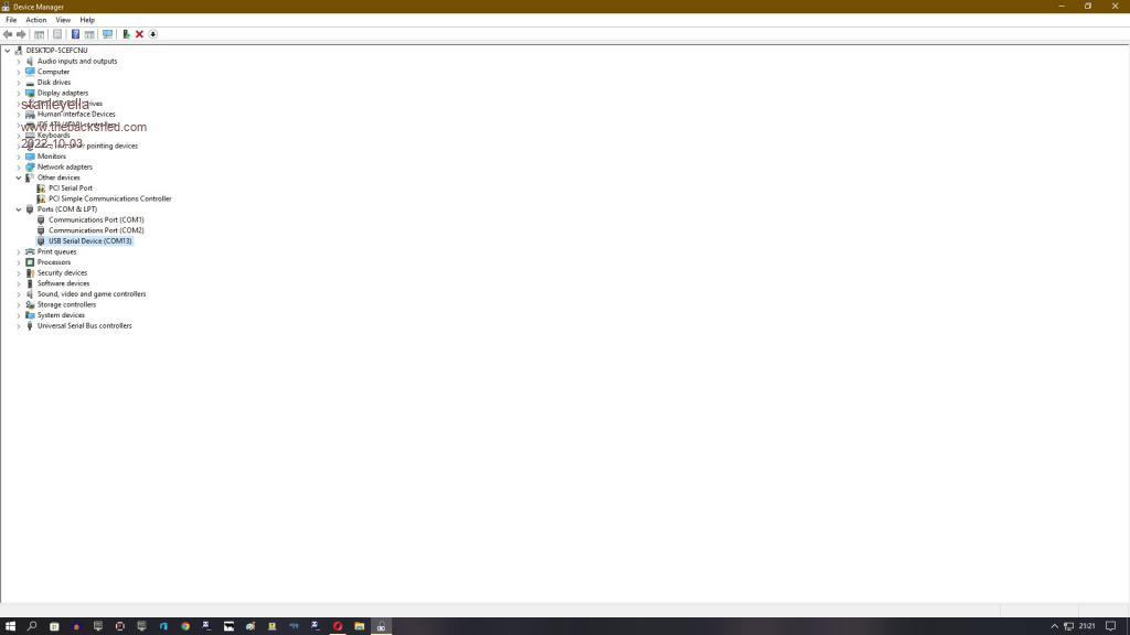

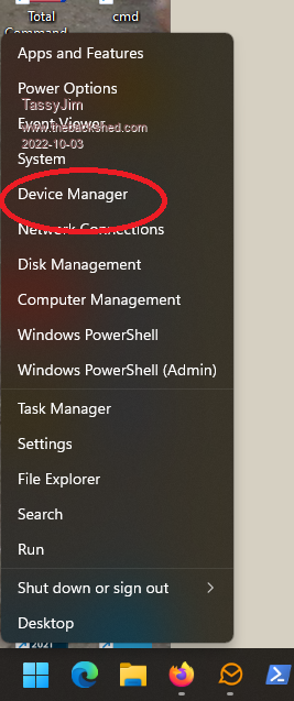

It took me a long time to work out where you were getting the device name 'pico' from.
If you were to dig deeper into it by looking at it's properties you could have found the port number but you were making life difficult for yourself.
Try the 'normal' way:
Right click on the windows menu button (bottom left on your screen)
click on 'Device Manager'
expand the 'ports' line
Your Picomites will appear as USB Serial Device(COM9) where COM9 etc is the port number. Here I have 2 picomites connected on  COM4 and COM9
TeraTerm and MMEdit5 only list connected devices but the device might not be a picomite etc but a modem or Bluetooth etc.
In Putty, you have to enter the port number yourself.
You are fortunate that the picomite doesn't care about the baud rate.
The first think MMEDit sends to the device when you select 'load and run' is control-C
If you used the terminals more instead of relying on MMEdit's 'load and run' you would learn more about how to work with the picomites and any other device you end up playing with.

  Quote  Thanks but do not like the terminal.
Any time you do something from the command line, you are using a terminal.
It could be TeraTerm or MMEdit or if you have a picomiteVGA, it could be the built-in terminal.
The way you are using MMEdit,
It send control-C to get to the command line
It then sends AUTOSAVE (at the command line). to upload the program.
It then sends control-Z to signal the end of the program listing.
It then sends RUN at the command line to run your program
It uses the command line to do anything.
You may have other options set but they all use the command-line just the same as if it's you sitting there typing at your chosen terminal.
You may mot like to use the command line/terminal but you do have to know how to.
If you are having difficulty using control_C to stop your program it might be running in a tight loop.
This is why I recommend that you DON'T use AUTORUN until you are sure that there are few bugs and you know that you can stop the program.

  stanleyella said  Pasted from mmedit to teraterm.
As has been pointed out to you several times before, you have to press F10 or type AUTOLOAD before you paste in your code, and when done, Ctrl-Q to terminate. Then you can RUN or EDIT.

CTL-C *DOES* break into *ANY* running program unless you've got stuck in a very tight loop where no key presses will be seen (that's very unlikely as MMBasic is interpreted so the keyboard is scanned on an interrupt anyway) or you have been messing about turning the BREAK key off, in which case it's your own fault. If you can't get CTL-C to work then you're doing something wrong. Post a *small* piece of code that reliably illustrates the problem then maybe people will be able to help. Just saying "it doesn't work" is a good way to get ignored.
