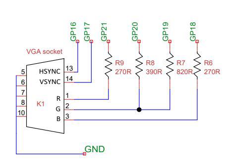

connecting to VGA is not a big deal
If you look at the circuit in Mixtel90s
PicoGame Mini 00 Construction Pack youll get it done
with just 4 Resistors
©Mixtel90
it works

Looks simple for 16 colours, why not in "The manual"?

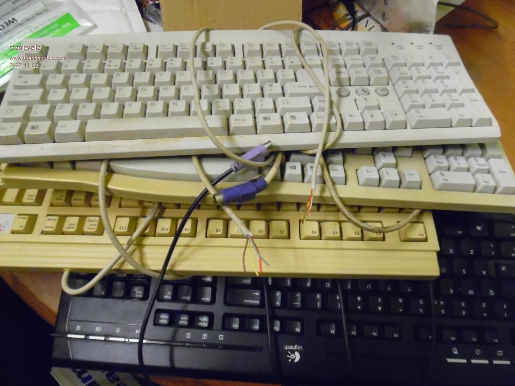

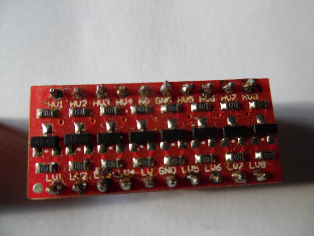

I will try that. I have 8 channel 3.3V to 5V bi direction boards for the key board.
I got 4 ps2 kb , 2 I cut the plugs off. Would they run at 3.3V logic? Power from 3.3V and see.. can not damage picomite that way or use logic level converter, which has 8 channels,  so useful for other devices. I will try tonight to get vga running.

If you are lucky a PS/2 keyboard can be connected directly - but you have to be able to power it from 3V3. Keyboards that need 5V *have* to have a level shifter of some sort as they may contain pullups to 5V which will damage the Pico. Unfortunately you can't tell reliably which keyboards will work without trying them.
A level shifter can be two cheap mosfets and 4 resistors.

I have a few of these bi-directional logic level converters.
Nice for ili lcd with 5V logic like pic/arduino 328p.
