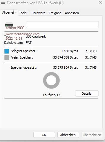

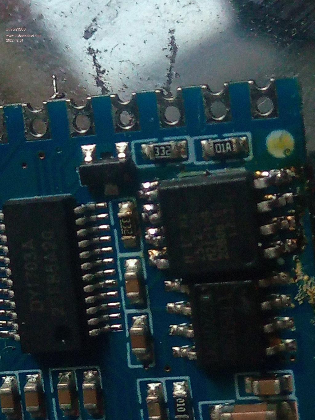

My MX25l25645 SOP8-Flash have arrived.
I successfully swapped the flash to the MX25l25645.

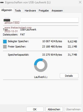

Windows formats it with FAT and correctly shows 32 MB.

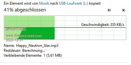

I copied a mp3-file with round 9MB and it also works.
The flash write speed is about 355kB per second.
My conclusion:
.)the MX25l25645 works without problems on the player
.)no problems with the detection in windows
.)changing the flash is no problem for an experienced solderer
