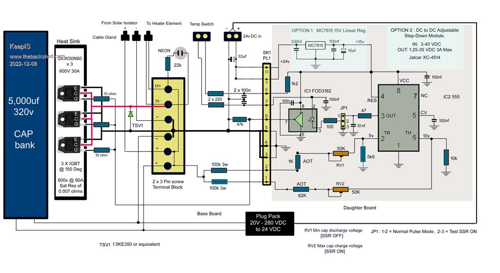

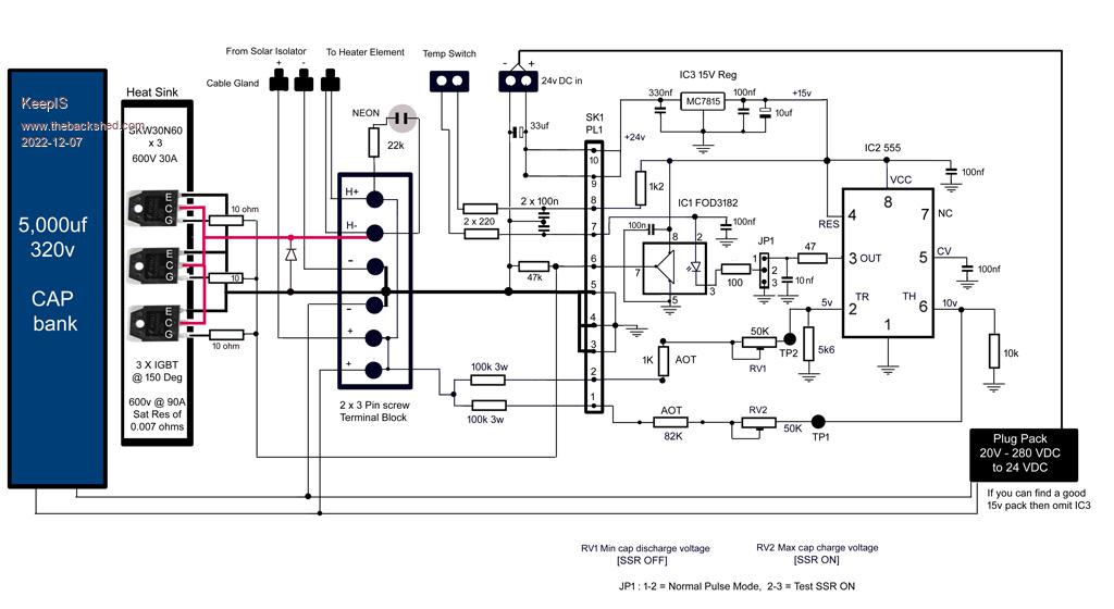

Another stinking hot day in paradise, I moved the HWS controller and Solar Disconnect switch out of the weather and under the pergola, so much nicer for me to finalize some tests.
First off, the FOD3182 High speed MOSFET (or IGBT) gate driver IC. Some may recall the RF oscillation I was encountering with the 555. This morning after the controller relocation, I noticed that the IGBT heatsink (SSR) was getting hot and the FOD3182 IC was stinking hot. Once again the only rational explication was some kind of RF on the switching line from the IC to the SSR gates (again).
Grabbed the CRO and was greeted with a band of RF noise swinging 0 to 15v instead of a PWM square wave??
Turns out that IC1, the Opto coupled Gate driver, has lots of gain and can oscillate under certain conditions, hence that NOTE in the spec sheet requiring a 100nf connected directly across the supply pins of IC1, which I had ready have installed.
The fault occurred ONLY under certain load conditions. I found that IC1 is very particular about the Cathode (pin 3) ground connection location, so I added a 100 ohm in series between Pin 3 and a 10nf to ground then a 47 ohm going to pin 3 of IC2, the NE555, which is, in this case, the comparator controlled output of the 555, this pin pulls the Cathode of the Optocoupler High [off] or Low [on].
I’ve thrown everything at it and it finally appears 100% stable - I really worked it.
In the revised circuit, JP1 sits between the 555 IC2 and the OptoCoupler driver IC1, Pin 3 of both ICs. JP1 allows me to turn the OptoCoupler Driver on and turn the SSR hard on instead of having it Pulse, I use this for testing and comparing power output.

The FOD3182 only requires 10ma drive current for its led, with a forward voltage of max 1.8v.
As your 555 is powered from 15v supply then you need to limit the drive current from pin 3 to 10ma ie 15v-1.8 = 13.2v, so use a resistor near 13k so you don't blow up the Fod3182 with excessive led drive.

Hi thanks for that suggestion, yes, I thought that at first, but I measured it and under 10ma. I think the spec was 10 to 16mA. I actually had a total 1.7k in series, the 100 ohm I added decoupled the earth and it's now happy. I could have fixed it with just moving the earth (tested and verified) but I just didn't feel like making the daughter board a 3rd time, so I just decoupled it.
BTW: Just remeasured, the voltage is 1.4v @ 9.8mA

Would you know the current draw at the 15v line when its running flat out? I have some small, isolated, 15V DC/DC converter modules I could use if suitable.
Also, what type diode is shown above, between IGBT's & terminal block?

The Diode is a Transient voltage suppressor (TVS) something like an 1.5KE350 or equivalent.
Current on the bench supply during testing sat around 10mA to 15mA, when the Optocoupler triggered and the NE555 pulled to ground it indicated around 30mA.
As I only had a 24V Supply, I decided to replaced the LM7815 Linear regulator with a small low costs DC to DC switching regulator board from Jaycar, 3V to 40V input and adjustable output up to 35V @ 3A, runs cooler and very stable, nice bright blue LED so easy to tell 15V DC is running.
EDIT: Updated circuit with parts listed.
     NOTE: The existing HWS temperature switch, if used, MUST be fully isolated from the HWS system Heating element, power cables and frame/earth.

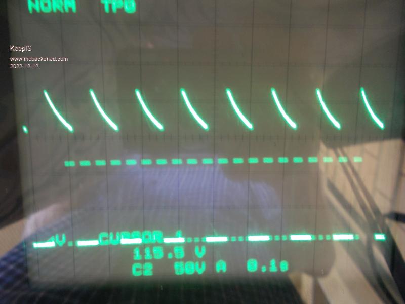

Some interesting finds on the net and a few Scope Waveforms:
There was a post on the previous main topic started by Warpspeed. It was about a YouTube video of what appeared to a similar controller, but no real circuits or other help was forthcoming. A few people attempted to built the unit but had little or no success or help from the video uploader.
I found the video and realized that it's implemented in a different way, more net time revealed it was a supplemental add-on next to the main MPPT controller and used excess panel output when the main system was not under load. Some A/B comparisons were shown on a digital meter readout and, well, not going there!
Then I found another similar device for sale and lots of usage data and savings made over a year or so on, it's in following links.
Makers site
User Review
Some Screen shots:

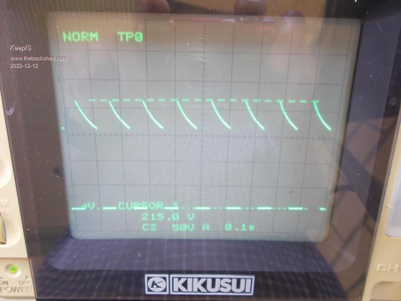

I have adjusted the controller to work around the MPPT of the panels:
The Panel voltage is not dropping much at all, it's a high DC voltage with a small a saw-tooth waveform at the top. The Panels only have to charge the cap up by 50V out of the CAPS 215v charge, so the inrush current is low and does not pull the solar voltage down by much - keeping it around the MPPT level.
The Panels:
The VOC should be 267v but it's only 235v on these old panels.
Max Power is @ 222v, but I've had to reduce it to 215v, again, old panels.

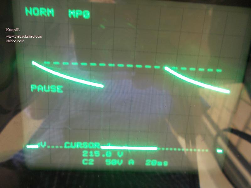

As the Screen shots will show, I'm charging/discharging the cap around 50V between 165v and 215v.

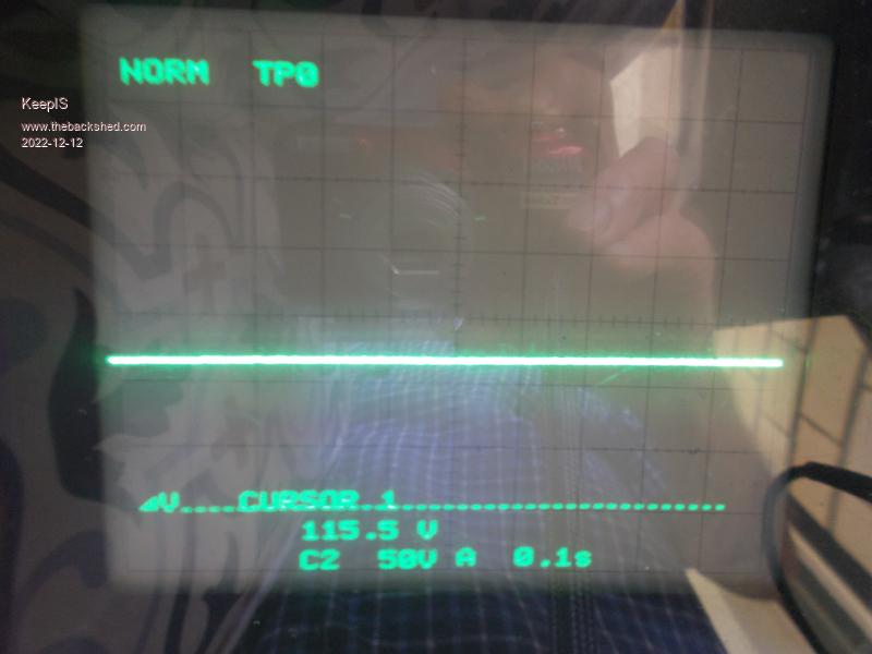

NOTE: The Scope is connected directly across the Heater Element.
The Controller Pulse width is set so that the Pulse decay is in the linear part of the R/C discharge cycle. The saw tooth part is the CAP bank charge / discharge cycle  into the Heating element from the High cutoff point of 215v, down to the low voltage cut off point of 165v, then the cap recharges and the cycle repeats. As conditions change, the charge Pulse width changes constantly as it tracks the solar change. The charge Pulse-width is the bright flat part at the bottom of the waveform.
This shows the 115v voltage across the Element with a direct connection for comparison.
The direct 115 volts (dash line) in comparison to the Pulse voltage swing.
A closer look at the charge/discharge cycle.

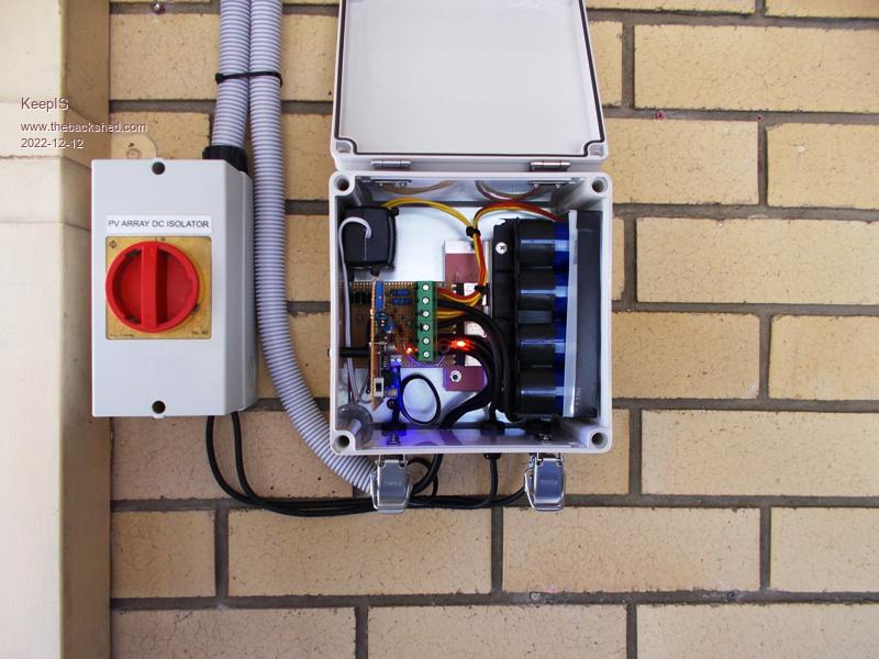

Finally, the Controller flashing away in its new sheltered location, can't miss the flash with the camera as no visible off time between flashes with decent solar, just a flashing brightness change.
This is easy to adjust, I have wired the 2 x 50K 10 turn variable resistors in a way that means turning clockwise will raise the High or Low cutoff voltage, obviously counter CW lowers them. The Top Cut off can be set to the Highest voltage that will allow the Controller to still charge the cap in poor solar conditions. The low cutoff is the harder to set as it's dependent on the element resistance, total Storage capacitance, and panel current/voltage. I've think I've come up with a simple quick way but I just need the time to get a low cost item and test it.

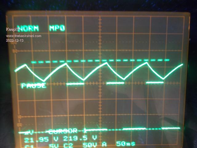

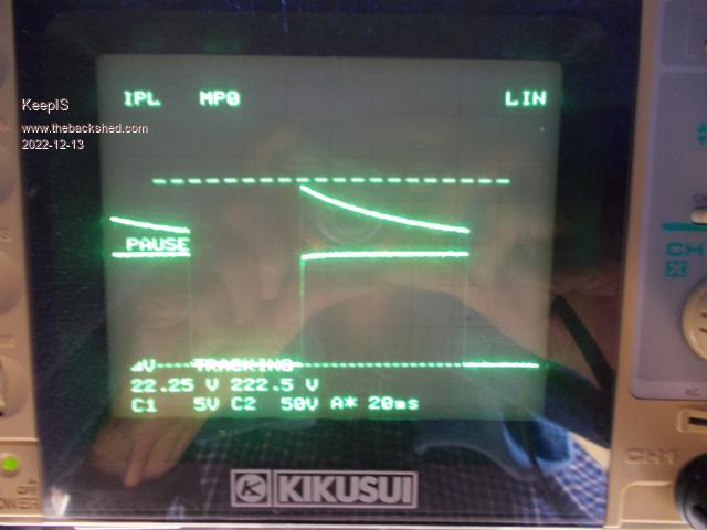

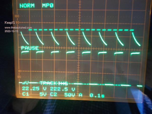

I thought I would finalize the Digital Scope information: I've added a basic description of the waveform for anyone not familiar with a CRO (cathode ray tube oscilloscope) which this digital storage scope that I'm using IS.
I have the Panel and Cap-Bank voltage waveform on CH2 [sawtooth waveform] with the Gate Drive PWM signal [square wave] on channel 1.
Note: The gate drive volts is shown as 21.95v, however it's been referenced to the base line, not the the elevate cursors of CH2, it's actually just under 15v and is measured directly at the base of one of the IGBT devices after the 10 ohm gate resistors.
The leading part of the sawtooth waveform is the charge time, the trailing part is the decay [discharge] time. The waveform is synchronized with the Gate drive.
Zoomed image - Charge cycle is in the middle.

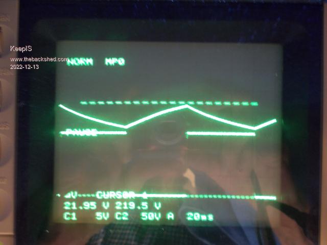

The following is the CAP Discharge across the heating element [CH2], and Gate PWM drive [CH1]
Zoomed image.
FYI, the slight roll off on the leading edge of the PWM Gate drive signal is a result having the PWM probe running without a ground clip. Reason? The Probe for the Element is connected ACROSS the Element connections, so the earth on that probe is effectively connected to the Cap Bank positive [220v], the probe earth clip is connected to the collector of the IGBTs. A slight interaction with the PWM probe but not enough to make me bother to adjust the Probe compensation.

I notice that the Discharge time of the CAPS into the element is varying between 35ms and 55ms. This is controlled by the R/C TC of the Restive Element and CAP bank Capacitance and the HI/LOW voltage trip points of the NE555, so I decided to have a look.
To start with, I eliminated the chance of excessive loss between the Controller and the HWS Heater Element. Measured straight across the Heater terminals in the HWS with the Scope and everything was exactly the same, and the element resistance never changes.
The 555 and driver supply is absolutely rock solid, verified with the CRO. There are ZERO current paths on the control circuit board [daughter board], all current paths are located on the Base Board, and all IGBT positive and Collector switching paths are at the base of those two BIG green connecting blocks.
So I believe that the NE555 trip point is being triggered earlier or later depending on how fast the charge rate [voltage] is traveling as it crosses the trip points, and a higher Panel output power would mean a faster turnaround time after crossing the Low trip point [recharge time], I had noticed the voltage points moving a bit between different tests that I've done over time. Anyway, it's working great so I'm going to leave it be.

Small update: 48 to 240v Inverter. I've been busy scavenging for some big Toriods and reading over the numerous fantastic threads on this forum. For days now, and so much brilliant tech info. Feel like I've built a dozen inverters before I even start. Just started unwinding the three toriods I found -  .
The Solar HWS Controller:
I really need to build a load that reaches equilibrium with a given power and holds it for a period of time, then responds after 20 seconds or so to an increase or decrease in PULSED DC into the load, that will now have to wait, and more old panels are here for HWS, just got to fit them.
For the past week I've have the pulse rate around 14 to 20 pulses a second, in good light, from the available solar output. Pulse DC is now swinging between 190v and 220v, so right up at the MPP area for these panels.
From what I'm seeing over a wide range of low cutoff settings, the Controller pulsing appears to be generating more power even when the solar output is high enough to sustain an average of around 400 watts direct DC to the HWS, this out of a max of 800 watts that I've seen briefly under ideal solar conditions.
The main HW System is still switched off
Still using the solar panel driven small HWS as normal. It's consistently switching off at the hottest thermostat setting by 10.45 AM. We use hot water throughout the day and it switches back on around 3.30pm to 4pm and the NEON stops pulsing around 5.30pm to 6pm.
As others have suggested, keeping it pulsing appears to negate any burning of the thermostat contacts when they open, but I need to verify this 100% over a sustained period to be 100% sure, but logically it should be OK, especially as at higher pulse rates.
