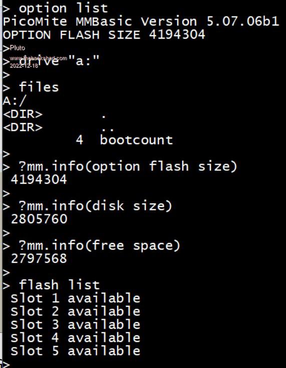

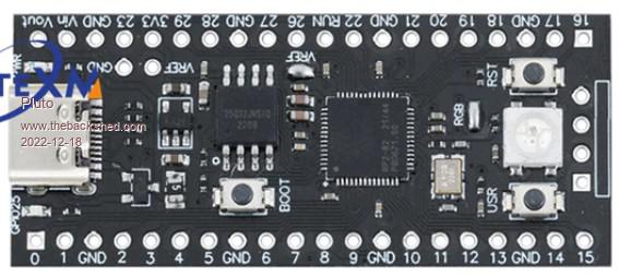

Posted: 07:10pm 17 Dec 2022
Tested on this type:
It has a Winbond 25Q32 flash (4MB). Seems to be OK.

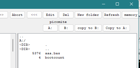

After a quick test with MMEdit,
You can copy files to the flash drive OK using xmodem but can not copy from the flash drive. This is because the FILES listing is formatted differently to the listing from the SDcard. MMCC does not find the file name.
I is simple enough for me to allow for this difference and will update MMEdit 'soon'
Change drives before starting the file-manager to use MMCC with both SD and flash drives.

Posted: 03:15am 18 Dec 2022
Getting there:
Everything seems to work but it gets upset if you try to change to drive A: when you are already on drive A:
I need to add state checking to prevent that sort of thing.
I think I will add a "LOAD" button to transfer selected file to the main program memory ready to RUN
