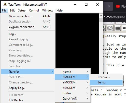

  lew247 said  Really stupid question (possibly)
but HOW do you load an image to the Picomite if you don't have an SD card attached?
Only the usb cable to the computer
I've been through the manual and all I can see is loading it from the SD card or xmodem send but it seems to only send to/from an sdcard
I need to send this file to the picomite  C:\Users\Lewis\Desktop\face.bmp
How can I do it?
I use MMEdit5 but I also have putty, Tera Term and so on
Type on on Picomite :  xmodem r "face.bmp"
then use Xmodem in your Terminal Program (for example TeraTerm) and send the File..
Firmware should be PicoMite MMBasic Version 5.07.07 or higher.
There the Flash is Drive A:
So you have a filesystem without SD Cars

As you use MMEdit, start the control centre (MMCC) and from there start the file manager from the 'mode' menu.
The rest should be reasonably obvious.
You will still be using XMODEM but without the hastle.
Posts: 3885
Posted: 10:29pm 04 Aug 2023
  lew247 said  HOW do you load an image to the Picomite if you don't have an SD card attached?
The PicoMite has a file system in flash (size 688KB), so you don't need an SD card unless you have more files than will fit.
XMODEM R "filename.jpg" works within teraterm. But if you're familiar with MMEdit, it may be easier for you to use that

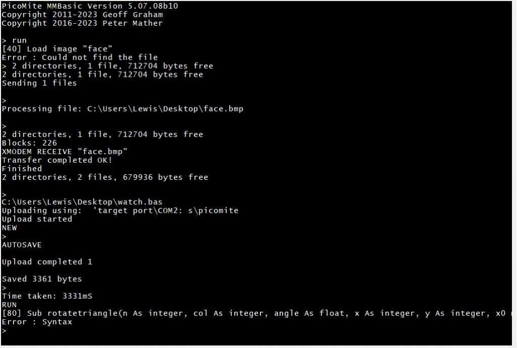

lew247
Joined: 23/12/2015
Posts: 1709
Posted: 06:48am 05 Aug 2023
Peter I'm getting this error:
This is the code

Posts: 4390
Posted: 06:58am 05 Aug 2023
If the load image errors, maybe add .bmp to the name.
Line 80 looks too long.

Posts: 6626
Posted: 08:17am 05 Aug 2023
Line 80 has been split into two lines.
Join them together again and the line will be 182 characters long which is OK but not easy to LIST without setting the display nice and wide.

lew247
Joined: 23/12/2015
Posts: 1709
Posted: 01:10pm 05 Aug 2023
  TassyJim said  Line 80 has been split into two lines.
Thanks Jim, I should have spotted that but didn't
