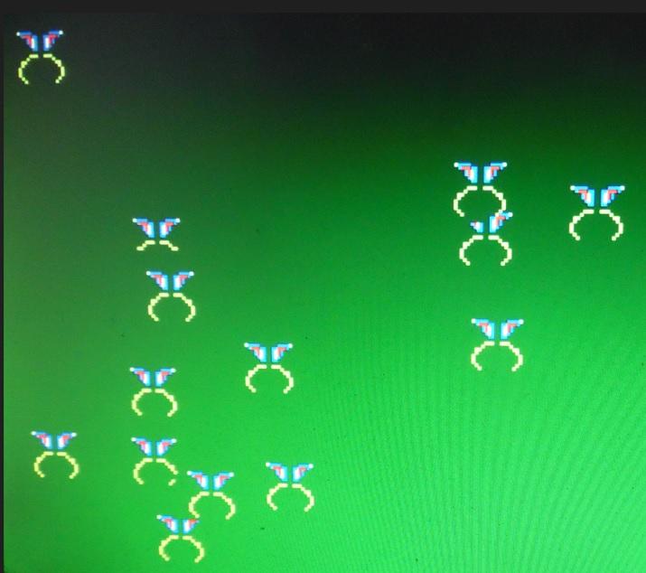

Sprite problem or bug.
I tried a glcd sprite program on vga but sprite read seems not to read a black background.
cls rgb(black)
sprite read 3,10,10,16,16 'reads 16x16 background to blit buffer3
udg1 'draws sprite1 on screen at 10,10
sprite READ 1,10,10,16,16 'reads sprite1 from screen to blit buffer1
pause 10000
sprite WRITE 3,10,10  'erase udg1 but doesn't
pause 10000
udg1 'draws sprite2 on screen at 10,10
sprite read 2,10,10,16,16 'reads sprite2 from screen to blit buffer2
pause 10000
This sprite reads the black back ground... or should,
then it draws sprite1, which it does,
then waits 10 secs,
then it should erase the sprite but doesn't, it waits 20secs and draw sprite 2.
How do I sprite read the background which is cls rgb(black) please? doin my head:)
glad I'm not spock or data :)

You will need to check the latest VGA manual on this point, my memory is a bit hazy.
I think sprites use Black as Transparent so you can overlay a sprite that isn't a simple rectangle on a background image and have the background show through.
So an all black sprite will be invisible on any background.
Edited 2023-02-04 07:53 by phil99

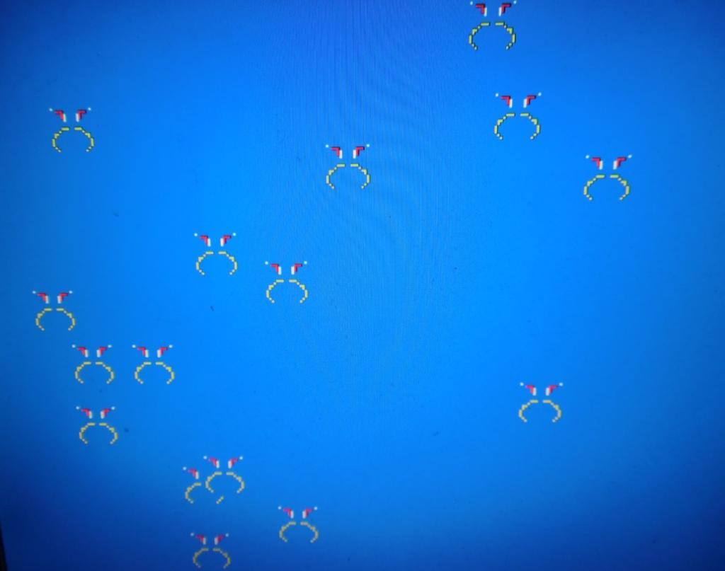

Yes Phil, it seems that sprite read does not read black or sprite write does not write black.
I changed the cls to blue and the prog works even though the sprites are from data and have black pixels.
They were drawn for a black back ground, how to use a black background?
16 16x16 animated sprites, to fast to see.

The darkest non-black colour is dark green, RGB(0,64,0).
Edit.
If that isn't dark enough you could put a 10k pot. in series with the Dark Green pin, GP19 then adjust it to suit. It will also affect any other colours that use dark green such as white so it will be a compromise.
When you run other programs that need normal colours turn the pot back to 0R.
Edited 2023-02-04 09:53 by phil99

Sorry, you can't use a true black background with sprites. Black is always transparent. The frame buffer has space for 307,200 bits. Those are arranged as 640x480x1 (either on or off) or 320x240x4 colour bits. If you want a "transparant" flag then you have to lose one of the colour bits.  Instead, Peter designed it so that 0000 is transparent (and is also black) so that you don't lose one of the other bits (Red, Lt Green, Green, Blue).
Colour in Mode 1 is interesting. :)  Read the section on Tiles. Font 3 is made for the Tiles in Mode 1.
Edited 2023-02-05 08:13 by Mixtel90

To erase a sprite overwrite the with background colour.
eg:-
const dg = rgb(0 , 64, 0) 'Dark Green
BOX x, y, 16, 16 ,, dg, dg
Or make a sprite that is the same colour as the background (not black as that will be transparent).
Read latest VGA manual pages 88 to 90. All about sprites.

Posted: 11:13pm 05 Feb 2023
I take back about box being too slow. It's as fast as sprite write for 16x16 sprite.
Wow!
if frame=0 then'which sprite to draw
 box oldspx(temp),oldspy(temp),16,16,0,bk,1 'erase sprite at last position
 sprite WRITE 1,spx(temp),spy(temp) 'draw sprite1 at new position
else
 sprite WRITE 2,spx(temp),spy(temp) 'draw sprite2 at new position
end if
This is interesting, I got my sprite demo to work on black background and the sprites look brighter. It's very fast. I'm amazed. It's simple but looks ok.
