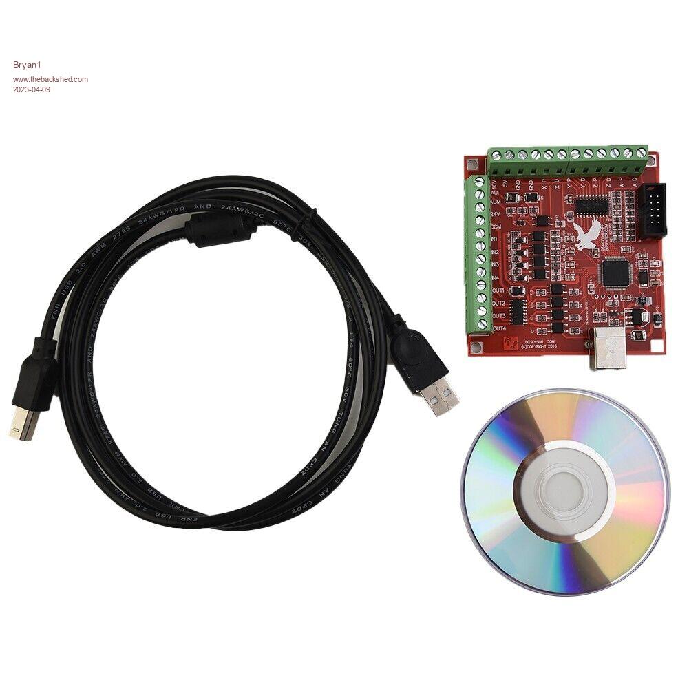

This is the USB controller I got
also got 3 off DM556 micro stepper boards, now as these boards have enable pins and the controller board doesn't I can wire it up to 12 volts and use a toggle switch.
This PCI board should be here later in the week so I'm going to try that first.
Cheers Bryan

Posted: 07:48am 10 Apr 2023
G'Day Guy's,
           Got a fair bit of wiring done with the micro stepper boards and the control board and found the datasheet for those stepper drives where they say for 24 volts a 2K resistor should be put in for the P and D data lines. A search thru my gear didn't find any 2K resistors so I'll have to get some this week.
Anyway as I did have Win7 going I plugged in the control board and sure enough via USB the driver was found and installed
So nearly there for the big test to see if this works and one thing I did find in the help file for this CNCUSB software a direct link to PlanetCNC on the CNCZone web forum. So hopefully this week the first movement of this cnc in well over 10 years.
Cheers Bryan

Hope this goes well for you.
I gave up on that USB controller as electrical interference from the spindle and/or steppers and/or other electrics in the workshop (compressor?) occasionally killed the USB transmission and stalled the cut. Hopefully you won't see the same.

Well for 24 volts that will be coming straight from my shed battery a 10 + year old 24 volt 735AH one so little to know noise from that. now from what I learnt today that controller I bought was first made back in '15 and looking at newer ones which aint much more than I paid for does look to have a heap more features.
One thing I want to setup as the function is there in the software is the camera function and I'll make up a probe so it can scan items and convert it straight to g-code.
