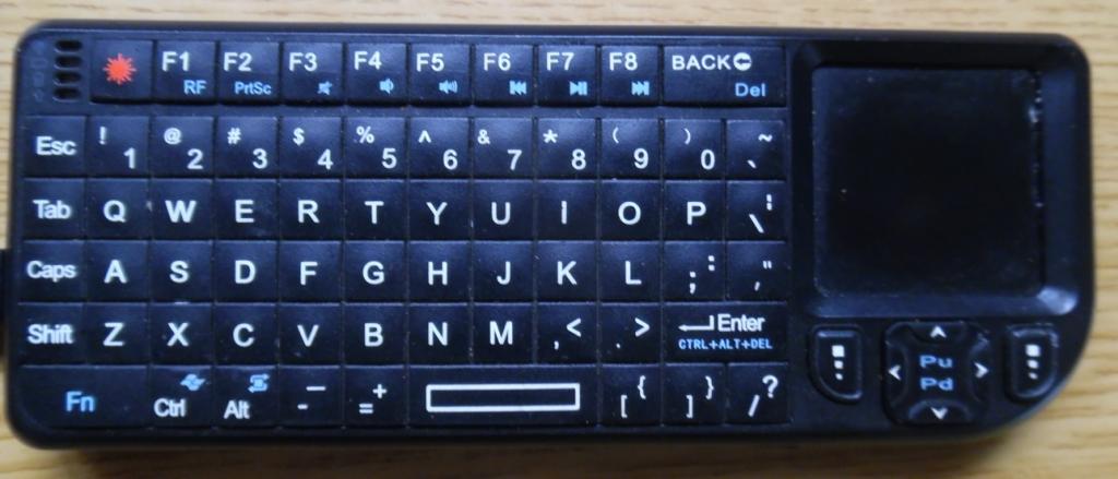

I thought about using the vga keyboard with glcd picomite for buttons cos it works but full size kb, lot of space.

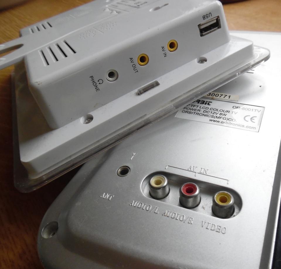

I got a mini usb/wifi cheap fullish kb... with laser pointer but not mmbasic compatible. I'd like a way to convert vga to composite as I got some small screens that only have composite. I'm thinking of mini picomite and vga screen cheap.
I have dvi from raspberry pi to vga converter but not the other way and think some are bogus.

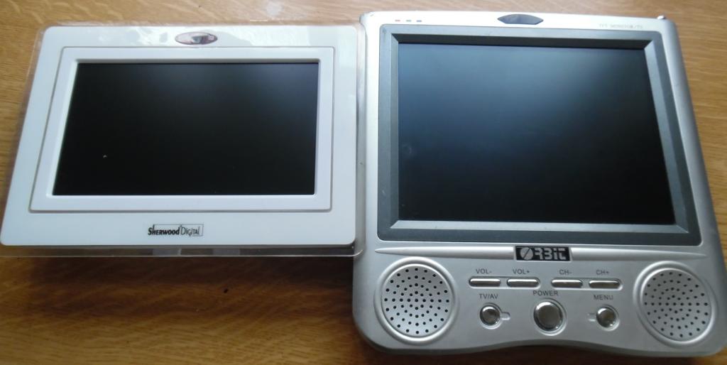

Cheap avi screens from charity shop, one is a meant to be a photo viewer, other an analogue tv.

Wouldn't it be nice to use these cheap mini kbs with touch mouse with mmbasic?

edit- I meant with mmbasic. I searched for circuits to build and lots use chips and youtube saying the cheap adaptors are rubbish so wary. don't want to spend lots as defeats the idea. thinking of hand held mini pico laptop?

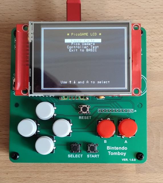

Hi folks,
It still needs some titivating, but courtesy of @bigmik's PCB skills and with a little help from @Turbo46 and others:
Final(?) schematic and gerbers will follow once the kinks have been ironed out.
Edited 2023-06-07 20:01 by thwill

Hi Tom,
Very nice !! And it already plays 2 games !!
Posts: 3891
Posted: 12:09pm 07 Jun 2023
Looking good, Tom--congrats.

Posts: 4412
Posted: 01:23pm 07 Jun 2023
Thanks folks, I think the plaudits go to @bigmik; left to my own devices I would have been another 12-18 months to produce a PCB and even then the layout would not have been good.
  Volhout said  And it already plays 2 games !!
PicoVaders is @Martin H's work, I'm still messing with it to get the best behaviour on the Bintendo.
Porting from the PicoMiteVGA to the Bintendo isn't trivial because the standard PicoMite firmware which the Bintendo runs doesn't have the same sprite support*. I'm hopeful I can implement an approximation of the missing bits as CSUBs, perhaps even by repurposing Peter's code from the PicoMiteVGA.
* Though PicoVaders is simpler as Martin didn't use the sprite support ... it may not have been present when he started writing it.
Edited 2023-06-07 23:25 by thwill
