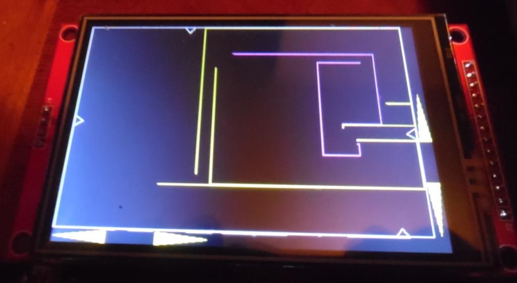

I used a touch screen for the buttons. ps always hated atari joysticks They were hits.
