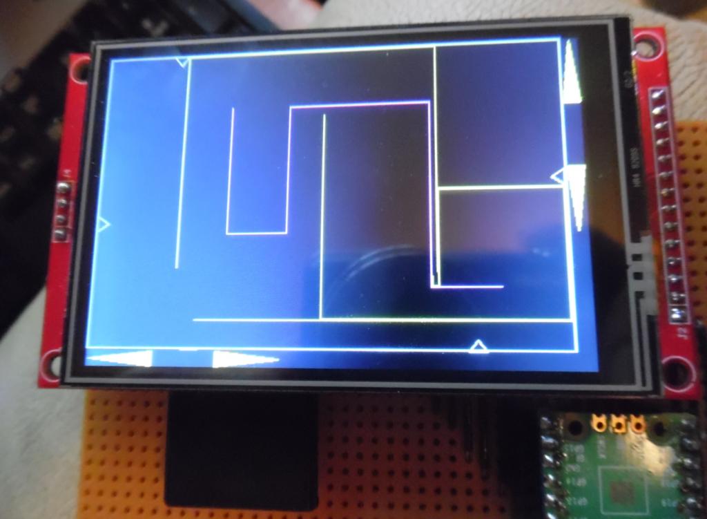

Here's the finished game for ili9488 lcd to demo gui area touched and pixel read and logic that used 75% less code than if then. Hope someone finds it useful.
thanks for the help.
This version has 3 computer opponents.

   tr=TOUCH(REF)
   if tr>0 then
     select case tr
       case 1 'left
         if pdx=0 then pdy=0:pdx=-1
       case 2 'right
         if pdx=0 then pdy=0:pdx=1
       case 3 'up
         if pdy=0 then pdx=0:pdy=-1
       case 4 'down
         if pdy=0 then pdx=0:pdy=1
     end select
   end if
