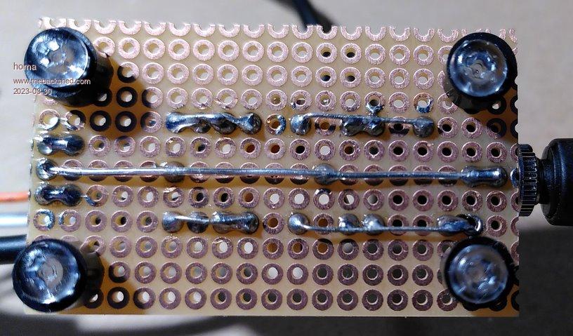

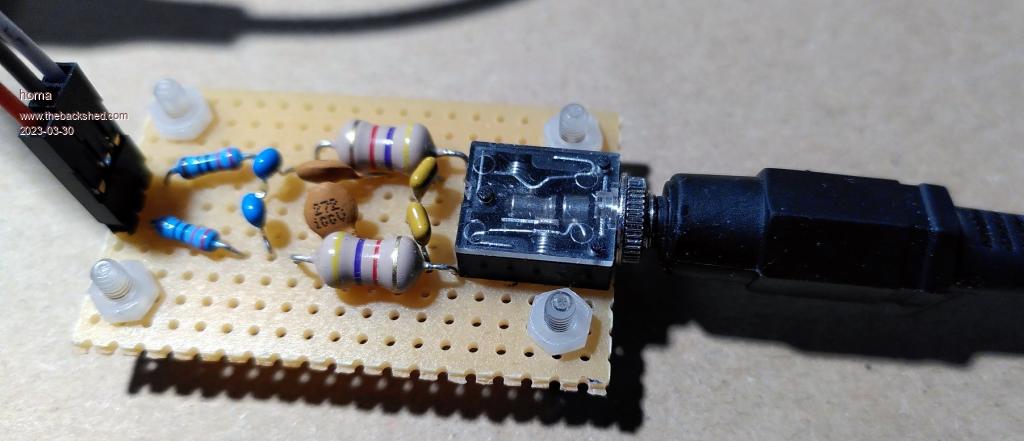

the days I finally had time to build the sound output (low pass filter) for the PicoMite VGA.
Picture 1, 2 and 3:
Question to @Stanleyella:
  stanleyella said
Is the used 3.5 mm stereo socket as in the picture of you to use immediately without modification on the breadboard of you?
On mine (https://www.reichelt.de/klinkeneinbaubuchse-3-5-mm-stereo-ebs-35-p7301.html) I had to clip off pins and drill additional holes beside the pitch :-(

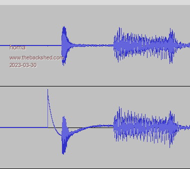

The sound quality is as noted really very good.
However, there are short noise at the beginning of a wav playback. Also, the output on the mixer is very noisy. The gain must remain quite low.
I have here a recording as an example: PlaySoundNoise.zip
Is it possible to improve this behavior?
