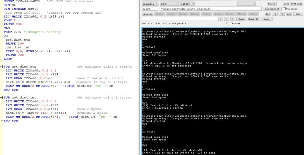

nice phil99 but errors on glcd
Posts: 3349
Posted: 11:47pm 03 May 2023
Down loaded the code from my previous post into a PicoMiteVGA and it runs without problem.

@phil99 - thanks but still errors when pasting into tera term.
I pasted into mmedit previously.

'teraterm errors ----------------------------!
> Const I2Caddr=&H29   'VL53LOX device address
Error : I2CADDR Global variable already declared
> Dim d$
Error : d$ already declared
> Dim integer dst(1)
> 'I2C open 100,1000   'Comment out for System I2C
> I2C write I2Caddr,0,2,&H89,&H1
> Font 5
> Pause 200
> CLS
> use 200
Error : Unknown command
> Loop
Error : LOOP without a matching DO
> Sub get.dist.str                   'Get distance using a string
Error : No matching END declaration
>  I2C write I2Caddr,0,2,0,1
>  I2C write I2Caddr,1,1,&H1E
>  I2C read I2Caddr,0,2,d$           'read 2 character string
>  dist.s% = Str2bin(uint16,d$,BIG)  'convert string to integer
Error : DIST.S is not declared
>  Text MM.HRes/2,MM.VRes/3,"  "+Str$(dist.s%)+"mm  ",cm
> End Sub
Error : Nothing to return to
> Sub get.dist.int                   'Get distance using integers
>  I2C read I2Caddr,0,2,dst()        'read 2 bytes
>  dist.i% = (dst(0)<<8) + dst(1)    'combine 2 bytes
Error : DIST.I is not declared
>  Text MM.HRes/2,MM.VRes*2/3,"  "+Str$(dist.i%)+"mm  ",cm
> End Sub

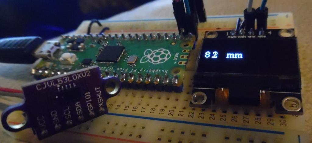

This works for distance% to be used as a var.
option autorun on
OPTION EXPLICIT
OPTION DEFAULT NONE
Dim d$,dist%
Const i2caddr=&H29
I2C write i2caddr,0,2,&H89,&H1
Font 2
Pause 200
CLS
getdistance
Pause 100
Sub getdistance
I2C write i2caddr,0,2,0,1
I2C write i2caddr,1,1,&H1E
I2C read i2caddr,0,2,d$
'text 0,0,(Str$(Str2bin(uint16,d$,BIG),3,0))+" mm "
dist%=(Str2bin(uint16,d$,BIG))
text 0,20,(str$(dist%))+" mm "
End Sub

  Quote  'teraterm errors ----------------------------!
Perhaps AUTOSAVE might have helped

phil99 - your idea works, thanks for help. I'm going to redo my gcbasic robot using mmbasic.
Dim dist%,dst%(1)
Const i2caddr=&H29
Font 2
Pause 200
CLS
getdistance
Pause 100
Sub getdistance
I2C read i2caddr,0,2,dst%()
'dist% = (dst%(0)<<8) + dst%(1)    'combine 2 bytes
dist% = (dst%(0)*256) + dst%(1)    'combine 2 bytes
End Sub
