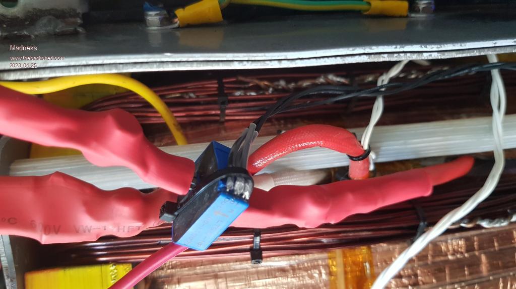

I made up this AC current sensor setup to use as per the hack.

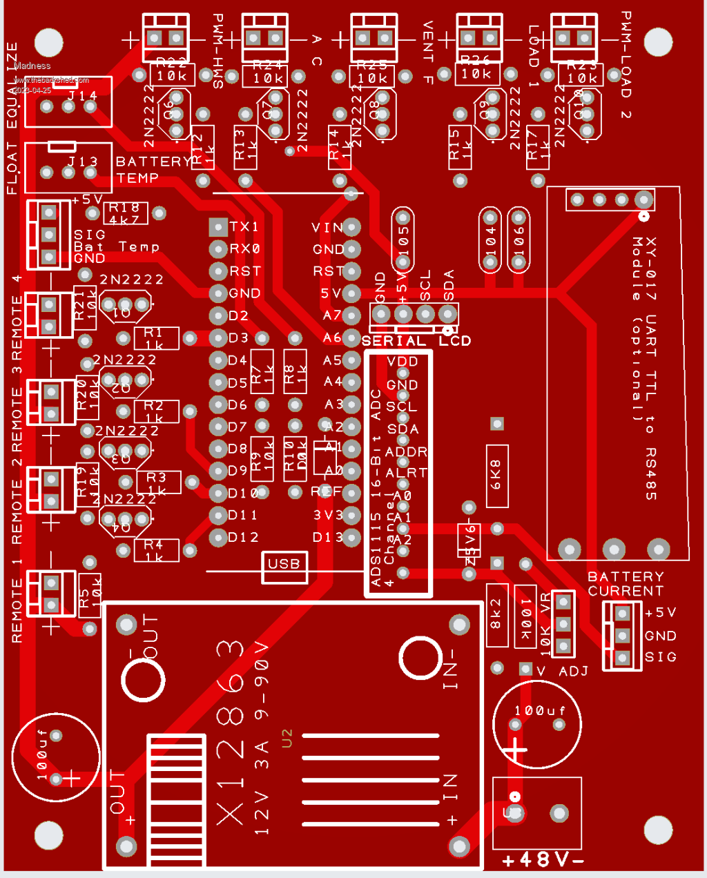

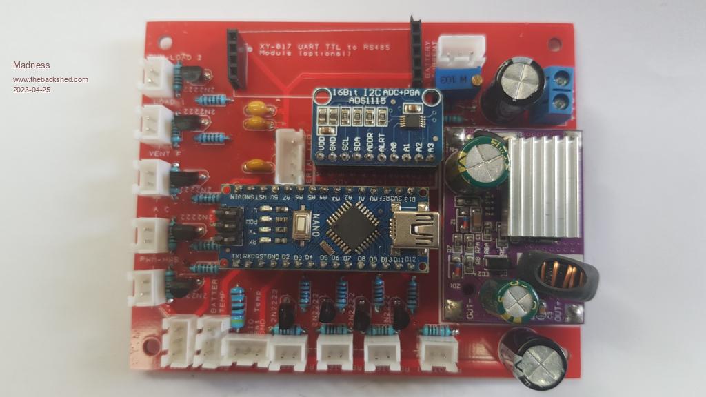

The Nanoverter control card is now fitted to my new inverter. But something is not right, I have no control over the AC voltage in this inverter, it sits on 232 and does not change. the waveform is slightly distorted just after the peak on the bottom side while the top is perfect. It was running perfectly with the Murphy version of Nano1 code, so I am thinking the changes you have just posted will sort that out. I will give that a try tomorrow, I have had enough playing with inverters for one day.

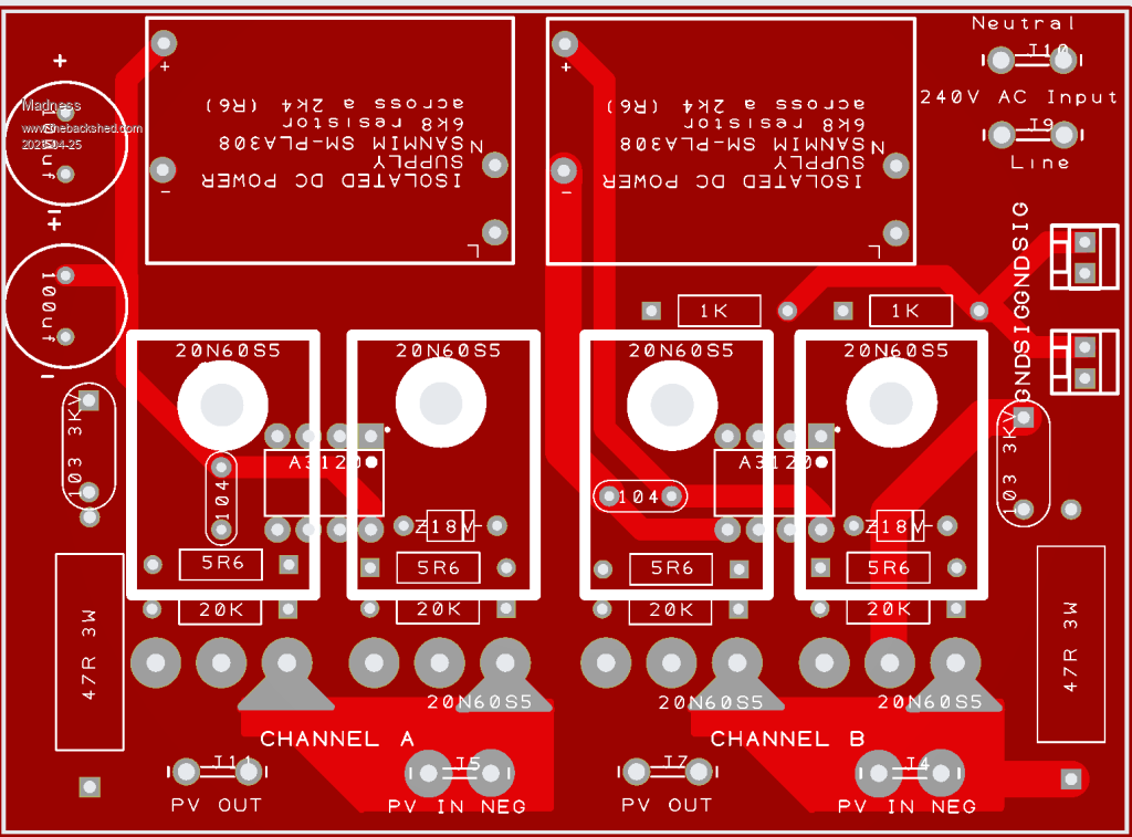

Here is a new GTI regulator that I have made.
This does not have any MOSFETs on the master board, I have moved them to inside the GTI so the high voltage DC and AC all stay sealed up in the GTI.
It just uses a 12V PWM signal from the master to each slave to regulate the DC input within the GTI. I have 3 GTI's running like this, there is a battery current sensor to keep the battery current under the limit I have set. It first turn on my hot water if the current is too high then if needed it will reduce the GTI DC input as well.
Edited 2023-04-25 16:44 by Madness

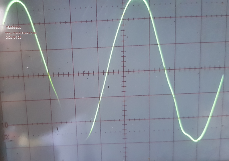

After running so well on the small test rig, single Aerosharp core, 4 FETs in total I can't say the same about my new big inverter. This big inverter is 3 cores and with my big power board with its full 24 FETs.
I was able to increase
u = 30000.0 * sin(t);
to 32000.0 in increments on the small test rig and the output voltage was correct and stable from 22000 right through to 32000. The big inverter is not the same, I could not alter the output voltage at all it went to 370VAC. The only way I could correct this was to reduce u to 24000, then I could adjust the voltage and set it to 230V. It also has this small kink in the waveform.
Due to my phone camera's shutter speed, it missed capturing the full wave, the missing part looks identical to the bottom of the wave to the right.
The GTI refused to connect with this sub-standard sine-wave.
This same inverter runs perfectly with the Murphy version of the Nano1 code, voltage regulation works as it should and the sine-wave is perfect, the only problem is I can't connect a GTI.
Edited 2023-04-26 10:40 by Madness

Besides the number of FETs and the transformer itself, what is different between the test rig and the big inverter?
Madness
Joined: 08/10/2011
Posts: 2498
Posted: 12:48am 26 Apr 2023
  InPhase said  Besides the number of FETs and the transformer itself, what is different between the test rig and the big inverter?
Both have 2 chokes, the test rig has 2 pairs of small Aerosharp cores with 7 turns and about 40 microhenries. The big inverter has 2 large aerosharp cores with 12 turns and 80 microhenries. The same Nanoverter control board is used in both. As I mentioned above this big inverter runs perfectly with the different Nano1 code, so I don't believe it is a hardware issue. The modulation is different, one is Bipolar the other is Unipolar, the Bipolar code is an old version of the code and may have other issues in the code.
InPhase
Joined: 15/12/2020
Posts: 189
Posted: 02:08am 26 Apr 2023
So the 2x Sine code on the test rig runs well and the GTI connects, but the 2 x Sine code on the big inverter has this hiccup in the waveform?
Madness
Joined: 08/10/2011
Posts: 2498
Posted: 02:11am 26 Apr 2023
  InPhase said  So the 2x Sine code on the test rig runs well and the GTI connects, but the 2 x Sine code on the big inverter has this hiccup in the waveform?
Yes, but the sinewave is fine with the Murphy version of the code. I think I detailed all this above.
The 2 different types of modulation are detailed in this video https://www.youtube.com/watch?v=vOtamo-Vpvw
Edited 2023-04-26 12:14 by Madness

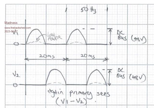

This is the modulation that I am working with here.

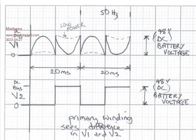

And this is the modulation used in the current Nanoverter code. While this modulation works very well for an inverter that is only providing AC power it is not good with backfeeding from a GTI and I think it would also not work with a generator.
If all goes to plan I will be making new PCBs designs for all to download that will connect to a generator second inverter, sync with it, charge batteries and or run bigger loads. This will need to be plug and play apart from a few settings for current limit etc.

The modulation method does make a difference, the only person I am aware of that has a GTI working but not properly with standard Nanoverter code is Murphys friend.
A GTI will connect no problem using the standard Nanoverter code as long as there is more power being used than what the GTI is producing. In other words, it will not backfeed, to backfeed the inverter needs to act as a rectifier and a boost converter. The Primary windings in our inverter transformers are set up to work at a voltage much lower than the battery voltage. This is so that as our AC loads increase the primary voltage can increase to maintain a constant AC output voltage. What I believe is happening is that the unipolar modulation shown in the bottom diagram above is only connecting battery positive on one half of the sine wave and then only battery negative on the other half of the sine wave. Bipolar modulation connects both positive and negative at the same time, this is similar but not quite the same as the EG8010 modulation. If you watch the video I have linked above it goes into a lot of detail about the 2 types of modulation.
So why not just use the EG8010? That is because we can not sync the EG8010 with a generator and this is why I am experimenting to find a way that I can sync a generator and back charge with it. Another possibility is getting the Nanoverter to use the same modulation as the EG8010 but I don't have code for that at present.

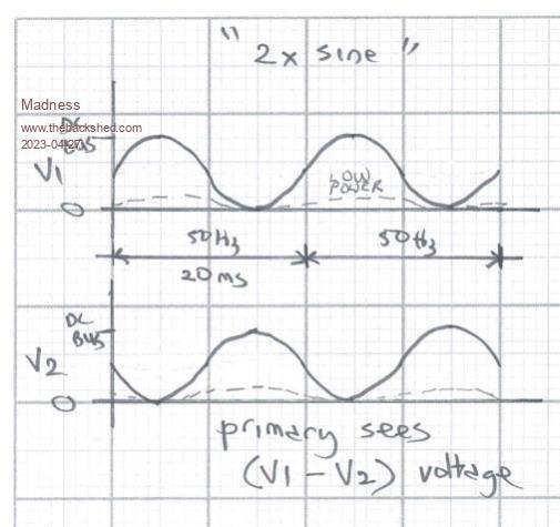

poida
Joined: 02/02/2017
Posts: 1510
Posted: 12:28am 27 Apr 2023
Madness:
just a detail on the 2x Sine modulation that needs to be cleared up.
In the above diagram I show incorrect "low power" voltage traces.
The incorrect trace has them close to zero DC volts.
The CORRECT trace should have the voltages close to 1/2 DC supply volts
with the small amplitude 50Hz deviating from that mid point location.
It results in the same voltage difference (V1 - V2)
With zero modulation amplitude, that is, at the start of the soft start
or the end of the soft stop, both V1 and V2 will be 1/2 DC Volts.
I just wanted to correct that error now, since it looks like
more interest in the 2x Sine modulation is happening.
Madness
Joined: 08/10/2011
Posts: 2498
Posted: 12:34am 27 Apr 2023
