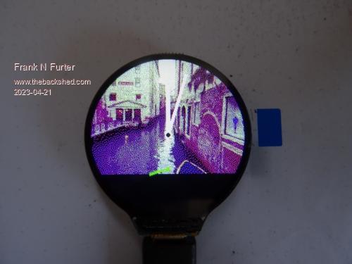

for me, this behavior is not a problem - I just wanted to draw attention to it...
But..., I still haven't managed to get a good picture! Even if I edit it with Martins ditherer (Martin, THANKS for the link to the online ditherer) it doesn't look very good when I load it from your program and it looks different when I load it directly from the console.
Can you really not tell me how to convert an image properly? All my attempts have been unsatisfactory. What tools did you use for this?
Frank

I think you are expecting too much. The framebuffer concept was designed for games and graphics where the user selects one of the 16 available colours. From what I can remember I took an image of a watch face and converted it to two colour (black and white) and then changed everything black to brown.
I use a very old copy of PaintShopPro V7 for image editing

You'll not get photo quality images with 16 colours, Frank. Dithering helps, but that's the best you'll get. You can't even get a really fine dither, that would really help, because of the limitations of the display's dot pitch. Everything that is displayed via the framebuffer has this problem, no matter what it is.
If you can load a picture directly into the display that's different. You can then make use of the full colour resolution that the display is capable of. You can't do anything with the image though. As soon as you try the framebuffer gets involved and you are back to 16 colours.
Some image programs will let you do colour reduction. You tell them how many colours are available and they will pick the closest. Sorry, I can't suggest one. I have a feeling that GIMP will do it. Probably Photoshop too.

There are many different versions of jpg and it looks like the jpg routines used in Pico-MMBasic don't like the version you have.
If you are using Windows, load the jpg in Paint and simply save it with a different name.
The file will be larger but it does now load (on my pico)
JPG is NOT a good choice for dithered images. You really should be trying BMP but I still think you will be disappointed.
I use Graphic Workshop (not free) for image manipulation.

Thank you very much for your efforts! Silly question: The color table is set in MMBASIC? Or is it in the image information?
@Mick:
You are right! But what bothered me the most were the wrong colors...
@Jim:
Thanks for the hint with the BMPs and PAINT. I have now been able to create an acceptable image using Martin's ditherer and Volhout's color table and then convert the PNG to a 4-bit BMP using PAINT. The result is acceptable.

Some of it still applies though. When you put graphics or a picture into  the frame buffer it writes 4-bit colour values. (2 per tile in Mode 1 or 1 per pixel in Mode 2). There isn't enough memory available for a frame buffer big enough to handle more bits. That's why, when any picture is loaded into the frame buffer it is reduced to 16 colours.
Squirting the picture data over SPI directly to the display doesn't have that problem.

The bmp defines the colours that the picture wants
MMbasic then maps those on to the colours available by shifting red and blue 7 places right and green six places right to give RGB121.
There even happens with a colour LCD display. For example the ILI341 is RGB565 so MMBasic shifts the blue and red colours in the bmp 3 places right and the green 2 places right
In the case of a framebuffer and this display
you lose colour loading the full colour RGB888 bmp to the RGB565 display and then again saving the display to a RGB121 framebuffer
See the VGA manual for details of the 16 colours in RGB121

One last question, do you have an explanation for why this image (dithered in 16 colors with Volhout's table and saved with Paint as a 4 bit BMP) looks different from the console with LOAD IMAGE than it does when loaded into the framebuffer by your program?
D.zip
It seems somehow brighter and coarser...
