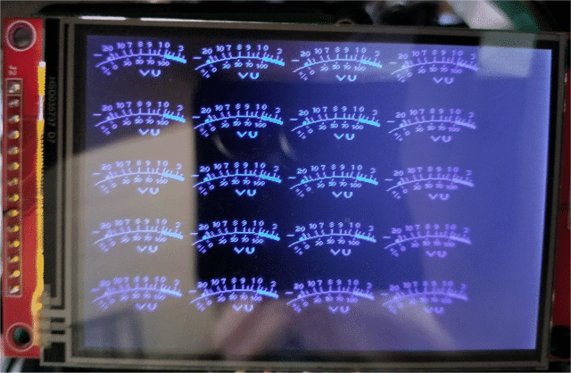

I have juast tried using the BLIT and all I get is white space on BLIT WRITE
Do I need to have MISO Connected??
Edited 2023-04-23 01:48 by asknik2022
Posts: 3885
Posted: 04:05pm 22 Apr 2023
  asknik2022 said  I have juast tried using the BLIT and all I get is white space on BLIT WRITE
You need MISO for BLIT READ, but BLIT LOAD and BLIT WRITE will work without MISO.
Please post your code.

I have now connected MISO and still white space only
How can I use blit load if I dont have sdcard??

Posts: 9187
Posted: 04:53pm 22 Apr 2023
BLIT works with memory buffers, not files. You have to load your image from a file first then BLIT READ it from the screen into a buffer. After that you can keep BLIT WRITEing it back to the screen.
There is a way to read from a file directly into a memory buffer, but I don't know if your image is ok for that.
Posts: 3885
Posted: 04:54pm 22 Apr 2023
  asknik2022 said  I have now connected MISO and still white space only
Picomite has a flash file system built in.
Still need to see your code.

here is the code.
The BLIT co-ords are just testing

@asknik2022 your code works perfectly on my LCD. The blue VU sprite can be quickly "blitted" to anywhere on the screen.
So it seems you are still not able to read back pixels from the screen.
@vegipete's "fontified" version also works perfectly.

Thanks for the code. It works for me. Here it is on a ILI9488, BLITted 20 times. I replaced your BLIT READ and BLIT WRITE with this:
Blit read 1,0,0,100,60
Pause 1000
For i=0 To 3
 For j=0 To 4
   Blit write 1,i*100,j*60
 Next j
Next i
End

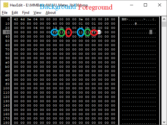

The BMP format supports 24 bit background and foreground colours for 1 bit / pixel images. Most viewers, including MMBasic will display them correctly however most editors only allow black and white.
You can use a hex editor to change the relevant bytes to get any colours.
Hex Byte numbers (starting from &H00)
              Blue     Green     Red
Background      36       37       38
Foreground      3A       3B       3C
Values can be 00 to FF
Edited 2023-04-24 11:25 by phil99
