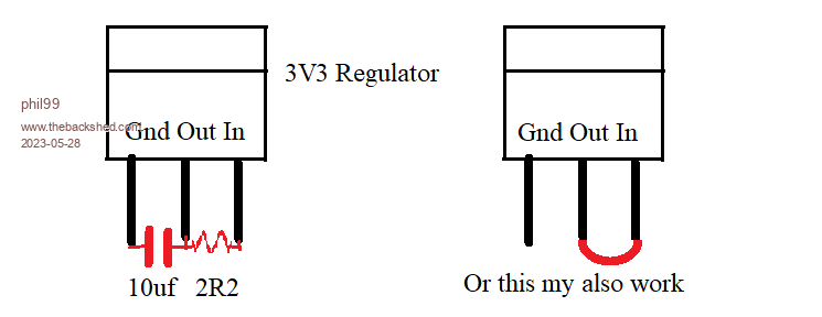

seems very cool. i have such sd card adapters...
i do not understand the foto (i tried to zoom). the capacitor is between wich points? same for the resistor.
can i use the "normal" pins for ground and + from the sd card board after adding capacitor and resisitor?
can you create a symbolic explanation or picture?

Posts: 3349
Posted: 08:29am 28 May 2023
Having 5V on the Pico pins is risky. Bypassing the regulator allows it to be powered from 3V3. The added components filter the supply to the SD card but aren't always needed.
Do NOT use 5V with this modification It will destroy the SD card.
Use 3V3 supply only.

hi phil99. thank you so much. now - with 3.3v - i feel more secure.
