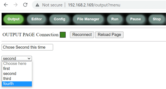

  Mixtel90 said  Yay! Got it running now!
Great +++
  Quote  For I = 1 to 5
Print I
Next I
End
appears to do nothing at all
PRINT goes to the serial terminal (which you may not have if the ESP32 is plugged into a phone charger and not your PC, and you don't have a connection from the serial pins to a usb/serial module on your PC). WLOG goes to the browser window log pane. Analogous with the PicoMite where TEXT goes to the LCD (for instance), and PRINT goes to the Teraterm terminal.
There is also a third output option--build and present a web page which will appear in your browser on the OUTPUT page.
Edited 2023-06-04 22:44 by lizby

Here's a simple menu example based on a list box, after I clicked on the list box and chose "second", got a response, and clicked again on the list box to make another choice.
' Simple listbox internal menu; annex menu example
cls
options$ = "first,second,third,fourth"   'comma-delimited list of menu options which correspond to same-name subroutine branches
choice$ = ""                                         'variable to hold the menu selection
message$ = ""                                     'empty variable for displaying selection confirmation message
a$ = textbox$(message$) + "
a$ = a$ + listbox$(choice$,options$) + "
html a$
onhtmlchange chosen
wlog "waiting"
wait
chosen:
refresh
gosub choice$
return
first:
message$ = "First was chosen"
refresh
return
second:
message$ = "Chose Second this time"
refresh
return
third:
message$ = "Not first or second..."
refresh
return
fourth:
message$ = "Oh no, Last again"
refresh
return
Edited 2023-06-04 23:07 by lizby
