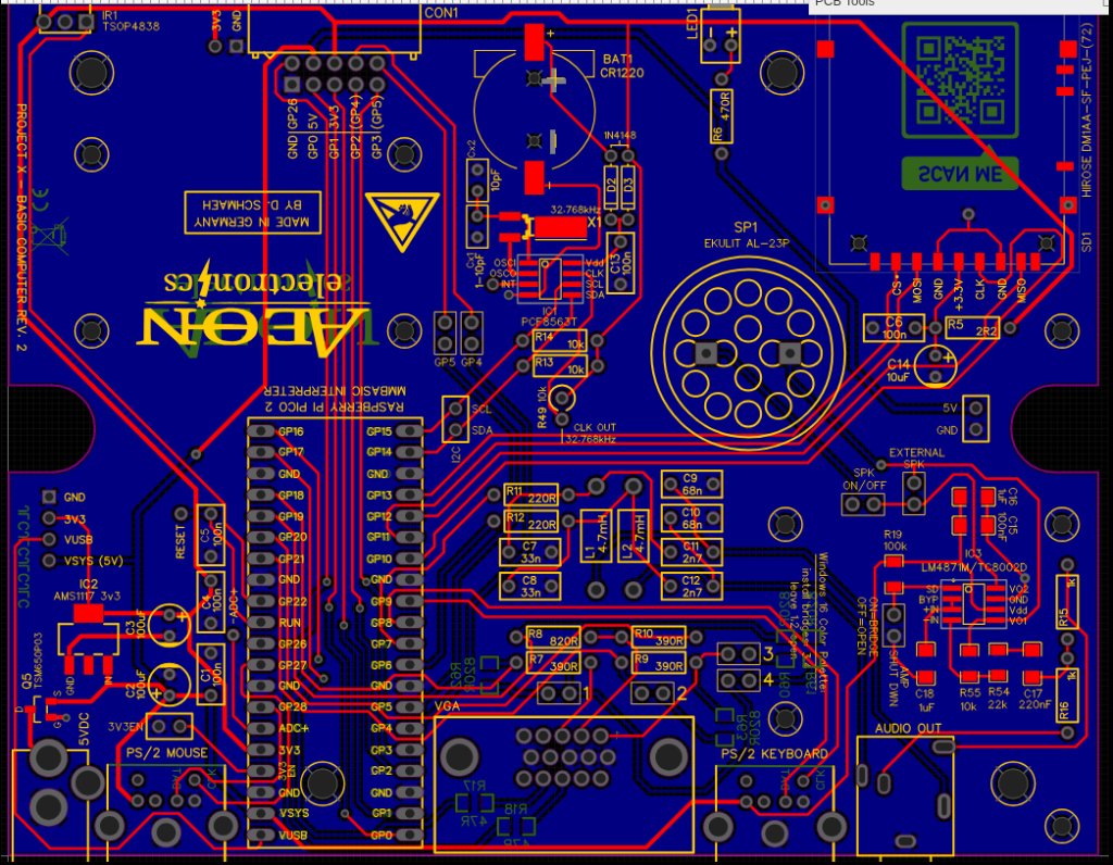

pico                           VGA
R ------------ 390 -----------+--R
Gmsb --------- 390 --------+-----G
B ------------ 390 -----+--------B
         +--- 820 -----+  |  |
Glsb -----+--- 820 --------+  |
         +--- 820 -----------+
Can you please point me to a win 95 palette? If I google it, there a a lot of different and I can't find the correct RGB values. I am sure the original Win 95 pallet is also better than the default PicoMiteVGA, but I will try it! The reason I think even the Win95 colour-pallet is better, is because there are more GREY shades (if I see the correct one).. The main problem with the PicoMite default pallet is the magenta dominance.

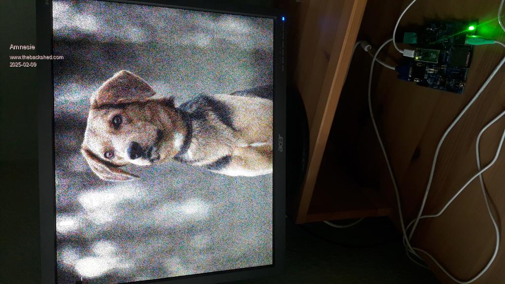

Volhout,

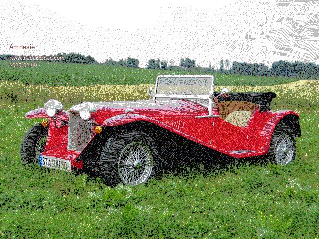

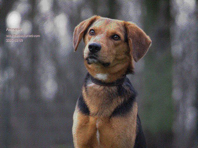

the Windows 16 color palette is great and in my opinion way better than the default PicoMite, see for yourself:
The following pictures are dithered with original Windows 16 colour palette and scaled to fir the PicoMiteVGA max resolution in Mode 3
For me it looks amazing and not that magenta dominance.
But the question (@ Volhout) is: does your resistor network, which you posted earlier, work for this (win 16 colour) palette? If so, I will definitely give it a try. I don't really understand what you mean with:
  Quote  All that conversion work has to be re-written. And it is not as simple as the current conversion (stripping bits).
Hm.. I am just a bit confused, because you initially wrote that with your resistor network it is easy to adapt?! I don't care if the colour-names are not the same, for example if I print a text and I do use "rgb(red)" and with this new palette there is no "red" behind this word but (for example blue)... This is not a problem...
I added again the original pictures in archive, since the forum software compresses them:

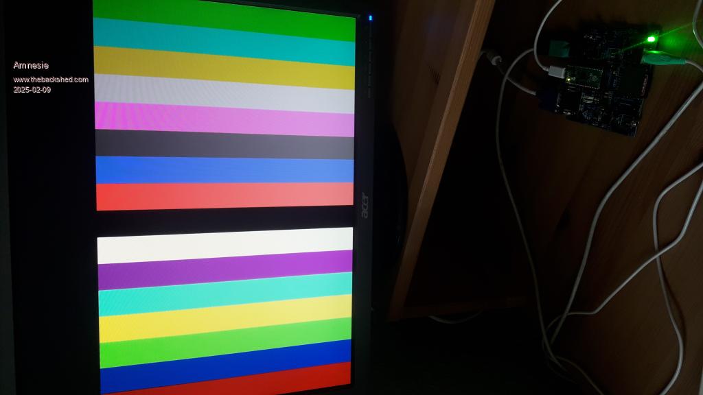

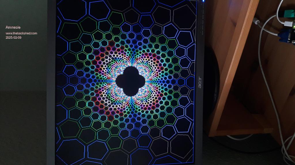

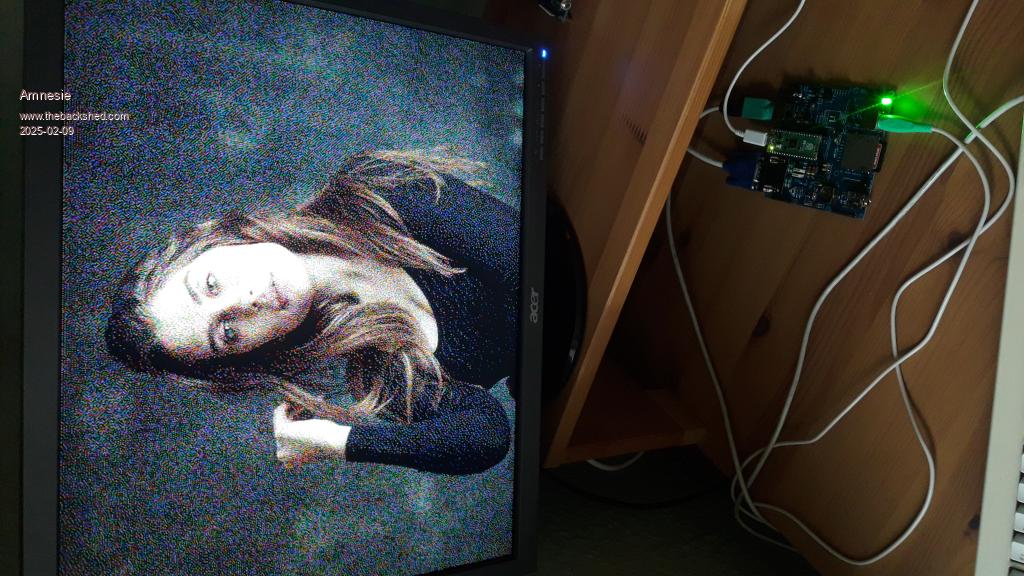

@ Volhout

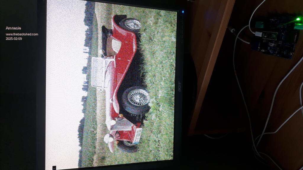

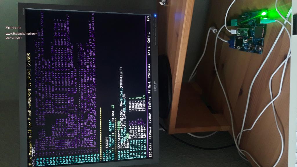

I just soldered your resistor network together & it works perfect, in fact I like it so much I will design a switchable option on my PCB to choose between default and windows 16 color palette! Thank you!
Here are some real pictures, as you can see: even in the editor one can see the colors perfectly! I love the option of having grey!
This was really easy to solder. just adding two more resistors and changing two values.

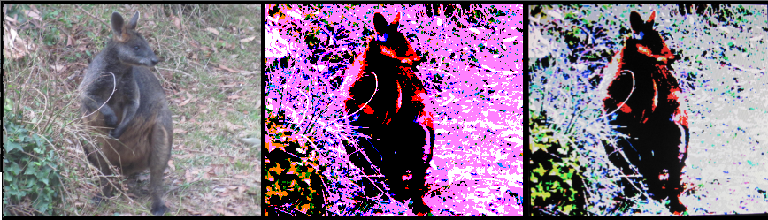

A colour converter program for MMB4W for images with that palette.
It extracts the Intensity value from the image and puts it in the green LSB of a RGB(1,2,1) version of the image for the Pico 121 codec to display through the RGIB resistor network.
It's a rough as guts but it shows what to do in a proper program. Runs on MMB4W.

Original Wallaby image,  After processing on MMB4W, Photo of PicoVGA monitor
Edit. Just noticed the monitor pic was from before I found red and blue are transposed in Pixel() in MMB4W. It now looks a bit better than that, a slightly darker version of the pic on page 1.
As Peter said HDMI will give a better result.
Edited 2025-02-11 10:28 by phil99

I already designed my PCB to allow switching between default & win 16 colour. It is just a "nice to have", especially for my applications.
You created a different resistor network (schottky etc.) than Volhout. But for my eyes Volhouts resistor network works just perfect - can you tell me if there is a problem with it when it comes to voltages? Is it "unsafe", so that I have to redesign my PCB? Or is your version just a hint more accurate?
