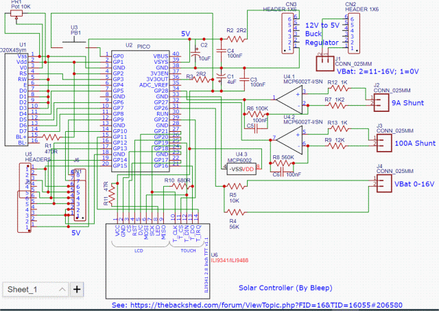

Ok, 1K resistors have been placed in those spots.
Bleep
Joined: 09/01/2022
Posts: 868
Posted: 04:05pm 04 Jul 2023
I also just remembered that I added two small 100nF capacitors, one across the 100K and the other across the 560K resistors on the OpAmps, again to get rid of ripple & interface, if you want to make your diagram completely correct.
Regards Kevin
Posts: 3886
Posted: 04:58pm 04 Jul 2023
  Bleep said  I added two small 100nF capacitors, one across the 100K and the other across the 560K resistors on the OpAmps
Thanks, Kevin. I've added those.

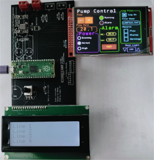

Posted: 12:25pm 21 Jul 2023
Just a tease. I'm not close to hooking up any relays or inputs: 20x4 LCD with ILI9488 running Geoff's guidemo.bas altered for 480x320 LCD.
Many thanks to Kevin. It's been fun just getting to this point.
There will be a V2 of the PCB--I omitted 0V for the backlight on the 20x4, and Kevin's last suggestions didn't make it to the PCB (though I will alter this board to accomodate them).

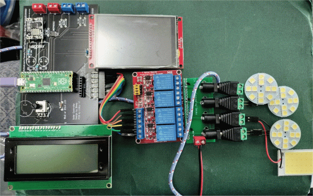

Posts: 3886
Posted: 11:11am 24 Jul 2023
I agree--Kevin's project is fun and interesting.
If I get it fully implemented, my use will also be different from his. Unfortunately, I don't have two-tiered electricity costs, and I think my fridge and freezer draw too much current. I have 200 watts of solar, with the possibility of adding more, and some 18650 12V and 24V battery packs to play with. It's just a learning experience for me.
Here's the PCB with a 4-relay module added (and working--12 Volts only):
The 8-pin header above the connector to the relay uses the same data pins plus two more, so it could connect to a 6-relay module. It could also have an RJ45 adaptor plugged into it to connect to a remote relay module through an ethernet cable. That's what I would use if I were connecting mains. I have an RJ45 adaptor to relay-module PCB.
I'm still waiting for some resistors to finish (and time).
