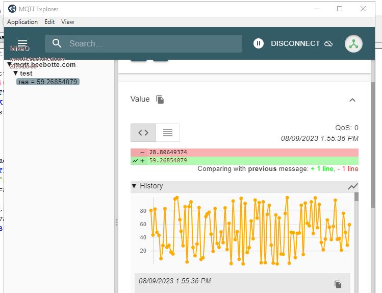

MikeO
Joined: 11/09/2011
Posts: 275
Posted: 04:01am 09 Aug 2023
@matherp
Hi I have found this will work, I have not been able to get the dashboard within Beebotte to work as yet (not sure I need it anyway).
Would prefer to use my HiveMQ but its needs ssl and cert to work, so for the moment beebotte is ok.
'beebotte test post
WEB mqtt close
pause 100
WEB MQTT Connect "mqtt.beebotte.com",1883, ,"channel_token","channel_token"
SetTick 5000,mymqtt
Dim test$
Sub mymqtt
test$=Time$
Print "sende:";test$,
value$=str$(rnd()*100)
WEB mqtt publish "test/res",value$,1,1
Print value$
End Sub
