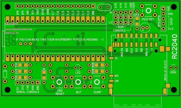

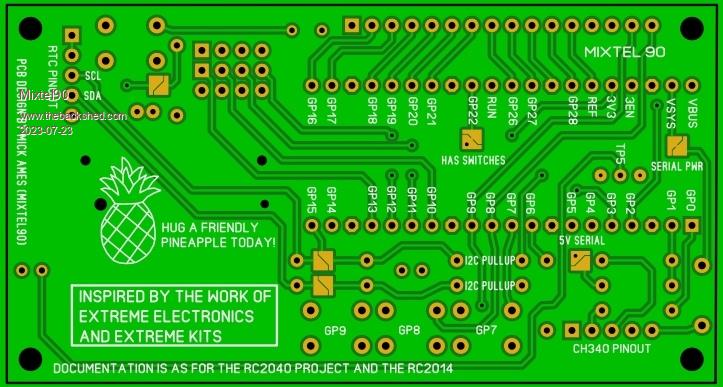

Posts: 9031
Posted: 02:18pm 22 Jul 2023
Based on the RP2040 circuit. Facilities identical except:
PCB can accept either surface mount or through hole Pico.
For resistors you can use through-hole, or there are size R1206 pads for SMD.
5V supply fron USB-C (VSYS - original used VBUS) or serial terminal (via a diode). The latter supply can be disconnected via a blob link.
GPIO connector extended to include GP8 (BUT) and GP9 (DUMP) so that these will be accessible for PS/2 keyboard if a PicoMite is fitted.
The serial terminal pins have been rearranged. If you fit a female socket then a CH340 can be plugged straight in.
microSD card socket changed to standard SD for easier soldering. The board has been designed to take the usual 9-pin Hirose socket (from RS) or a cheaper 11-pin Chinese one from ebay, but the latter has not been verified yet.
Supply filter added for SDcard.
Capacitor added on reet button.
Red LED added for DSK (via TP5). If this is fitted it replaces the green one on the Pico.
GP14/GP15 were allocated to a PC speaker. Added 100R resistors in series with each to protect the Pico's outputs.
Audio socket now expanded to same connections as tiny RTC module,(for a PicoMite) using GP14/GP15 as I2C. 3V3 has to be enabled via a solder blob for safety.
100R resistors can be linked out via solder blobs and pullups added for I2C.
Has a large, friendly pineapple on the back. (Because I can. :) )
One of the main reasons for these mods is to make the PCB multi-purpose. If you install a standard PicoMite it can be used as a stand-alone module with SD card, 11 GPIO (incluuding the ADC ports), serial terminal, RTC and four GP pins that can be used as links or IO. PCB is 90mm x 48mm so it's reasonably compact.Because of the arrangement it would probably be very easy to make a couple of stacking PCBs, one with VGA (all the signals are on the GPIO connector) and the other with IO expansion via I2C and, possibly, a second PicoMite..
RC2040 Gerber.zip
Edited 2023-07-23 00:24 by Mixtel90
Posts: 3856
Posted: 04:02pm 22 Jul 2023
Ordered--if for no other reason than that they're practically free: $2 for 5 from JLCPCB, $1.44 for shipping to Canada; $.50 for Paypal--less than 80 cents a board.
(Thanks, Mick. I put in a lot of time with CP/M starting with my assembled-from-S100-boards system in 1979--though I'm not really sure it's an experience I want to revisit.)
