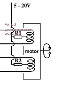

I think you stepper motor is a 5V device. You can (at cost of heat) speed it up (so it may be able to do the 5ms pause) when you connect it to a higher voltage.
But to prevent the windings burn out, you have to limit the current the the maximum the motor can handle. This is often performed by connecting the motor via a resistor.
The resistor must have the right value for maximum speed gain, and minimum heat in the motor.
P.S. some motor drivers use PWM to emulate the resistor in a loss-less configuration.
P.P.S. if you vary the PAUSE time you may be able to achieve higher speeds. Start slow (PAUSE=20, then 18,, then 16, then 14 etc...) and at every step (STP value) make the PAUSE shorter until the motor stops advancing. You may find a value that is better than 10 for maximum speed. Each time you reverse, or start rotation, follow that sequence.
