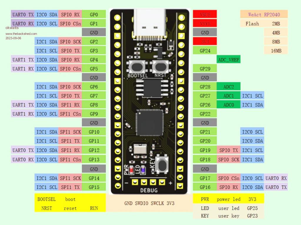

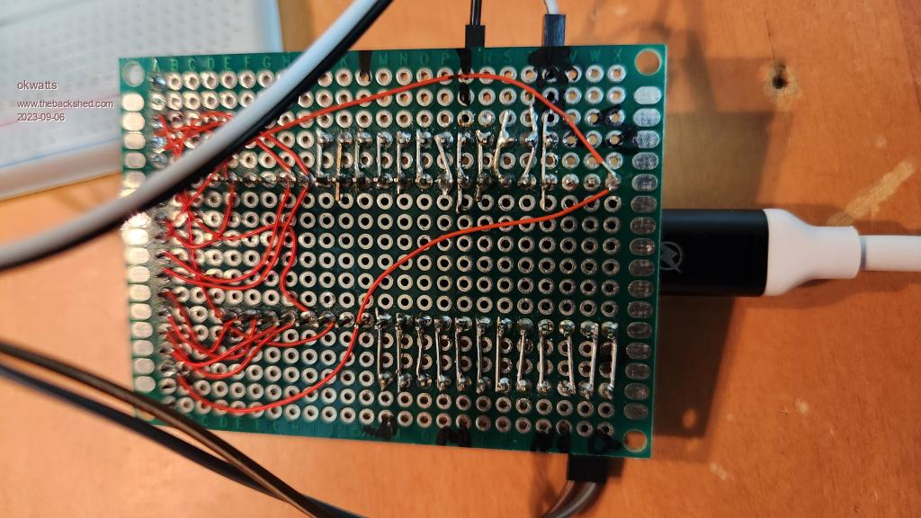

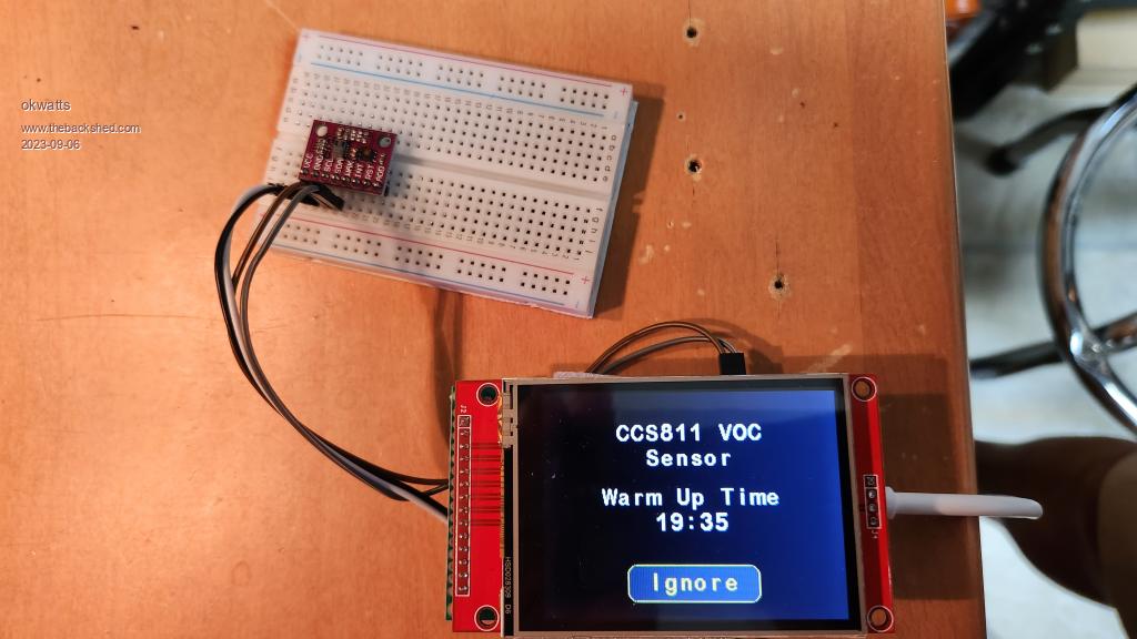

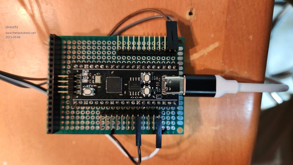

In the interest of showing another version I have been using the WeACT RP2040 which has most of the same features, 16MB Flash, USB-C but is not exactly pin-compatible with the genuine Pico. I have been using it at nominal speed but I have had it operate at 378MHz successfully as well. Since I am late to MMBasic I started with the PicoMite in its various forms. I used this particular version as a Pico replacement for Geoff's MicroMite LCD Backpack. I attach the pinout and I purchase this in Canada at the following https://universal-solder.ca/product/rp2040-pico-board-16mb-raspberry-pi/
For those who are capable of producing a board ( I have no design or KICAD experience) this would be a boon to me and perhaps others rather than having to wire this point to point like I did.

@ okwatts
That board is close enough to be used on most of the Pico and PicoMite patch board layouts. You may have to cut tracks where GP29 and GP24 are in some cases, but that's all. Note - although that is also black it isn't a YD-RP2040. :)
Edited 2023-09-06 16:54 by Mixtel90
Posts: 6572
Posted: 06:58am 06 Sep 2023
  Mixtel90 said
@ okwatts
The board shown has a lot of gotcha's from pin 30 onwards.
Starting with GP26 where the RUN reset button would go.
Posts: 9031
Posted: 07:12am 06 Sep 2023
Oh yes! I hadn't spotted that they'd moved all the ADC inputs!
Nope, sorry, WeAct - I wouldn't bother with that board. It breaks too many rules. I thought the YD-2040 was a bit out, but as I look at it more I think they made some good choices. I just with they'd used faster flash.

Posted: 09:12am 06 Sep 2023
Agreed that that the pins being moved from pin 30 on is an issue for the typical pico add-ons but for my purpose as a Micromite LCD backpack replacement it will work fine.
I can use it for Geoff's Air Quality monitor.
