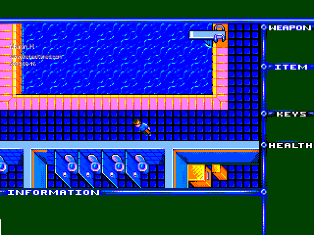

I'm currently in the process of adapting/convert/repaint every Tile into.spr Files.
Here is How it could look like on the Pico
with this Layout we are able to hide 53 Tiles under the Border
Edited 2023-09-15 21:06 by Martin H.

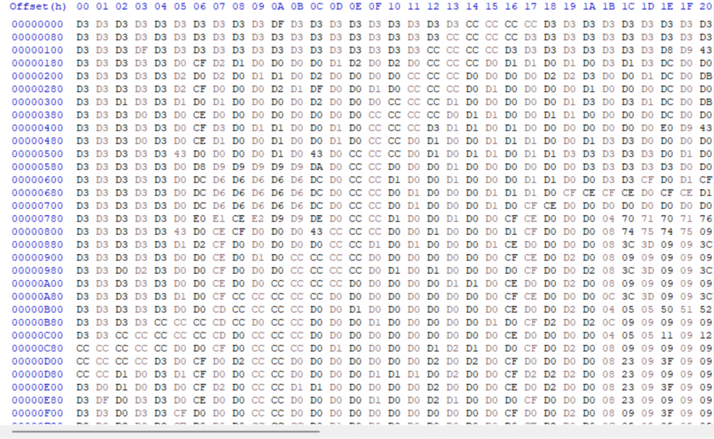

Posts: 6187
Posted: 01:17pm 15 Sep 2023
Martin,
I downloaded the user manual for the game. It shows (some of the) the maps.
Maps are 128 x 64 tiles (8kb when 1 byte per cell).
To make life easier, I suggest
The tiles (you are converting) should be grouped in 2 groups
1/ static tiles (floor/walls/grass/water/etc), there should be 127 of these maximum
2/ dynamic tiles (explosions, movements (opening doors), player, robots, etc..)
On the world map any number < 128 will directly translate into a tile
Any number > 128 will be an AI unit. The AI unit has a attribute list. In this list is the related tile number(s) depending on it's state. The AI tile can be any tile 0...255).
This allows to keep a compact world map.
I also have been looking at the video (part 1 is most interesting).
From that I derive:
world_map (x,y)
each cell (byte) contains a base tile number
if number < 128 then tile
if number > 127 then AI unit under/on tile
tile_attrib (128)
each cell (byte) contains tile capabilities (taken from youtube film David)
bit 0 = can walk on it
bit 1 = can hover over it
bit 2 = can be moved
bit 3 = can be destroyed
bit 4 = can be see through
bit 5 = can push onto
bit 6 =
bit 7 =
AI unit_attrib (128,8)
each object can have capabilities (taken from youtube file David)
byte UT = (unit type .. robot/door/etc...)
byte X = X coordinate
byte Y = Y coordinate
byte A =
byte B =
byte C =
byte D =
byte H = health (or hit points)
Edited 2023-09-15 23:30 by Volhout

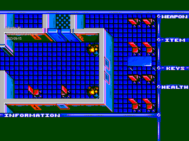

so here is my work so far ...
All Levels, Tiles and most of the Sprites..
There is a little test program,
I haven't optimized anything here yet because it's just for illustrative purposes.
PETSCII.ZIP
The assignment of the tiles to the maps is not yet correct but I've moved enough pixels for today.
Has anyone contacted David Murray about permissions?
Edited 2023-09-16 02:35 by Martin H.
I recreated the Tiles from the PSP Version and now they assign to the tilenumbers in the maps.
PETSCII.ZIP
looks good, so far.
