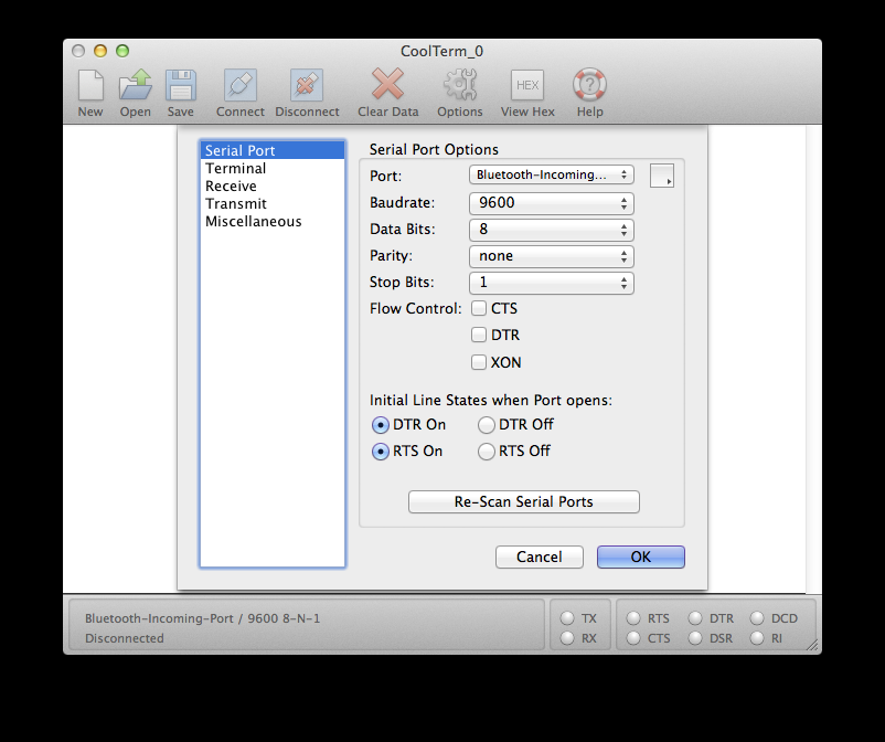

  jovian said  CoolTerm on Mac, no line delay, settings as usual, 230400 baud...
(from: https://www.mac-usb-serial.com/docs/tutorials/access-serial-port-on-mac-with-coolterm.html)
can you confirm that NONE of the flow control check-boxes are ticked, and that "DTR On" and "RTS On" are both selected?
rob   :-)
Yes, only diff is I have baud at 230400. It's working perfectly now I have put the temperamental Pico aside.
