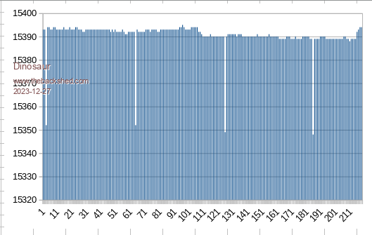

Just an update for anyone using the Pico for pulse counting.
The chart below shows that on every interrupt (60 secs) the count gets corrupted.
So have to edit the reading so that this reading is ignored.
Otherwise getting 4mA stability with no Input on the ACHS7123 and connected to an AD654.

Posted: 07:48pm 27 Dec 2023
Hi All
Found the issue.
Ran tests all night and when I looked at the data, discovered that instead of getting a drop in counts every minute (during Wifi).
I now have a drop only every Hour.
           If Delay4 = 1 Then                        '1 Hour's time is up.(10 year life)
               VAR Save BattCharge                   'Saving for possible reboot
               StartTime4 = mSec :Delay4 = 0
               If PFlag = 1 Then Print "5: Var BattCharge saved"
           EndIf

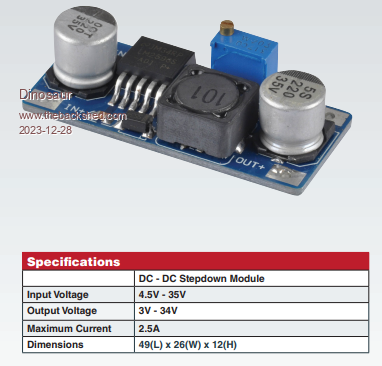

The AD654 is running on 10vdc, so not the cause, but the Volt 2 Freq converter is on 5vdc.
When the Pico draws more current (Wifi, Var Save) there is a slight voltage drop during that minute.
It lasts for about 28mSec. Will see about adding a cap to see if that solves the problem.
Haven't measured actual current drawn yet, but this PS should easily handle it.
It was always going to be time consuming to emulate this in simple code example, as whomever was going to test would need to have a Wifi link as well.
