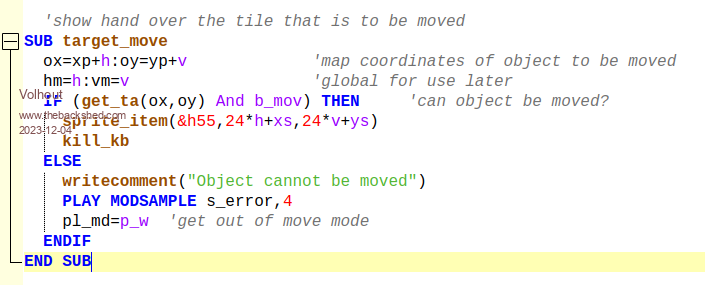

Tom also found a timing issue with his controller implementation (in his list issue 4) that he still is looking into. That issue was fixed by me, but apparently got back (in other words...my fix was not a good fix).
For Tom: The "kill_kb" in below code fixed it in the earlier version

By the way, pet25h.bas re-introduced an old bug in my damage routine (now you can shoot plants again, which was an earlier bug in pet17x), so my investigation of the tile attributes is really needed to get damage compliance. But pet25h has Tom's suggested information strings, adapted for length...
