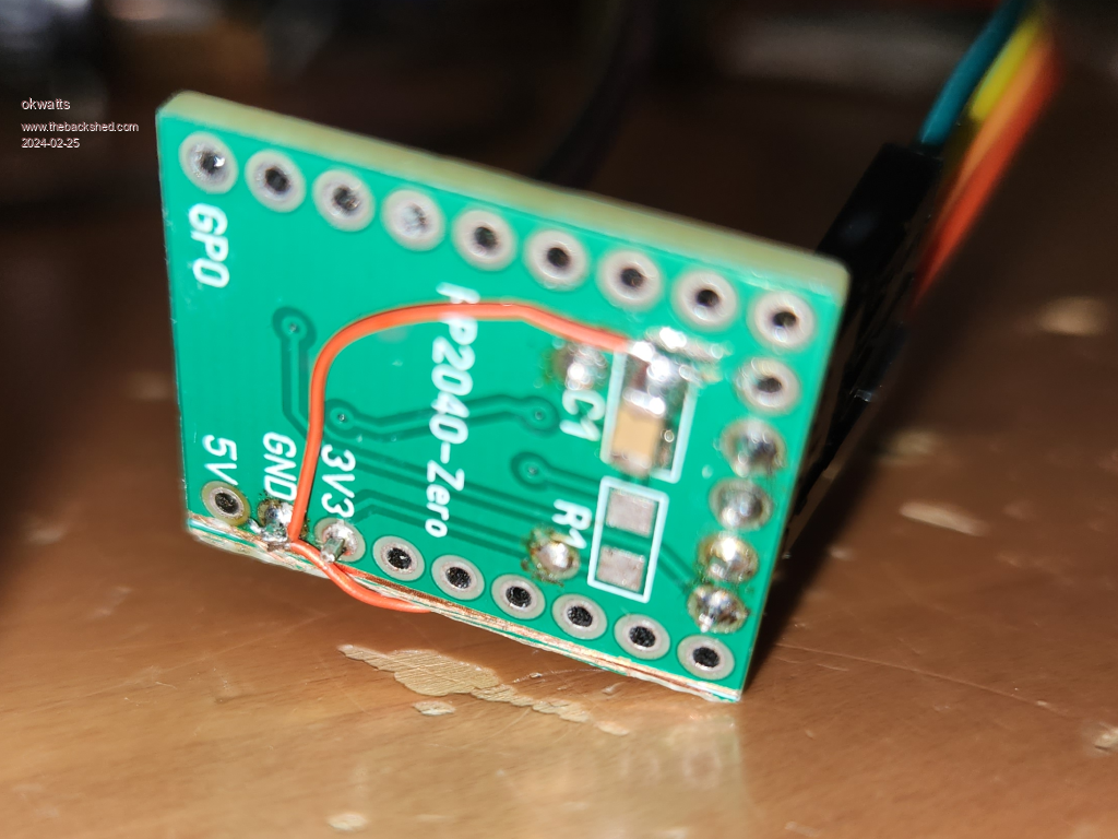

I am totally bamboozled by this behaviour so it must mean there is a glaringly obvious issue I am not seeing. I have been trying to get the SDcard setup on one of Mixtel90's little boards for the RP2040-Zero (thanks to lizby). I carefully separated a board, install the cap C1 (10ufd) and R1 (through-hole 10R). Dutifully soldered the boards together and setup the SDCARD as option sdcard GP13,gp10,gp11,gp12.

I am guessing C1 is across the SD supply pins and R1 is in series with the supply.
If so try reducing R1 to 2.2Ω, or bridge it out if you don't have one. Some SD cards are more fussy about the supply than others.
Posts: 9201
Posted: 09:36am 20 Feb 2024
R1 is probably way too high. The usual value is 2R2 - although a dead short is usually fine for microSD cards in my experience. Try shorting out R1.

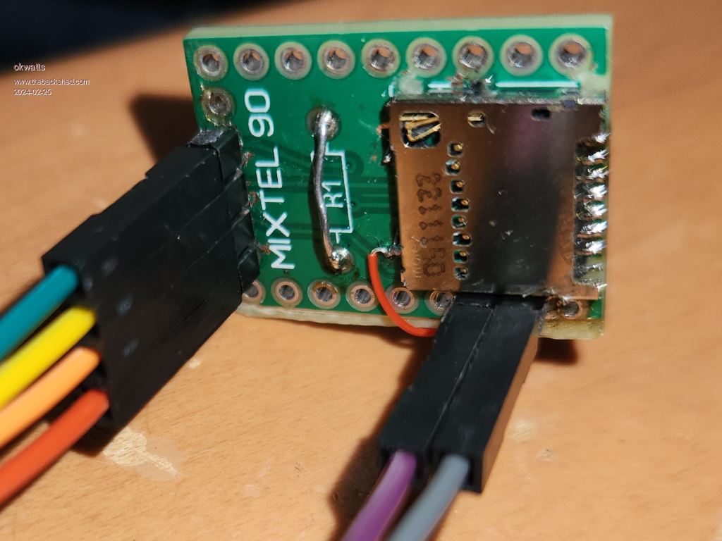

Okay I tried some things. When I used a different sdcard in my setup with the external sd module and both the picomite and RP2040-zero it was recognized and I could see a list of files. When I reverted to my previous sdcard used in Peters PicomiteVGA it was not seen. So there is a difference in the 2 sd cards. Okay so I reassembled Mixtel90's sd daughter board (replacing the 10R resistor with a jumper) and the RP2040-Zero and I had no joy with either sdcard. I then traced out the daughter card and I believe there is no ground connection from the ground pin to the sdcard. I would like Mixtel90 or lizby to verify that. I tried a jumper from the ground pin to the case of the sdcard holder and this is with a loose fit of the 2 cards (I didn't want to have to solder and desolder the cards again) so the connection may be sketchy. In any event that didn't make either of the cards visible to MMBasic. At this point I am taking a break from this project and will await more feedback.
Posts: 9201
Posted: 09:12am 21 Feb 2024
I've just dug the design files out.
There *is* a missing GND, but it's not the SD card. It's from the Zero's GND pin, which is isolated. Unfortunately C1 is grounded to one side and the SD card is grounded to the other, which makes things a little awkward. Try a wire link from the Zero's GND to any GND or metal shell on the SD card socket. It will probably work then. Grounding C1 is more awkward as it is sandwiched between the Zero and the board and there are no other GND points on that side. It would be easy to put another capacitor underneath though If you can scrape the solder mask away on the top side adjacent to the Zero's GND you may be able to solder blob it though.

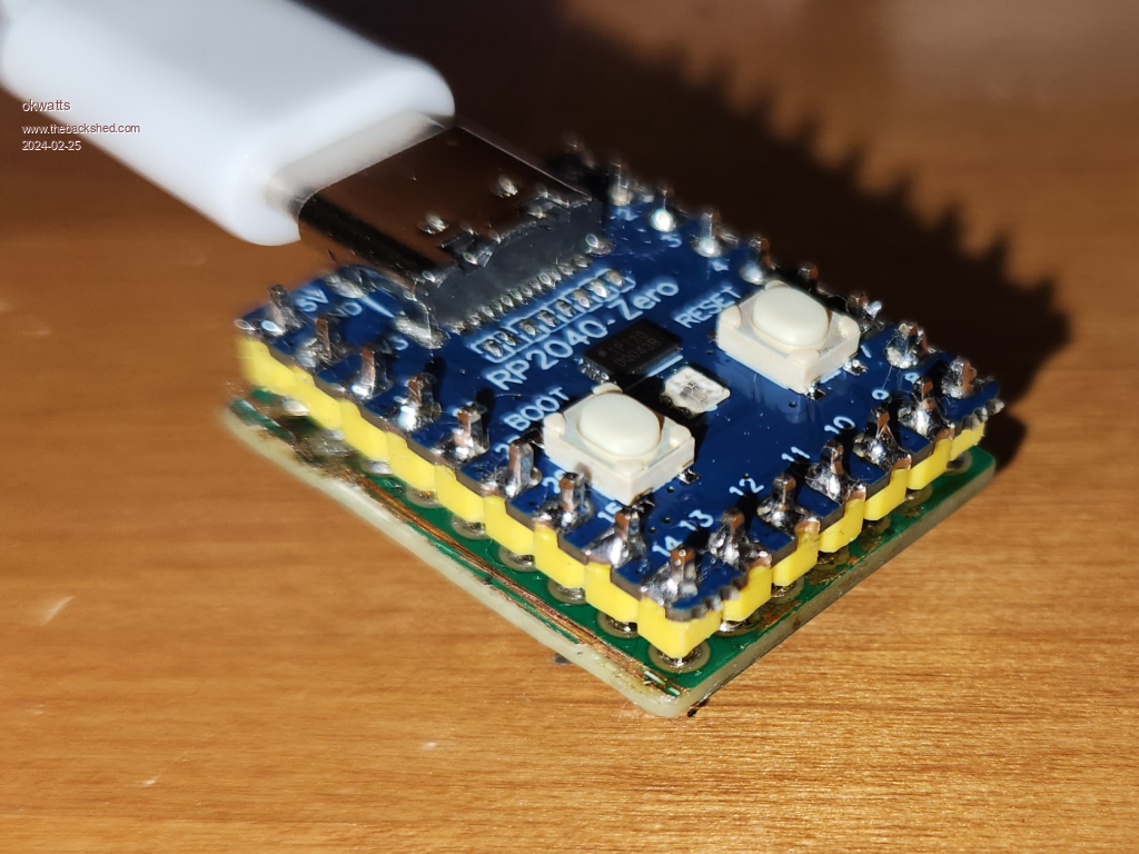

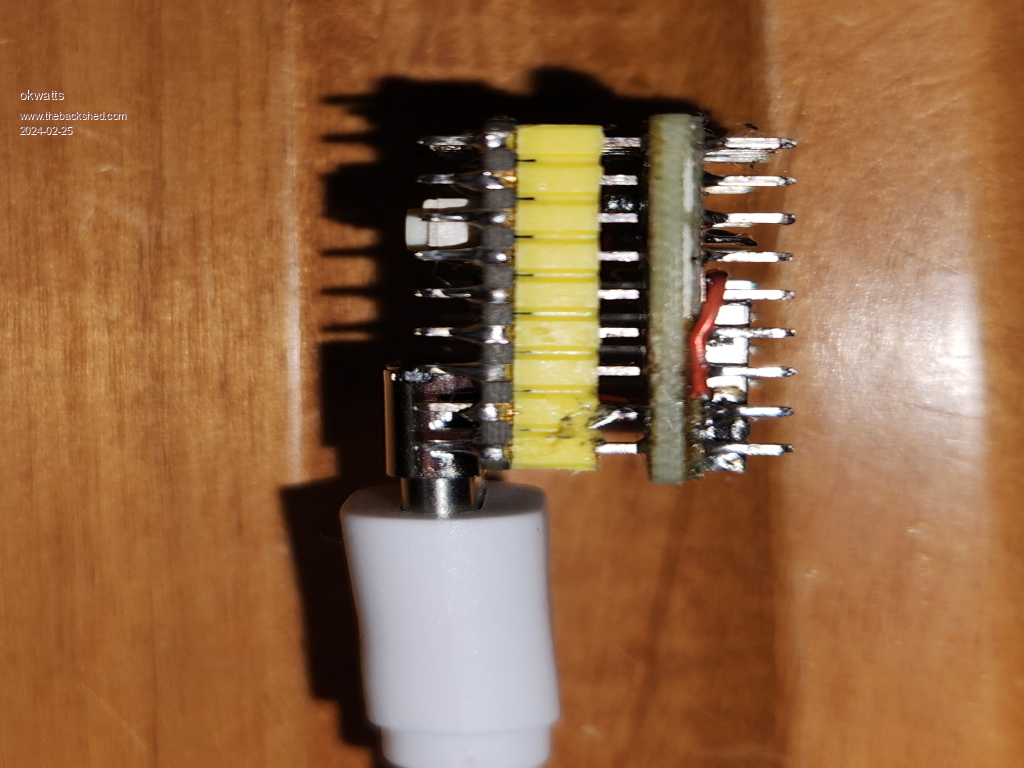

Posted: 06:40pm 24 Feb 2024
Just an update to say that I ran jumpers and tried out this with dupont wires and this worked. Pictures below and then reassembled as a sandwich and managed to keep it working (lots of desoldering, resoldering etc.)

Posted: 08:55pm 24 Feb 2024
Thanks for the pics! I love seeing my designs built up by others. It's encouraging. :)
