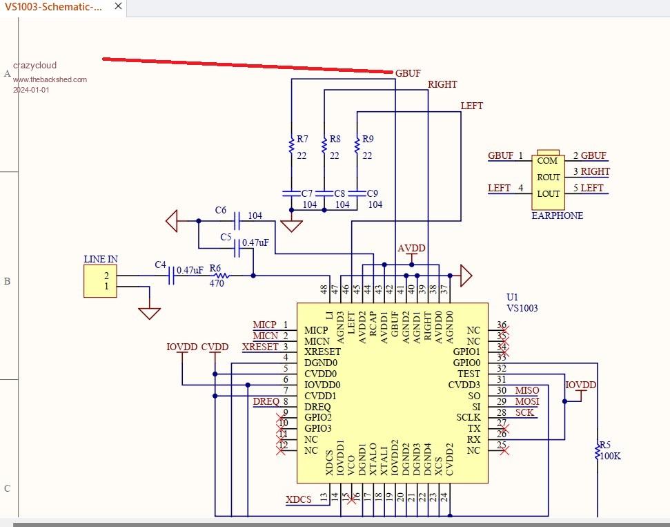

Posts: 9036
Posted: 09:51am 31 Dec 2023
It's very easy to use it ground-referenced. Basically, put isolating caps inline. There is a small RC filter recommended as well to get a line output. I think the ability to drive 35R headphones directly at a reasonable volume is pretty cool personally. :)
Posts: 4392
Posted: 09:55am 31 Dec 2023
Could anyone provide an explanation suitable for idiots of what you are talking about regarding "ground" with this module ? I may have cobbled the Game*Mite together but I freely admit it was a cargo-cult job.
Edited 2023-12-31 20:03 by thwill
Posts: 9036
Posted: 10:10am 31 Dec 2023
Sure.
The VS1053 produces a "virtual ground" at half supply voltage. The common of the headphones goes to this and the "signal" ends go directly to the outputs of the VS1053. Those outputs produce a signal that is relative to half supply voltage (swinging towards supply and gnd on each half of the waveform). As the headphones common is at half supply voltage there is no DC across them when there is no signal so there is no need to fit DC isolating capacitors. These would normally be relatively big, at least 100uF to get decent bass even into 35R headphones.
Hope this helps...
Edited 2023-12-31 20:12 by Mixtel90
Posts: 4366
Posted: 11:46am 31 Dec 2023
So when crazycloud warned not to connect to anything with a ground he means with a ground also connected back to ground on the VS1053 board? (i.e. avoid shorting the centre reference to ground - have I got this?)
(Which headphones don't do, of course.)
Posts: 9036
Posted: 11:58am 31 Dec 2023
Yep. You must never connect the virtual ground to true ground. It's probably generated at the junction between two MOSFETs, so you would be shorting out the lower one. They say it's protected against this, but it's still not a good idea to rely on protection. The virtual ground is just that - a common point for headphones.
The Land R signals are still swinging between GND and supply, so the signal is there. It's just that it's superimposed on a 1.6V DC level. You could use common ground headphones but you'd have to put 100uF capacitors to isolate each channel. If you think about it, it's just the same as using an op-amp (or anything else with a push-pull output) on a single rail supply.

crazycloud
Joined: 20/08/2023
Posts: 40
Posted: 05:06pm 31 Dec 2023
  matherp said
  Quote  I'll be spending some of my coffee money on one of those boards.
Things to note about the VS1053.
1.  It uses a lot of time in an interrupt routine to send the data as the SPI speed is limited to a maximum of 6MHz so for a 48000Hz stereo WAV file = 1.536Mbits/second over 1/4 of CPU time is taken by SPI transmission alone. Add in the disk read/ packaging overhead and there is little left. MP3 isn't quite so bad. MOD files are sent as WAV so high overhead
2. It uses a lot of pins (7) and an SPI port different from SYSTEM SPI/SDcard
3. Initialising the VS1053 takes a lot of time so it isn't possible in games to play short snippets of sound
4. HOWEVER, it does things other audio mechanisms can't so for sound applications it is the dog's ....
I was wondering if the Armmite F4 basic will ever have commands to run the VS1053?
It is faster and has many more I/O pins.  I built 2 of these with the matching display.  I had to remove a few pins from the ends of the processor board in order not to short out the 3.6 volts.  they work great with this mod.
here is a marked up image showing the virtual ground on the VS1053 board.
I spent the morning playing with the internet radio program, It's really a breeze to run, and great quality.  I have the output coupled to an audio transformer. The other end goes into a bluetooth transmitter so I can listen with bluetooth headphones.

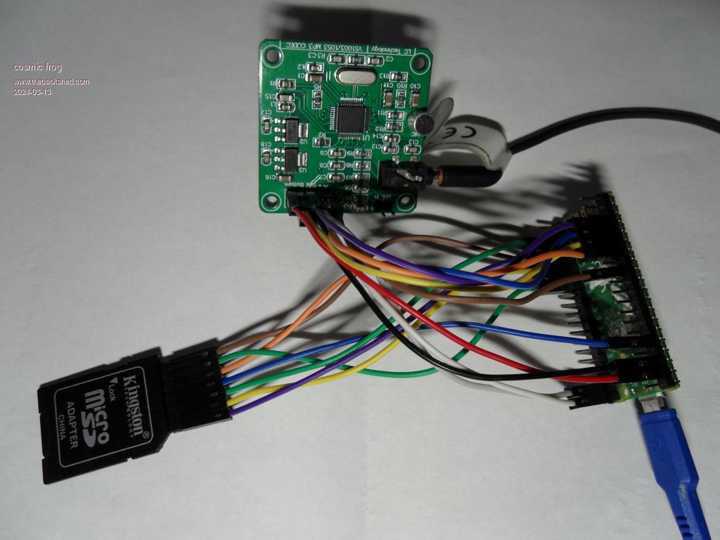

Posted: 11:32am 13 Mar 2024
Just started playing with one of these (Had some for some time but not had chance to try them) and noticed it plays MP3's in "slow motion" and sometime gets a read error. If I change the CPU speed down to 48000 it works fine, but when I change the CPU speed higher the MP3 plays slow.
Has anyone else come across this problem? I'm thinking it may be a wiring problem as I'm using header pins connected using those Dupont type connectors and I've had problems with these things before.
PicoMite MMBasic Version 5.09.00b6
OPTION CPUSPEED  48000 'KHz
OPTION SDCARD GP13, GP10, GP11, GP12
OPTION AUDIO VS1053 GP18,GP19,GP20,GP21,GP22,GP0,GP1', ON PWM CHANNEL 1
Thanks.
Dave.
cosmic frog
Joined: 09/02/2012
Posts: 308
Posted: 12:54pm 13 Mar 2024
Just been reading another thread about something similar, where putting a 100pf cap across XCS and ground fixes a Read failure problem.
I tried a 220pf cap and it has fixed the "slow motion" problem at high CPU speeds.
It's now working great!
Dave.
