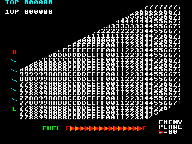

Possibly a New Project for 2024
some Code to test it out
the scroling Text should be replaced by Tile Based Graphic

then it could look like this on Pico
'no comment

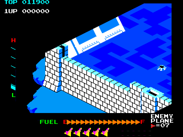

Posts: 6171
Posted: 11:20am 03 Jan 2024
That already looks very much like zaxxon.
I need to watch some demo movies, since I never owned an msx, so never played it.

  Volhout said  That already looks very much like zaxxon.
This isn't a MSX thing, you might try the Arcade Version
