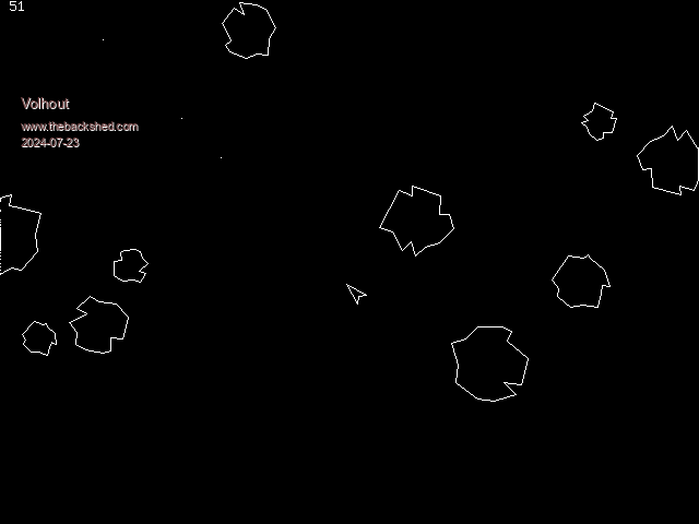

Posted: 01:30am 19 Jan 2024
Update to PicoRocks, using the new array rotate command added to firmware v5.08.00RC4
The program is suddenly a whole lot shorter.
For fun, I've made all the rocks rotate too. This will really bog down though if many many rocks need to be drawn.
Edit: The program below works fine in MODE 1 too, just change line 12. No colours, of course. You might also want to scale things up a bit.

I get syntax error in sub DrawShip
RUN
[134] Math v_rotate 0,0,ph,x(),y(),x(),y()
Error : Syntax
> option list
PicoMiteVGA MMBasic Version 5.08.00b5
Posts: 3886
Posted: 04:52pm 19 Jan 2024
  stanleyella said  ... PicoMiteVGA MMBasic Version 5.08.00b5
You identified your problem--several versions behind the times.
Posts: 2807
Posted: 05:06pm 19 Jan 2024
I can't get V5.08.00RC4  https://geoffg.net/Downloads/picomite/PicoMite_Beta.zip
it's just a text file saying At this time no new Beta version is available
I got rc3
Edited 2024-01-20 03:28 by stanleyella
Posts: 9287
Posted: 05:14pm 19 Jan 2024
Get the latest version from Geoff's site, Stan. It's got the new manual and everything.
Posts: 2807
Posted: 05:35pm 19 Jan 2024
No Mick RC04 from beta download is just a text file.
Posts: 4407
Posted: 06:16pm 19 Jan 2024
  stanleyella said  No Mick RC04 from beta download is just a text file.
Stanley the beta and release-candidate periods are over and there has been an official release, see the links in this thread https://www.thebackshed.com/forum/ViewTopic.php?FID=16&TID=16607
Edited 2024-01-20 04:17 by thwill
Posts: 2807
Posted: 07:06pm 19 Jan 2024
Thank you Tom, I saw the thread before but didn't connect.
code works now with picomite vga5.08.00 and it's very impressive! loads to learn from, much better than my methods. nice to see someone who knows his stuff sharing mmb features with example code.

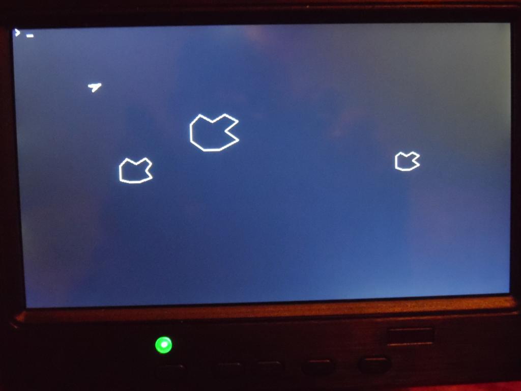

Posted: 05:17pm 21 Jan 2024
strange with ili and non vga
https://www.youtube.com/watch?v=RWVrMc5veOY
