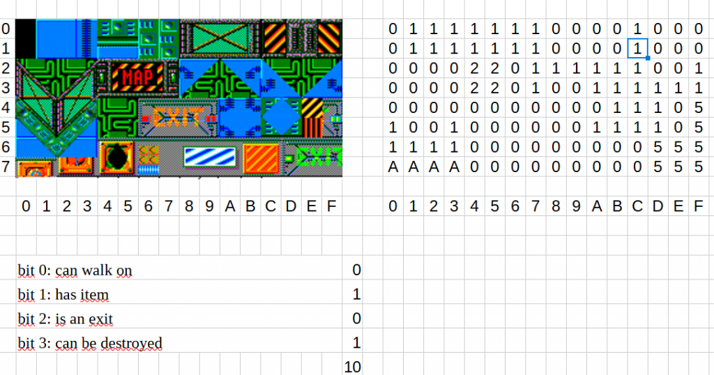

Before the start of the game mechanics can begin, it would be needed that you begin with creating the tile attributes. The minimum to start with is defining the "can walk on" bit for each tile (similar to PETSCII).
In this game you cannot move items, and they are not "hidden", there are no animated doors, so we may be able to avoid the numerous UNITS that exist in PETSCII. Only the 4 active enemies at  a time, and the player. So the gameplay is easier (flatter). And we may be able to speed things up if we assign the game mechanics for a large part to the tile attributes. That saves us the effort of search through all UNIT attributes.
As far as I can see these bits are needed, but doe not have to be defined from the start.
bit 0: can walk on
bit 1: has item
bit 2: is an exit
bit 3: can be destroyed ?
bit 4,5,6,7: can hold an item index.
But for start, it would be needed to have the "can walk on" bit for each tile in one level. Then we can see if smooth walking in all directions works as expected.
Edited 2024-02-15 18:25 by Volhout

bit 4 , can fall into

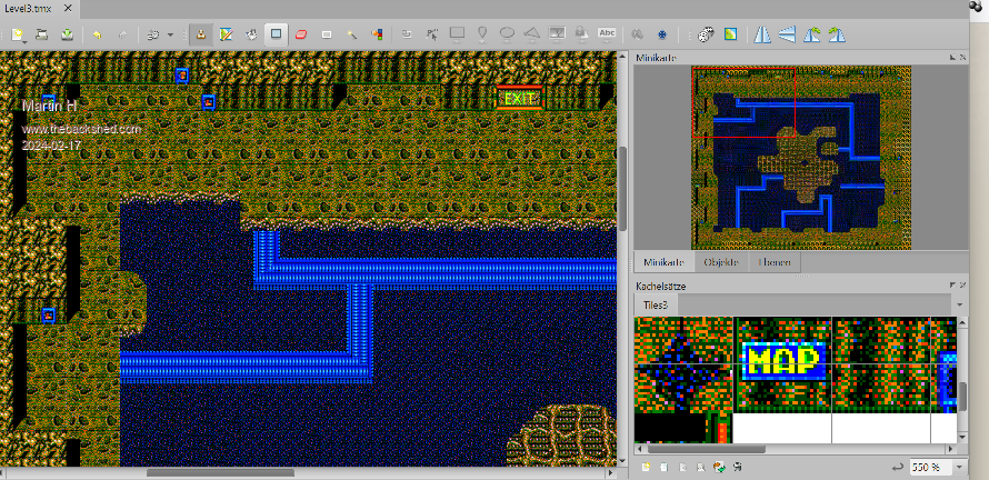

As I see it so far, there are several things that can be hidden. The map, the drones that keep your back free and the increase in weaponry. I should be able to implement the assignment reasonably quickly. There is a maximum of 128 tiles per level. In the original game, the tiles are twice as big, so I always have 4 together, which have the same properties.
I'll probably manage that at the weekend. Then adapt the scroll mechanics so that you can move the player using the buttons.
I just have to make sure that the player moves all the way to the edges. So his position on the screen is not fixed, unlike in Petrobot.
The drawing of the enemies is progressing and the tiles and map for level 3 are also finished.

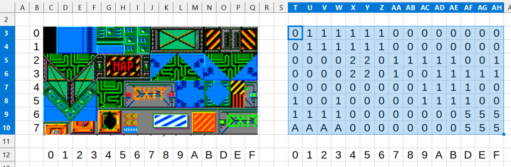

Hi Harm,
I think in the next version I will attach 128 bytes with the tile attributes to each map so that they can be read with each map.
like this:
I also spent time this weekend working on the Tile_Row and Tile_Col subs, which I will test tomorrow and, if they work, replace the existing scroll_BG sub.
Once the attributes and the new sub-routines have been implemented, it should be possible to walk through the worlds with the player.
Martin

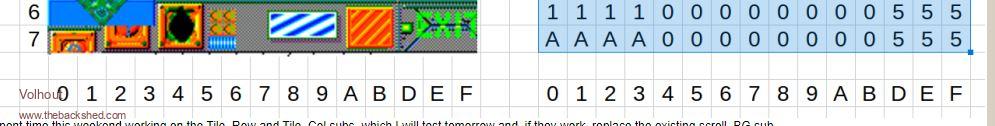

Nice overview Martin !!
This definitely helps in development
Maybe you could also add a column "C" ? (in 0,1,2...E,F, the C is missing).
I am sure you wanted to see if I was awake....yes I am !!
Edited 2024-02-19 22:01 by Volhout

Ups ..
you're right of course, and I didn't notice.
That's what happens when you do something like that (quickly) before you go to sleep.
But it explains the principle of how I will assign the attributes to the tiles
