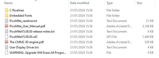

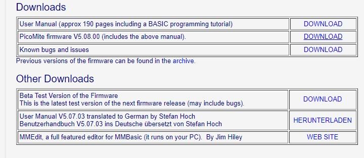

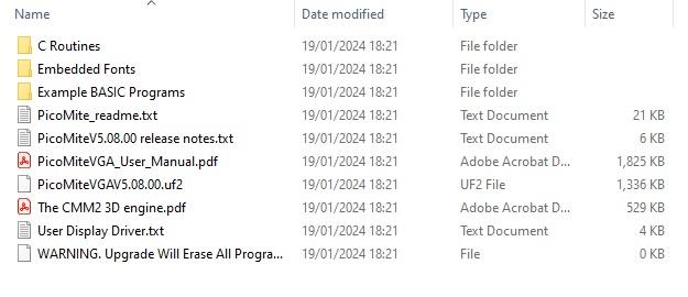

When I downloaded it only vga
but downloaded again and only non vga ??
no options, I just clicked download
Edited 2024-01-22 02:43 by stanleyella
Posts: 3886
Posted: 05:43pm 21 Jan 2024
User error: mistakenly flashed the webmite version to a non-webmite
Edited 2024-01-22 03:49 by lizby
Posts: 2807
Posted: 07:37pm 21 Jan 2024
  lizby said  User error: mistakenly flashed the webmite version to a non-webmite
I just clicked download with manual and got vga so downloaded again and got non vga??
Posts: 2807
Posted: 07:45pm 21 Jan 2024
before there were vga and non vga in same download,,,weren't there?
Posts: 3886
Posted: 07:59pm 21 Jan 2024
  stanleyella said  before there were vga and non vga in same download,,,weren't there?
Peter's developmental releases have typically contained picomite, vga, and webmite versions. In the new release on Geoff's site, as with previous releases, they are on separate web pages for each variation.
