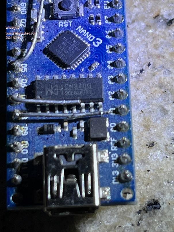

Ok I forgot to tell you all a little tale of Nano woes that date back a quite a while.
When I first went to order a Nano I sent an image of the one I found on Ali to Poida and he said yep that there is the beast you want go for it, little did I know....
Recently when Poida was sending me code updates, quite often at times (he can program and improve faster than I can test). I had the normally deathly quiet improved zero cross version (perfect symmetry or typoed prefect symmetry) inverter code I could hear the hum varying and it grunted a bit more on startup. So I complained about the poor quality code I was being sent for free lol and Poida just glared and said it works just fine, it can't be the code.
So I had in my possession 2 whole nanos one reference unit that was dead quiet and the other that was getting all the updates to the code with varying hum.  Then I got a third nano built and now it gets more interesting, randomly with new codes some would have this "hunting" hum other versions were much better.
So I got the two codes - one dead quiet and the other with the hunting hum and emailed them to Poida with notes, here is the proof, take that!  My next email from Poida said yeah I tested them they are both perfect as expected.
About this time I thought Poida can't be seeing what I am seeing so I loaded all 3 of my Nanos with the exact same code and tested them, the first two perfect, the third - yep you guessed it wandering hum. It was the f$%#ing Nano mega chip which incidentally was a QFN pack (smaller than the typical gull wing types) & stamped (etched) with an Atmel logo that didnt look like an Atmel logo and clearly marked as "China".
I am positive that this was the very same Nano that had me going in circles trying to fix my inverter grunt. You can tell from all the wires soldered to it for attaching CRO probes and meters. ~$3 worth of tens of wasted hours and woes.
Moral be sure you get the right Nanos, the faulty one does basically work but I sense it emulates the mega chip or something, no doubt small port timing issues of nano seconds that sometimes all can randomly add up to inbalanced core flux.
Cheers Mike

  wiseguy said  Moral be sure you get the right Nanos, the faulty one does basically work but I sense it emulates the mega chip or something, no doubt small port timing issues of nano seconds that sometimes all can randomly add up to inbalanced core flux.
Ouch, that's gotta hurt if that was the cause of your original toroid grunting problem too.

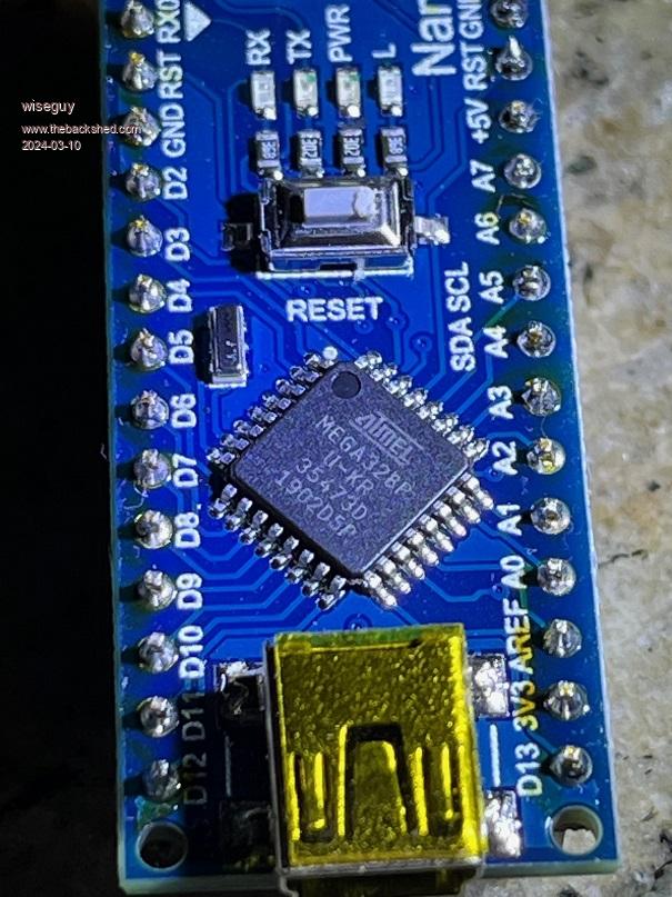

wiseguy
Joined: 21/06/2018
Posts: 1335
Posted: 10:56pm 09 Mar 2024
  rogerdw said
Of course the $64,000 question is  ...  how do we know which ones are okay  ...  do we need to spring for the genuine ones? Maybe Poida can link to his source perhaps.
Roger I've decided to answer the question and as its for you I'll do it for half your suggested payment.
Typical Good Nano, note only the main mega IC on top
Very Bad Nano (maybe I just got a bad one?) Note second IC on top
Look for the one similar to the top picture and note there are 3 different USB connector types on Nanos - I use the USB mini as per the pictures, there is a USB micro and a USBC type. A listing light just have the one you want in the big picture but maybe not all the ones they sell are the pictured ones so look closely at the smaller picture that you click on before purchase.
A seller or two with good Nanos is a good idea to post a link - Ill leave that to Poida.

Hi Bryan, I should have pointed out more clearly the Nanos with only the main chip on top has the other chip, but on the underside.
