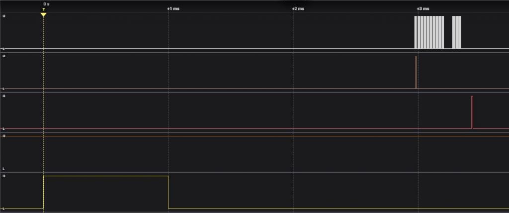

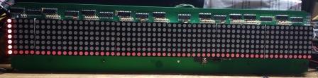

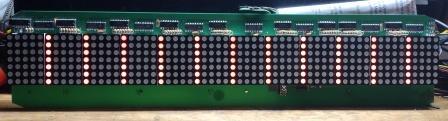

Ok I found an LS138, ran the three unused bits off the last 4094 into the inputs of the LS138.
The outputs from the LS138 then pull down the gates of the RFP Mosfets through some low value resistors.
Slight mods to the code and that is almost perfect, though there were some artifacts on the display bottom line.
Looking on the scope there is what look like very fast pulses coming out of the LS138 outputs, which I think is the data being clocked into the 4094's rippling through as I had enabled the LS138 permanently by connecting the enables to gnd and vcc..
So I have used a pin on the Pico which I connected to one of the enable inputs on the LS138, I shift the data out using SPi, then toggle the latch pin on the CD4094, finally I enable the LS138.
Flicker has now completely gone, so all good.

The RowDelay was just so I could put a 2 second delay between each row so I could try and find the source of the flickering, it can go now.

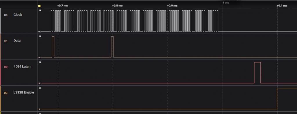

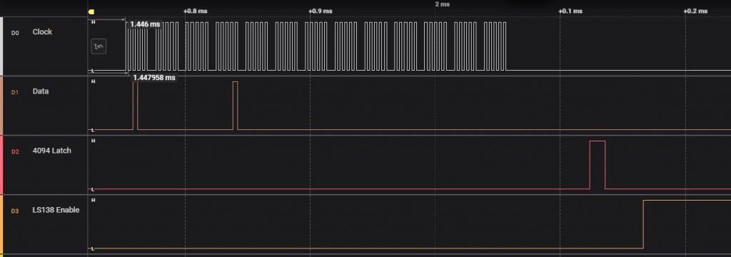

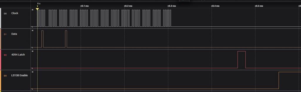

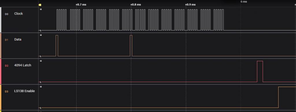

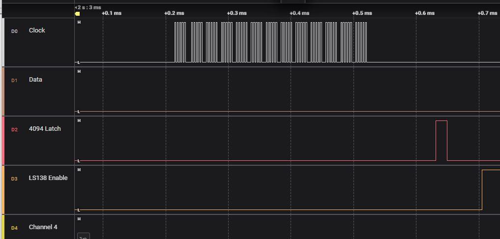

I've added the first byte in the data table as the byte that selects the Row from the LS138, playing around with the bit's in the first byte, it isn't clear at the moment what is wrong, but these are screenshots from 'Logic' for the first 4 row data.
I've changed the data in the table too so I can see where the relevant bits are in the analyser display.
Row 1
Row 2
Row 3
Row 4
I can send you the captured data if you use Logic by Salae (which I think your screenshot was from).

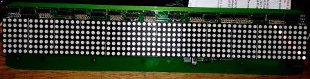

I think it maybe something to do with the line
math slice txt_out(), ,i ,row_out()   'copy into single dimensional array
If I comment that line out and do it line at a time with a for next loop, then the data coming out is correct from what I can see on the analyser.

the only odd thing now is the left hand most column of LED's never lights, also, if I send out all the data bytes set to 01, I would have expected the righhtmost LED in each group of 5 to light, but they don't sending out
 data &B00000,01,01,01,01,01,01,01,01,01,01,01,01
'row 2
 data &B00010,01,01,01,01,01,01,01,01,01,01,01,01
'row 3
 data &B00100,01,01,01,01,01,01,01,01,01,01,01,01
'row 4
 data &B00110,01,01,01,01,01,01,01,01,01,01,01,01
'row 5
 data &B01000,01,01,01,01,01,01,01,01,01,01,01,01
'row 6
 data &B01010,01,01,01,01,01,01,01,01,01,01,01,01
'row 7
 data &B01100,01,01,01,01,01,01,01,01,01,01,01,01
I am seeing this
Could that be because we're sending 65 bits?
Tony

58kk90
Joined: 14/06/2023
Posts: 82
Posted: 07:51am 18 Mar 2024
Ignore the last email, I have just re-programmed it and it now is exactly as I expected, just the left most LED on each group of 5 LEDS' lit.
Now to figure out how to make digits, and get them into the array.
Really appreciate the help so far, I have learned a lot in the last 24 Hours!
Tony

I just tried the data lines you sent, I get nothing recognisable on the display,
I think there still maybe something wrong in the shift / math bit.
If I set the data bytes to all 0 including  the first byte which selects the row, that should clock all zeroes to the display.
I've set a trigger pulse at the start of the code to trigger the analyser, then captured clock, data and 4094 latch.
For some reason I am seeing a '1' on the data line, but the data does'nt have any 1 bits set for the first row.
Top trace is clock, next one down is data and the next one down is the 4094 latch, the bottom one is the 1mS pulse to trigger the analyser.
This  is the code that produced that capture.
'4094  driver, running on picomite GEEK unit
option default integer
Const LS138Enable = MM.Info(pinno gp1)              ' enable to the LS138
'SPI channel
setpin gp16,gp3,gp2,spi    'gp2=clock, gp3=tx , gp16 is not used
'CD4094 shifts on rising clock edge, input data must change on falling edge.

And the matrix looked like this
I took out the enable to the LS138, I am now seeing the artifacts on the bottom row you can see in the picture, if I have the lines back inf or the LS138 enable, the artifacts disappear.
Tony
Edited 2024-03-18 19:39 by 58kk90
58kk90
Joined: 14/06/2023
Posts: 82
Posted: 09:54am 18 Mar 2024
No idea what is going on
using the math V-OUT you mentioned, right before the SPI instruction, I get
0, 0, 0, 0, 0, 0, 0, 0, 0, 0, 0, 0, 0
2, 0, 0, 0, 0, 0, 0, 0, 0, 0, 0, 0, 0
4, 0, 0, 0, 0, 0, 0, 0, 0, 0, 0, 0, 0
6, 0, 0, 0, 0, 0, 0, 0, 0, 0, 0, 0, 0
8, 0, 0, 0, 0, 0, 0, 0, 0, 0, 0, 0, 0
10, 0, 0, 0, 0, 0, 0, 0, 0, 0, 0, 0, 0
12, 0, 0, 0, 0, 0, 0, 0, 0, 0, 0, 0, 0
Which as far as I can tell is correct, so why I am seeing the '1' in the data out of the Pico is unknown.
Tony
58kk90
Joined: 14/06/2023
Posts: 82
Posted: 10:05am 18 Mar 2024
So replacing the line
spi write 13,row_out()                'send it out
with
spi write 13,00,00,00,00,00,00,00,00,00,00,00,00,00               'send it out
gives this on the analyser
Which looks perfect, all 0's sent, all zero's being clocked out.
Tony
Posts: 6171
Posted: 10:07am 18 Mar 2024
Hi Tony,
The "1" is in the first clock block, so it is the LS138 row address bit.
That should be correct.
I am not sure about the dim lit lowest row. MAybe that P-FET does not turn off fully. Is the LS138 output 5V, or only 4V. Maybe add a 1k pullup to the LS138 outputs. To make sure it is 5V and the FET is off.
The lit first row when sending 0's... I have no idea. I assume the data is shifted in from the left to the right ? So the lit column is the last bit sent ? Can you confirm ?
Posts: 6171
Posted: 10:14am 18 Mar 2024
Hi Tony,
Looking at the 1'st picture in the 9:37 post, the data should shift 1 bit further.
I will check if the SPI setting is right for the 4094. Maybe mode=0 is not correct (although I thought it was).

That is almost perfect, I get a backslash '\' on the rightmost 5 x 7 LED panel not sure why the previous versions were like they were, but clearing all the code and options from the Pico, and sending it again, it now ALMOST works.
By Almost, I have found an issue with the way the panel is wired, which may mean the code will need to be changed.
If I put 01 as the rightmost byte in the ROW 1 (or any row) data line, I see no LEDS lit.
If I change it to 02, then the right most LED lights up, looking at the pinout for the first CD4094, the D0 output doesn't go to the ULN driver like every other output pin does, it goes back to the header where the controller board would have fitted.
The right hand most column of the LED's actually goes to the D1 output via the ULN driver, which is why sending 02 lights the right hand most LED.
Sending 01, the pin on the header toggles high but no LED's light, which is understandable as the D0 output is effectively not used.
Tony

Ok, so these data lines
' Row 1
data &B00000,00,00,00,00,00,00,00,00,00,00,00,02
'row 2
data &B00010,00,00,00,00,00,00,00,00,00,00,00,04
'row 3
data &B00100,00,00,00,00,00,00,00,00,00,00,00,08
'row 4
data &B00110,00,00,00,00,00,00,00,00,00,00,00,16
'row 5
data &B01000,00,00,00,00,00,00,00,00,00,00,01,00
'row 6
data &B01010,00,00,00,00,00,00,00,00,00,00,02,00
'row 7
data &B01100,00,00,00,00,00,00,00,00,00,00,04,00
give me this
Which makes mapping the 'digits' to a 5 x 7 LED block a bit of a pain as it crosses byte boundaries.
Tony
Posts: 6171
Posted: 11:16am 18 Mar 2024
Hi Tony,
That is indeed a nasty problem. You can solve this in hardware if you want.
Use an OR gate (74LS32), combine CLK and LE, and use that to drive CLK. In essence you generate one extra clock pulse (the LE pulse).
But you will have to change the row selector in the first character (since that shifts 1 bit also). so 0,2,4,6,8,10,12 becomes 0,1,2,3,4,5,6
P.S. the 4094 D0 going back to the pico can be usefull to check that the display is connected and working.... Since it is the last bit sent, when it is correct, all bits sent where correct. But that is something for another topic...
