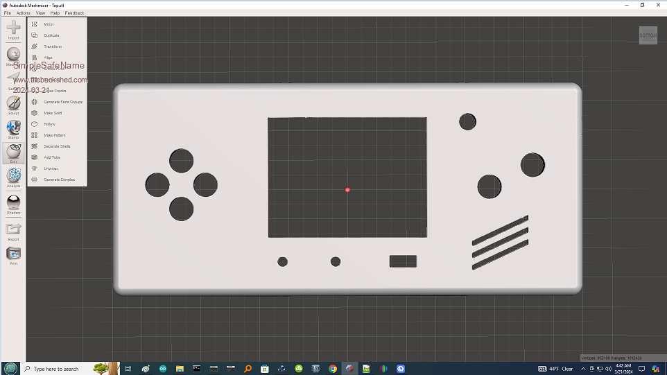

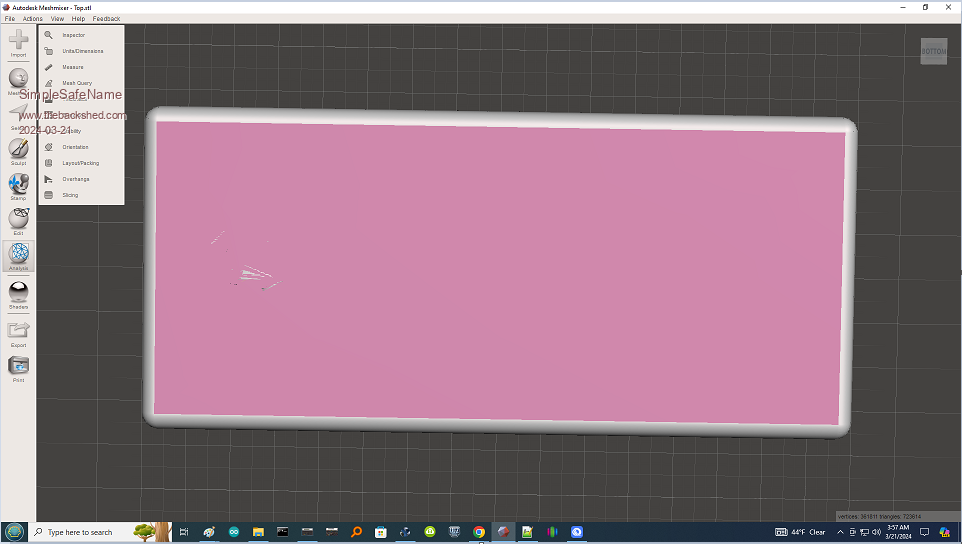

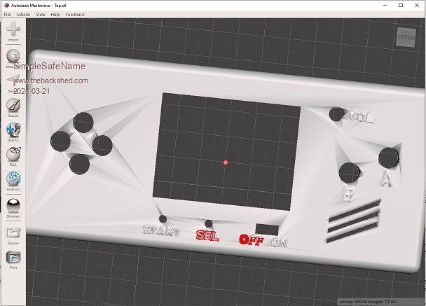

Oh what fun! OpenSCAD is correctly complaining about an "ERROR: The given mesh is not closed! Unable to convert to CGAL_Nef_Polyhedron." error.
This has happened to me in the past when I was trying to print the Destiny Thorn gun that someone had added their name to in the model. So until the error is fixed OpenSCAD won't render the file (and without a proper rendering, there will be no STL file exported).
So, off to MeshMixer. Which shows where the error is:
And MeshMixer's first shot at fixing the error:
Arguably it did fix the problem. LOL! Nonetheless, it appears that we have some work to do. :)
The best thing would be for Geoff to remove the text, but I'll muck about with it and see if I can fix it. My edits might leave a file that looks correct, but no longer prints accurately (but I don't expect that to happen).

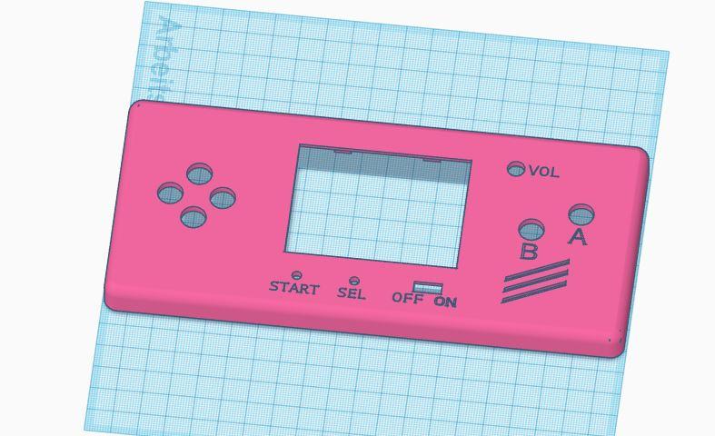

There seems to be some confusion going on here.  Probably a case of the blind leading the blind (at least I know that I'm rather blind in this discipline).
Firstly, I intended for the case to be made by a commercial company (ie, jlc3dp.com), not a home printer.  I have never used a home printer but my guess is that it would not work out very well - the STL files are complex, home printers have a rough surface finish, etc.  BTW, one of the reasons for such a complex STL file is that I was after a very smooth bevel on the corners of the case so that it would sit comfortably in the user's hands.
Also, I have only used Blender.  Other packages seem to work in a completely different fashion.  My recommendation to use Blender was solely based on the fact that I was able to get it to work after a steep learning curve.
Finally, the raised letters works well - easy to read but not annoying.  However, for anyone who needs it, I have created a version without the lettering (top enclosure only).  It can be downloaded from here: https://geoffg.net/Downloads/picogamer/TopNoLetters.zip.  I was reluctant to make it available as I have not had a test piece made, so please be aware that there may be a defect in it (although I doubt it).
Geoff

SimpleSafeName
Joined: 28/07/2019
Posts: 351
Posted: 10:17am 21 Mar 2024
Yeah! Thank you!
For the record, there is nothing wrong with your file - if - it is printed as you intended using a resin printer.
But if you want to print it at home using a filament 3D printer the bumps from the letters will lift the rest of the print off of the build plate and that part of the print will begin in mid-air (which won't work).
That's all that was "wrong" with it. But by editing your design to omit the lettering you fixed the problem for filament 3D printers. And it can now be printed at home.
I did "fix" it in MeshMixer, but I've forgotten what I did to fix the previous file for my friend. The resulting file is about 3 times the size (but looks pretty good), but it now exceeds the memory limits of OpenSCAD (my rig has 64 Gig, I'm going to go out on a limb and say that *I* didn't run out of memory).
But your file is the way to go.
Here's what I ended up with in MM:

Thanks John, maybe in future I should indent the lettering.
If you, or anyone, does print this on a home filament printer I would be interested in hearing about the experience (surface finish, accuracy of the features, strength, etc).
Geoff
