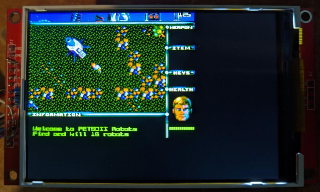

OPTION LCDPANEL anyspidisplay orientation, dcpin, resetpin, cspin [,backlightpin] [,INVERT]
if the new optional parameter "invert" is used the colours are inverted - supports the IPS ILI9488 display
OPTION LCD320 ON/OFF now supports 480x320 SPI displays. This allows programs that run on a 320x240 display to be run and tested on  the bigger display by restricting the framebuffer size to 320x240
