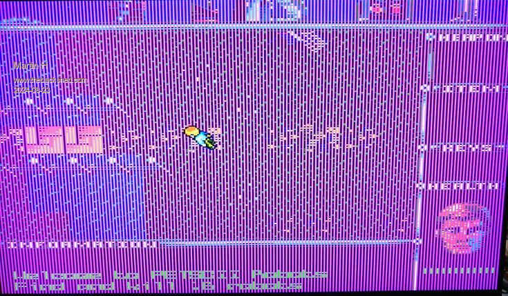

Posted: 11:36am 23 Aug 2024
Hi Peter,
My Pico 2 has just arrived, so first of all I tested the VGA version.
looks like there are some issues with the transparent color of the layer
  Quote  PicoMiteVGA MMBasic Version 5.09.00RC7
OPTION FLASH SIZE 4194304
OPTION COLOURCODE ON
OPTION KEYBOARD GR, 0, 0, 0, 0
OPTION CPUSPEED (KHz) 252000
OPTION DISPLAY 20, 40
OPTION SDCARD GP10, GP12, GP11, GP13
OPTION AUDIO GP6,GP7', ON PWM CHANNEL 3
OPTION MODBUFF ENABLE  180
cheers
Martin
'no comment
Posts: 12014
Posted: 11:50am 23 Aug 2024
Martin
Please could I prevail on you to knock up a simple test program for this problem

Martin H.
Joined: 04/06/2022
Posts: 1565
Posted: 12:17pm 23 Aug 2024
  matherp said  Martin
fast and dirty:
MODE 2
FRAMEBUFFER Layer 9
FRAMEBUFFER write l
Color RGB(Magenta),0
Font 5
For n=1 To 5:Print "** SHINE THROUGH TEST ";:Next
Box 80,60,160,120,,RGB(magenta),RGB(magenta)
FRAMEBUFFER write n
For R= 0 To 1
For G=0 To 3
For B=0 To 1
CLS RGB(R*255,G*85,B*255)
Pause 150:FRAMEBUFFER wait
Next :Next :Next
only every 2nd pixel is transparent
Edited 2024-08-23 22:22 by Martin H.
'no comment
Posts: 12014
Posted: 12:31pm 23 Aug 2024
Any better?
PicoMiteVGA.zip
Martin H.
Joined: 04/06/2022
Posts: 1565
Posted: 12:35pm 23 Aug 2024
  matherp said  Any better?
PicoMiteVGA.zip
 superb
Thank you for fixing
Martin

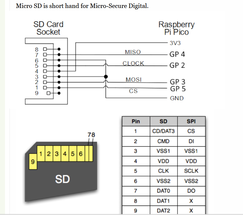

Joined: 04/06/2022
Posts: 1565
Posted: 09:20am 24 Aug 2024
If I judge the screenshots correctly, the SD card for the HDMI Version should be connected as follows:
am I right?
'no comment
Posts: 12014
Posted: 09:42am 24 Aug 2024
You can use any pins (except GP12 to GP19), I just happened to choose those. Just use OPTION SDCARD as normal
Posts: 6171
Posted: 01:48pm 24 Aug 2024
Peter,
Please explain. Gp12 is used for sd card in 2040
Gp19 is used for VGA in 2040
Is this violating 2350? I ordered.the pimoroni board to plug it into my 2040 VGA platform
I can work around it, but would like to know.
Posts: 2552
Posted: 02:30pm 24 Aug 2024
i think what Peter is wanting to say is that, if the HDMI output is being used on an RP2350, then GP12-GP19 and unavailable as these 8 pins are used for the video drive signals. that is 4 pairs, one for each of the R, G, B, and clock channels. when video output is being used, these pins are hardwired for the task.
when using the RP2040, the pins reserved for VGA signals are GP16-GP21, being 4 video signals (R, G1, G2, and B), plus Hsync and Vsync. when video output is being used, these 6 pins are similarly hardwired for the task.
i am guessing that VGA output from an RP2350 is also hardwired to GP16 - GP21.
by "hardwired" i mean either the onboard hardware of the processor chip can only use this specific set of pins for task (as is the case with HDMI on the RP2350), or are hardcoded to the specific pins in the MMbasic firmware (i'm pretty sure this is this the case with VGA on RP2040 and RP2350, i can not find any OPTION VGA... setting in the manual i have here).
in all the above cases, if you use a MMbasic firmware that does not make use of video output, then the pins (GP12-GP19 or GP16-GP21) are free to be used for whatever else you wish.
with an SD card is attached, any group of four otherwise unused GPIO pins can be used for the task, as the SD card's communication is entirely bitbanged by the MMbasic firmware.
Peter, have i got this right?
rob   :-)
