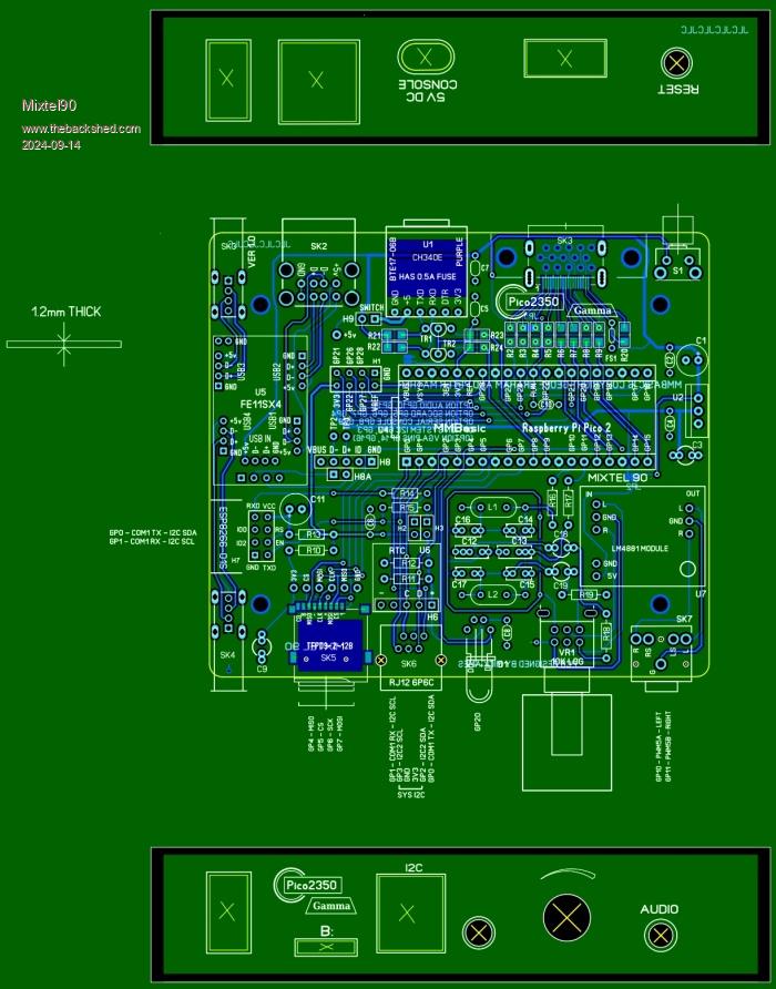

Gamma is here - this is the SMD version.
circuit.pdf
manual.pdf
gerbers-PCB-G.zip
gerbers-plates-G.zip
NOTE:
If ordering from JLCPCB make sure that you get the board thicknesses right. The PCB is 1.2mm and the panels are 1.6mm. I've put the order number string on the backs of the boards so if you set that option you won't see them.
I now have a set of boards on order, in a fetching purple with black panels. I'm feeling a bit Goth today. :)
I *think* the manual is right now. It's been a bit of a hurried editing session today.

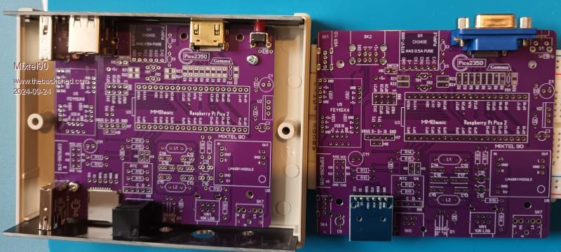

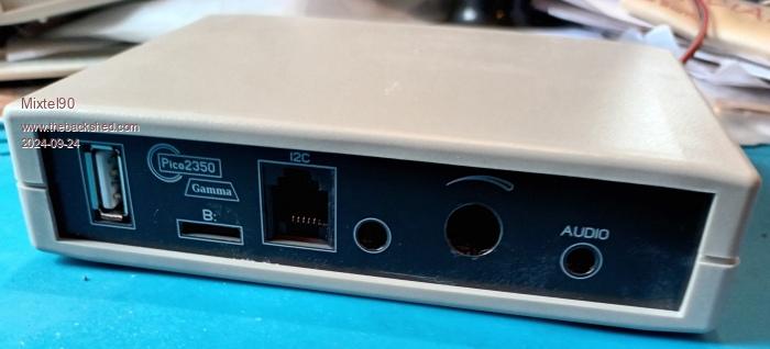

Posts: 9383
Posted: 11:01am 24 Sep 2024
Well, I'll be able to test it soon. :)
The RH board shows the possibility of using a VGA connector and a micro SD module.
I can't complete one of these yet as I'm still waiting for bits. As you can see though, a dry assembly run is looking promising at this stage. It was a great relief when the front and rear panels worked well (at this stage - I've not tried all the parts yet).
A pair of front and rear panels cost appreciably more than the main PCB because they are longer than 100mm. It's mildly annoying. The rear panel is cut out for the HDMI connector. If someone wanted to use the VGA connector it would need a bit of work on their part. I don't intend to do a rear panel to fit it unless there's a demand.

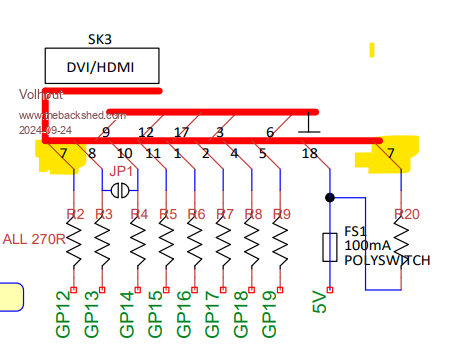

Posts: 6276
Posted: 11:18am 24 Sep 2024
Hi Mick,
Looks beautiful. I like the purple color.
I hope this is no issue (see yellow highlight)
Edited 2024-09-24 21:27 by Volhout
Posts: 9383
Posted: 11:35am 24 Sep 2024
My schematics aren't linked to the PCB design, unlike proper PCB software. That's a mis-trype and the RH one should be 17. :)
