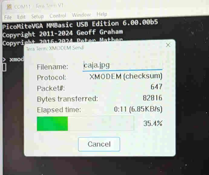

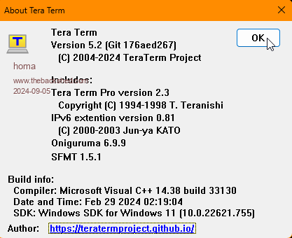

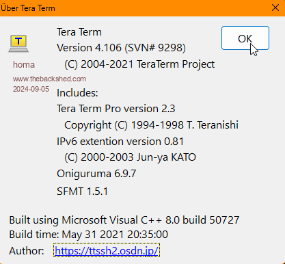

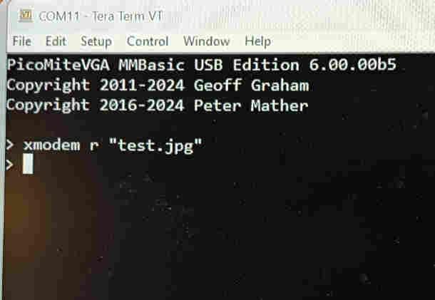

Which Tera Term version are you using, could that be the problem?
homa
Joined: 05/11/2021
Posts: 715
Posted: 04:51pm 04 Sep 2024
https://teratermproject.github.io/index-en.html
I answered the question myself and YES it works with the current Tera Term.
Sorry Peter for taking up your time!

Still an issue with Xmodem. (using TeraTerm v5.2)
Standard Pico from 2024-09-04_000155_PicoMiteRP2040binaries.zip
> xmodem s  '<--Sent the file ok, received without error but heartbeat stopped, no response to Ctrl-C.
'cycle power
option list
PicoMite MMBasic Version 6.00.00b4
OPTION SYSTEM I2C GP8,GP9
OPTION COLOURCODE ON
OPTION CPUSPEED  400000 'KHz
OPTION DISPLAY 55, 148
OPTION LCDPANEL ILI9488, LANDSCAPE,GP15,GP14,GP13,GP7,INVERT
OPTION TOUCH GP12,GP11
GUI CALIBRATE 0, 3939, 3844, -1264, -873
OPTION SDCARD GP17
OPTION RTC AUTO ENABLE
Edit
Also tried OPTION CPUSPEED  64000 'KHz, same result.
Changed to TeraTerm v4.1 and Xmodem works without problem. TeraTerm settings appear to be the same.
Edited 2024-09-05 13:52 by phil99
Footnote added 2024-09-05 17:48 by phil99
Tried TeraTerm v5.2 again, Xmodem was consistently stopping the Pico now no problems.
No idea what is going on.

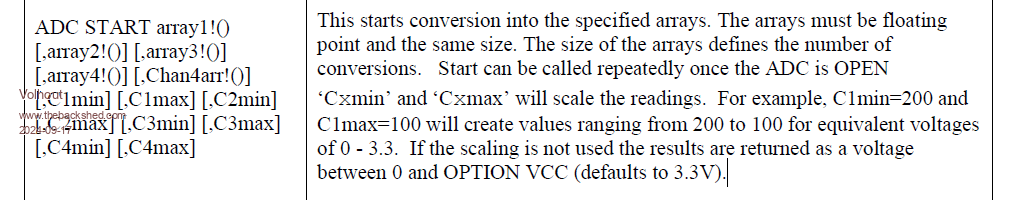

I have a question about the ADC START command. Below is from the V5.08.00 user manual on the PicoMite VGA.
What is the function of the array "Chan4arr!()" in the ADC START command. I understand array1!() up to array4!(), and C1min, C1max etc...
But not the Chan4!arr!().
Or is it an error in the manual ? That Chan4arr!() is a leftover from earlier edit.
Posts: 12037
Posted: 09:15am 17 Sep 2024
Typo, [Chan4arr!()] should be there.
