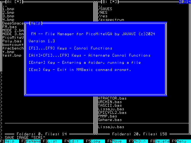

javavi
Joined: 01/10/2023
Location: Ukraine
Posts: 636
Posted: 05:23pm 25 Sep 2024
  Volhout said  @javavi,
I think I found it.
Try this version. It copies, and moves files correctly now.
Problem was caused by the path name, that did not include trailing "/".
Thank you very much for your efforts!
Accepted corrections.
And also added viewing of .BMP files, though in B/W.
FM_v13.zip
