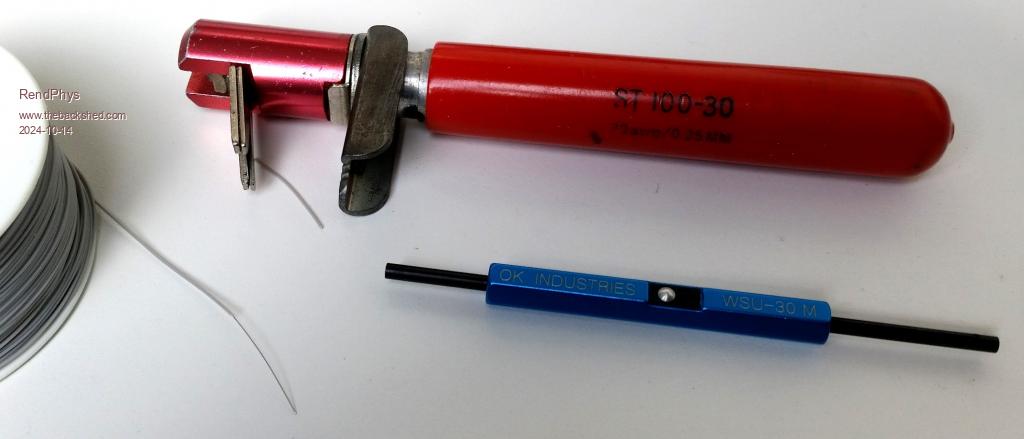

Yes, I used it a lot over 40 years ago (with automatic tooling) and since a couple of years again sometimes, now with simple manual tools. To connect sensor-modules, PCB interconnections, etc. Easy for tests and firmware development.

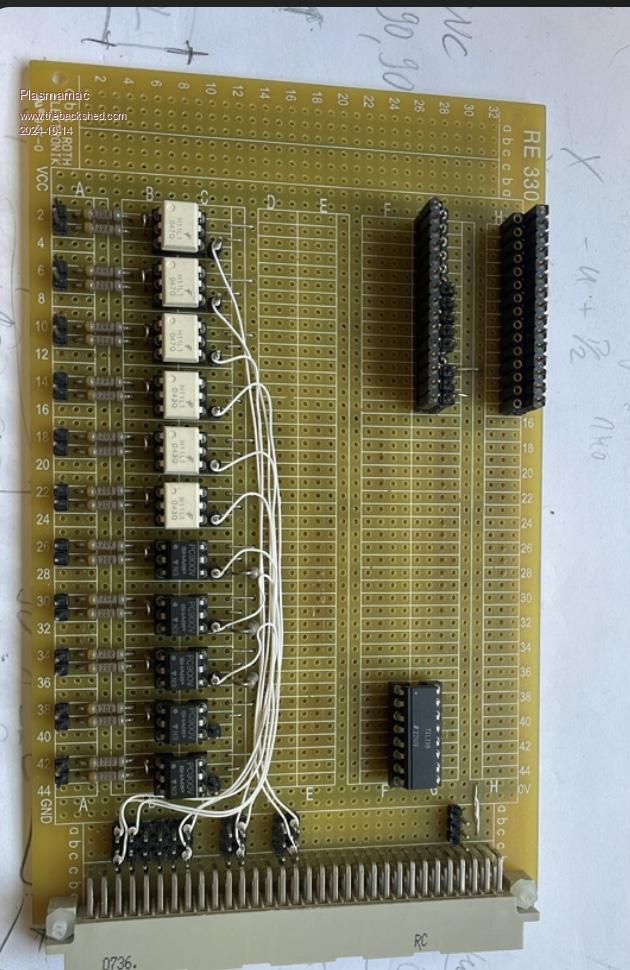

2022  cnc Signal input card

I'm liking this stuff; I have even wrapped wires onto IC socket pins and then soldered the socket onto the proto-board. The wires are then routed down the middle of the socket and are hidden when the socket is populated. Tidy and robust

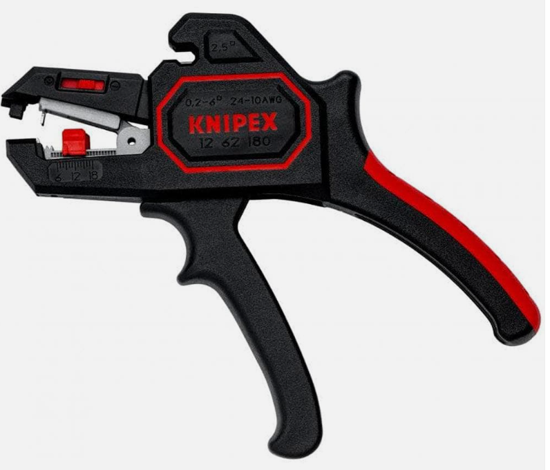

However, I have a Knipex auto-stripper that is only intended for a minimum 24AWG but with this 30AWG it puts just enough bite in the insulation that I'm able to pull it off with my thumb-nail. I like this because I know for sure that the conductor won't make contact with the blade.

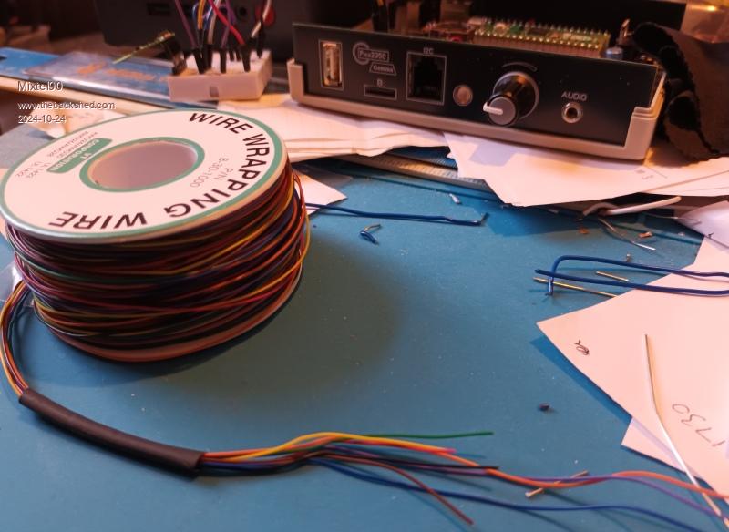

My OK wire wrap tool & wire have turned up. I've just been playing. It's impressive, isn't it? I'm not getting the "modified wrap", with turns of insulation though. Is that just me? The tool is a bit of a **** to poke the wire into, even with my strong glasses!
I can see this being very useful.
By the way, if you thread a piece of suitably sized sleeving over all the strands of a multi-colour spool it helps keep them under control. :)

  Mixtel90 said  By the way, if you thread a piece of suitably sized sleeving over all the strands of a multi-colour spool it helps keep them under control. :)
I don't understand. Pic?
Posts: 8911
Posted: 11:54am 24 Oct 2024
Like this...

  Mixtel90 said  Like this...
Ah, ok, thank you. I was trying to imagine a sleeve on the entire spool, or somehow on each individual wire. Very tidy looking.
