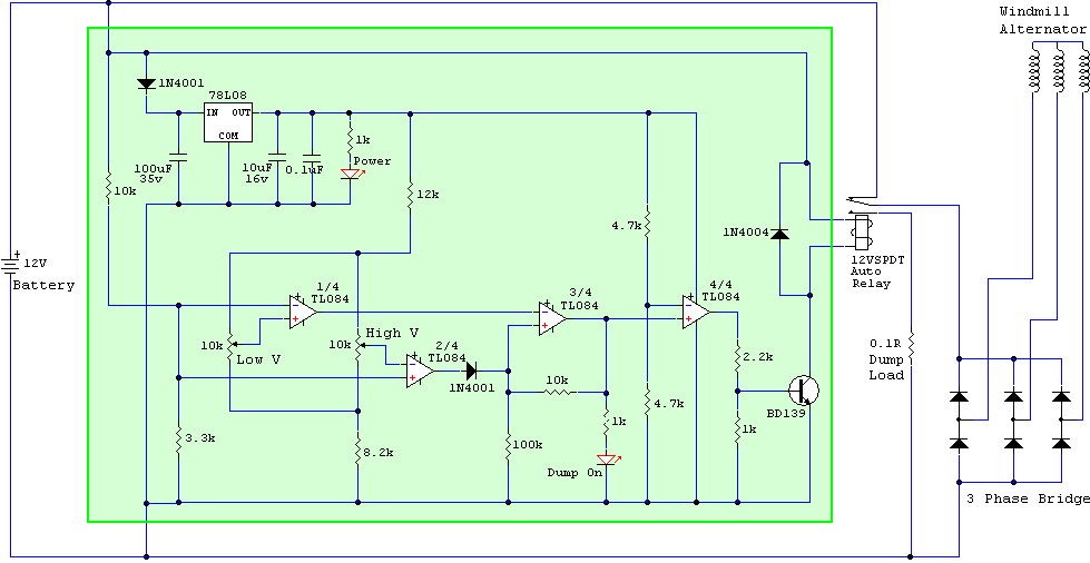

Sorry about that, for the schematic for the controller based on the TL084 ( http://www.thebackshed.com/Windmill/articles/TL084-Controlle r.asp ) I would need to change the relay and use a larger resistor value at R1 and change the 7808 to something that could handle 48V?
Dinges
Joined: 04/01/2008
Location: Albania
Posts: 510
Posted: 07:13pm 22 Nov 2009
Clickable link to story/schematic:
1) The 7808 can't take more than 37V input, so 48V (and probably getting up to 60V) would destroy the voltage regulator. You'd need to replace it with a simple zener regulator (8V2 zener, transistor). Not sure but doubt the rest of the circuit draws more than 20-25mA, so could be relatively light-duty zener/transistor voltage regulator. Maybe make it a 12V regulator and put it in front of the 7808, so you'd still get the accurate voltage regulation of the 7808? Example of a generic zener/transistor regulator: http://www.satcure-focus.com/tutor/page5.htm
2) The relay needs to be one with a 48V coil.
3) R1 needs to be increased to double the value for 24V, i.e. R1=47k
4) All electrolytics (esp. the 100uF one) need to be of adequate voltage.
5) The BD139 has a Vceo=80V http://www.datasheetcatalog.org/datasheet/SGSThomsonMicroele ctronics/mXvrwxu.pdf) ; the BD139 will be (barely) adequate at 48-60V, but leaves you with a very small safety margin. I'd replace it with something of higher voltage rating, just to be on the safe side. Had a quick look, the BD239C (C!) has a Vceo=100V. Any NPN transistor of Vceo > 100V and Ic > 1.5A (depends on the current the relais draws!) should be fine.
If I had to build it for 48V, I think I'd leave the schematic exactly as is (except R1, which should be 47k), and insert a zener voltage regulator of, say, 12-15V in front of the 7808 (tap input voltage for the zener regulator at the junction of R1 & 1N4004; output voltage of zener regulator goes to input of the 7808; also make sure the coil of the relay is still connected directly to the input diode/R1, i.e. coil should be 'in front' of the zener regulator). Replace the BD139 with something suitable for higher voltage, and presto.
You may want to search this board too, I vaguely recall this exact same question being asked a few months ago. Not 100% sure though.
Peter.Edited by Dinges 2009-11-24

The TL783 is a good high volt reg and will handle 125 volt input and adjustable down to 1.25 volts out at a max of 700mA.
They do run rather hot and need a good heatsink.
I have used many of these and never had a problem.
If anyone has trouble finding the TL783 than let me know as i have a heap of them.

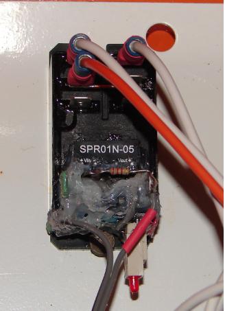

I am testing a new windmill shutdown protection unit. Here is a pic.
This unit is powered from and protects a 48V battery system. This is a commisioned unit, and the relay was requested to be operated at 64V and this is programmable anywhere in the range of 59-65V. The relay is released at 57V, but could be programmed for any voltage 48-58V.
The relay was chosen for 48V operation, but a 24V relay could be used on a 24V system, and the voltages reprogrammed to suit.
The control module will work from 15V to 65V, so would not be suitable for a 12V system without mods. I took the liberty of designing with a DC-DC converter with a simple pre regulator. There is a simple picaxe micro, with voltage sensing, driving a mosfet, that drives the relay. There is some hysterysis and timing involved.
The relay gives full isolation, so the AC can be controlled, pre rectifiers, to give the highest braking ability.
I will be looking at a frequency sensed option, that will give overspeed windmill protection, as well as battery protection.
The component count is 10 for this arrangement [including micro programming port & mosfet], and the power is around 0.25W for the controller on 48V system [all the time from the battery], and 0.2A for the relay when operated.
This could operate a diversion load, but is intended to shutdown the windmill.

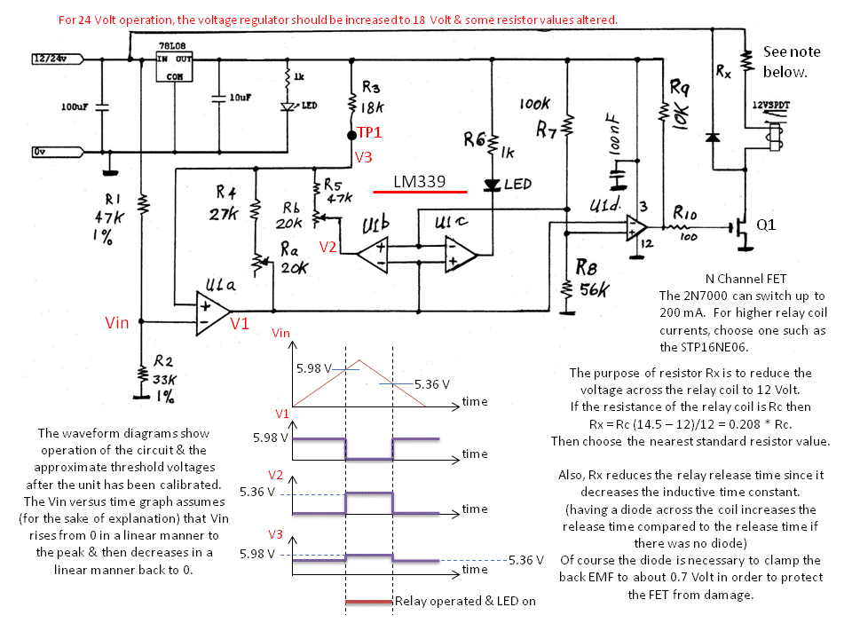

Posted: 09:20pm 06 Nov 2011
I have designed a controller circuit that I believe meets Gizmo's criteria stated in the first post.
I don't have a windmill, so I have not built & tested the circuit.
However, I've been an electronics engineer for more years than I care to remember & most of my designs work as drawn, the rest after minor corrections due to something I missed.
So if anyone needs advice on how to modify the circuit for 24 or 48 Volt operation or has any problems, just let me know.
Len
Circuit description.
The LM 339 is a quad voltage comparator with open collector outputs.
Comparator U1a is configured as a Schmitt Trigger; it has hysteresis due to positive feedback via Ra and R4.
The positive going threshold is set by R5 and Rb (the output of U1b is low because Vin is below the threshold since the output of the U1a is open).
The negative going threshold is set by Ra and R4.
Thus there is no interaction when adjusting Ra and Rb.
The supply voltage is divided the voltage divider formed by the resistors R1 and R2.
When the voltage at the top of resistor R1 reaches about 14.5 Volt, the voltage Vin will be about 5.98 Volt which is the upper threshold of the of the Schmitt Trigger.
The voltage at the output of U1a, will fall rapidly due to the positive feedback to approximately 0 Volt.
The other 3 comparators are referenced to about 2.9 volt due to the voltage divider formed by resistors R7 and R8.
Therefore the outputs of these 3 comparators will change as the voltage V1 passes through 2.9 volt.
The output of U1b will go high and the output of U1a will go low.
Consequently the threshold level of U1a will change to about 5.36 volt.
The output of U1c will go low & turn on the LED.
The output of U1d will go high thus turning the FET Q1 on which operates the relay.
When the voltage at the top of resistor R1 decreases about 13.0 Volt, the voltage Vin will be about 5.36 Volt which is the lower threshold of the of the Schmitt Trigger.
Thus, V1 will go High, V2 will go Low; the LED will go & the relay will release.
Hence the circuit will return to its initial state.
Calibration Procedure.
1. Disconnect the top end of R1 from the 12 Volt line.
2. Measure the voltage at TP1 & adjust Rb until V3 = 5.98 Volt. This sets the upper threshold.
3. Connect a temporary 47 k resistor in parallel with R1 & connect their top ends to the 12 Volt line.
4. The relay should operate & the LED should light.
5. Now adjust Ra until V3 = 5.36 Volt. This sets the lower threshold.
6. Disconnect the resistors from the 12 Volt line & the relay should release and the LED should go off.
7. Remove the temporary resistor and re-connect R1 to the 12 Volt line.
8. The unit is now ready to operate.
