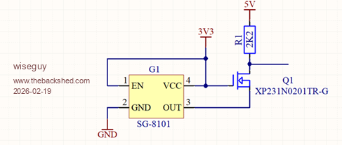

Tim not sure if the 3V3 will drive the EG8010 but if it needs higher drive the simplest FET 3V3 to 5V translator circuit below should work fine.  It will add around 1mA to the consumption.
Untried Clock circuit with 3V3 to 5V translation.
The little FET has 6.5pF input capacitance, the SG8101 is specified as 15pF output capacitance Max. There are not many FETs that would suit this app - maybe you could add a couple to your delayed Digikey order (39c ea $AU) ?

Thanks for the circuit and mosfet PN. In my early testing I used this 3.3v VCXO and in the EGS002 circuit, the scope shows the SPWM outputs. But you are right, it is better to feed it with the right voltage level to prevent possible instability.

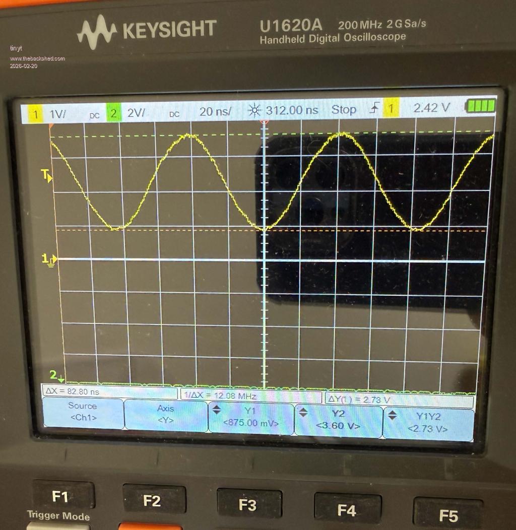

So, I 'scoped the OSC1 of an un-modified EGS002. And it looks like it can work with a 3.3v oscillator. But, I still need to test.

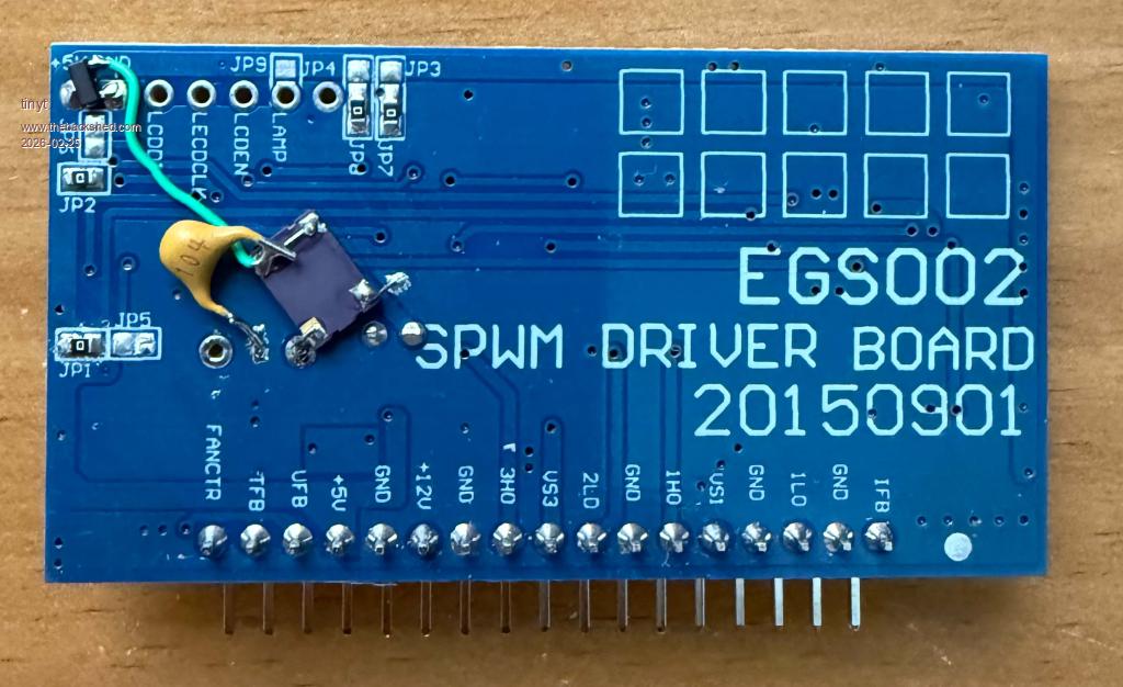

Finally got the EGS002 modified with the SG8101(11.965722 Mhz). It's 3.3 volts vcc comes from a TPS7A0533 ldo regulator. I also added a .1 uf bypass capacitor.
Here is my crude frequency counter test result. It is slightly lower than 60Hz. Hoping the error is just my code. I will find out after several days if it is going to loose time. But I think it will be much better than with the 12 mHz crystal.
Edited 2026-02-25 11:40 by tinyt

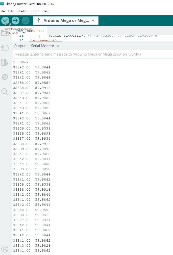

Posts: 3421
Posted: 03:03am 25 Feb 2026
  Quote  Hoping the error is just my code
You can test that by hooking it up to a mains transformer.
If that also gives a 59.98 average after measuring at a few random times over a day your inverter will be ok.

Already did it here:
  tinyt said
For base line, I want to know actual grid power line frequency. Since I don't have a frequency counter, I used an arduino/code and and a 6vac step down transformer feeding it through a 10K series resistor, maybe this is good enough. In the serial output, first column is the timer/counter1 value at the rising portion of the sine wave. second column is the resulting calculated ~60Hz. Jitter in values is probably due to time jitter between rising portions of the clamped sinewave. Still readings are close to 60Hz.
That small sample averages to 59.99814 Hz
Maybe I and my two sons who has the other inverters can tolerate it.
Edit: I did some calculations based on my test data. It seems that an SG8101 frequency of 11.97263 mHz will make it closer to 60 Hz. But, for now I will use what I have.
