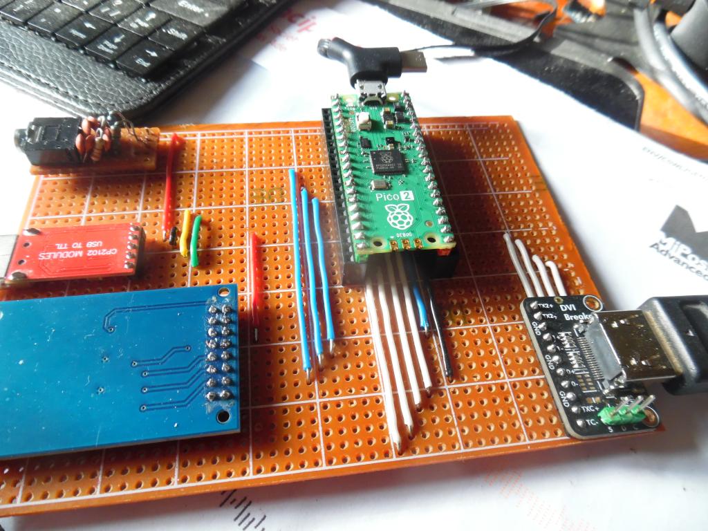

Posts: 2807
Posted: 07:27pm 02 Feb 2025
Mick "
(Superfluous info, Stan. The setup works with a different monitor so the HDMI wiring has to be correct.)
It would be interesting to test this monitor using the Olimex RP2040 board as that has more signals available on the HDMI connector."
I got Olimex RP2040 board with 2350 fitted.
it works, as does stripboard But through hdmi breakout board with Inbuilt resistors.
why is it a i2c display, do they exist?

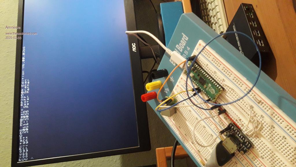

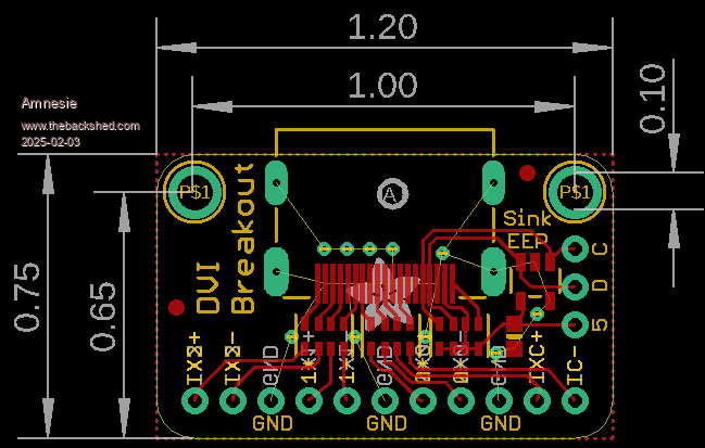

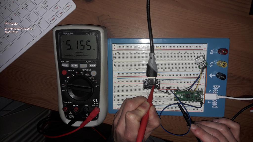

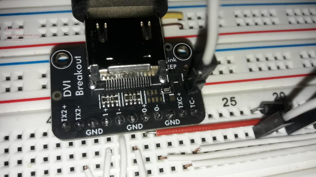

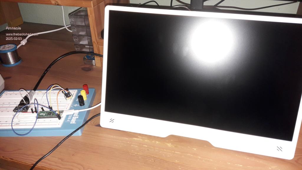

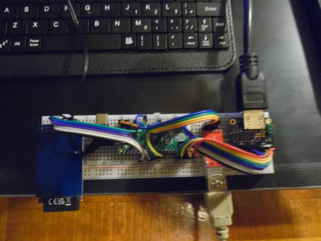

Amnesie
Joined: 30/06/2020
Posts: 763
Posted: 07:55pm 02 Feb 2025
Hi all,
thank you very much for you help. I've attached some pictures.
@ Mixtel:
I did soldered the correct resistor value and it has contact. In fact I've soldered a second one to be sure and measured it.
According to the Adafruit schematic it is not neccesary (in this case) to solder the whole resistor network. So is soldered one 10k pullup (see picture) and the original Adafruit PCB layout. This way the 10k pullup goes to pin 19 of HDMI, too.
Layout:
My "hack":
Measurement between GND and Pin 19 HDMI, HDMI-breakout is supplied via Schottky:
Raspi Monitor not working:
My main work monitor is working:
Javi, the schematic is, as said, 100% the default wiring of the manual for the HDMI version, I just connected a PS/2 keyboard for testing...
Greetings
Daniel
Edited 2025-02-03 05:59 by Amnesie

Your solderless breadboard has to much capacitance, I had similar problems until I removed the HDMI breakout from the solderless breadboard and wired it with "flying leads".  With the HDMI breakout on the solderless breadboard, it would work with some monitors, not work on others, and be intermittent, limited resolution or other strange behavior on a few.  After I got the wiring sorted, it worked on every monitor and TV that I tested.
These HDMI signals are not the low frequency signals that we are accustomed to in the micro-controller world.  Even at low resolution these are high frequency digital signals.  What appears to be a simple HDMI cable is actually a set of impedance-matched transmission lines.
Edited 2025-02-03 06:29 by Sasquatch

Posts: 2807
Posted: 08:37pm 02 Feb 2025
mine started on breadboard and worked and on stripboard ok
I not got others display probs

Posts: 2807
Posted: 08:46pm 02 Feb 2025
no capacitance errors. I found it's the adaptor is ok with bread/strip board.
got to be a reason it works on all tvs with hdmi for me. no 5V to hdmi breakout board.

  Sasquatch said  Your solderless breadboard has to much capacitance, I had similar problems until I removed the HDMI breakout from the solderless breadboard and wired it with "flying leads".  With the HDMI breakout on the solderless breadboard, it would work with some monitors, not work on others, and be intermittent, limited resolution or other strange behavior on a few.  After I got the wiring sorted, it worked on every monitor and TV that I tested.
I can not verify that. Tried direct soldering with short wire same length.
Same problem.
Greetings
Daniel
Edited 2025-02-03 18:55 by Amnesie

Amnesie
Joined: 30/06/2020
Posts: 763
Posted: 05:28pm 03 Feb 2025
  javavi said
  Amnesie said  I now asked for help ...
@Amnesie
Try to check your monitor with this firmware
640x480 @60Hz HDMI+Audio
piconesPlusHDMI.zip
Hi thanks very much for you help. Sadly it doesn't work either.
I put this question up on the original Raspberry Pi Forum and one Engineer worte:
Re: Raspberry Pi Official 15,6 Monitor Problems with HDMI
Mon Feb 03, 2025 2:15 pm
My guess is your are outputting 800x600 which isn't a supported resolution.
But even the 720p doesn't work :D
Besides that, I am returning this product (since I bought it a few days ago), I am dissappointed because the approach should be to support even "legacy" resolutions like the cheapest chineese monitor does; either by scaling it to all corners or by shrinking it to a 4:3 ratio. There isn't even an menu...
Nahh I am done with this thing :) I Rather switch to other portable monitors which do this "trick" :)
Greetings
Daniel

Posts: 2991
Posted: 09:07pm 04 Feb 2025
Hi Daniel,
Just seen your thread about the new RPi HDMI monitor.
As soon as these were announced in the UK I went ahead and got one as I new this would be perfect to use with the PicoMite (and the HDMI firmware - in my case, the non USB variant).
Ultimately I wanted to use OPTION RESOLUTION 1280 (as this is widescreen format), and also wanted mode 3 to give me more than two colours to play with. Then with I2S sound, it would be a great mobile setup for teaching people to code  (and for use in school coding clubs).
However, I ran into many issues along the way regarding getting a decent HDMI image.
I specifically wanted this RPi monitor, and want round circles (rather than use resolution 640 or 1024 which are 4:3 formats and result in stretched circles).
So, I am with you on this one in that using another monitor is not what I’m wanting to do.
I can confirm that it is indeed possible to get an image on the monitor but for me it was only partially reliable in 1024. There was noise BUT it did work.
1280 was ver intermittent and variations in DVI socks, length of hdmi lead, and platform also gave random results.
Do check if you need to set OPTION HDMI PINS as in my screenshot here  in this thread when using an OLIMEX carrier board.
For most TVs, the HDMI input will require you to have 5V present on pin 18. Some DVI socks have this set by default, others need a solder-link shorted.
I have posted on several other threads about things I tried along the way (ie resistor values, track lengths, other Pico boards, etc) but annoyingly nothing has got me a useable image on any Pico firmware in 1280 resolution on this monitor.
I did have success with VGA firmware via a low cost VGA-to-HDMI adaptor BUT there is no widescreen resolution in VGA so hence I am back to seeing stretched circles again! (Not to mention it is mad having to convert vga to hdmi when there is an hdmi firmware available.
Sorry if this sounds like a rant, but I have spent many hours trying different things with this monitor.
