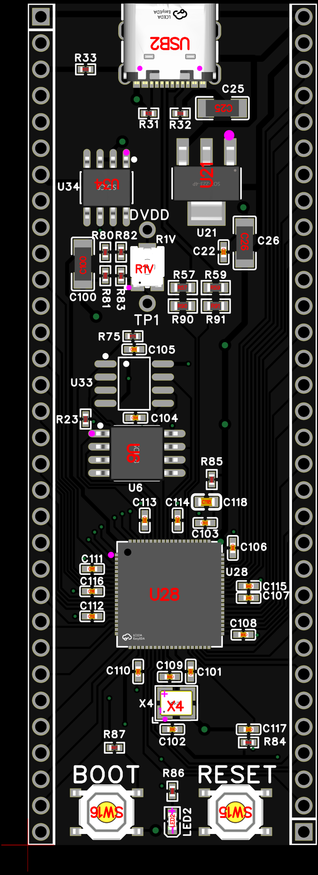

After soldering 2 psrams on and flashing, I get this (joy):
option list
PicoMite MMBasic RP2350B Edition V6.00.02RC15
OPTION FLASH SIZE 16777216
OPTION PICO OFF
OPTION CPUSPEED (KHz) 150000
OPTION PSRAM PIN GP0
> memory
Program:
  0K ( 0%) Program (0 lines)
288K (100%) Free
Saved Variables:
 16K (100%) Free
RAM:
  0K ( 0%) 0 Variables
  0K ( 0%) General
6480K (100%) Free
I soldered on a 3rd psram--what I looks to me like the cleanest job--and after flashing, it always again presents the D: drive, ready for flashing again (which I can do).
Any ideas about cause and possible remedy?
Posts: 12110
Posted: 09:38pm 16 Apr 2025
PSRAM chips wrong way round?
Posts: 3886
Posted: 09:48pm 16 Apr 2025
No, the little dot on the chip is next to the white dot on the PCB.
Posts: 12110
Posted: 09:56pm 16 Apr 2025
Fake PSRAM? You should have paid at least $1 each if not more
Posts: 3886
Posted: 10:40pm 16 Apr 2025
I bought 5 at the same time. First two worked. Paid $.95USD each.
Posts: 2994
Posted: 11:14pm 16 Apr 2025
Also possible to damage PSRAM chip if too much heat applied while soldering; not to mention ‘static discharge!
Avoid the cheap PS chips if you don’t want any headaches (otherwise it is a gamble if they work)
Posts: 3886
Posted: 11:47pm 16 Apr 2025
It behaves as if the Boot button is stuck down, though I can't tell that it is. I didn't think to flash it before soldering in the PSRAM, so don't know if the problem was pre-existing.
I will flash my two remaining modules before trying to solder on the PSRAM. There's little lost if I have to desolder the PSRAM on the failing PCB (if that fixes the problem).
Is there a failure mode for the PSRAM which might be likely to cause this behavior?

Posts: 2994
Posted: 05:25am 17 Apr 2025
Two things.
1: are you definitely using the correct firmware? On one occasion I was stupidly using the wrong firmware and I had exactly this situation where it kept presenting the D: drive (although I may have been loading a newer version on top of an older version).
On loading the correct one, all was good.
2: Something I noticed when I had a lot of the DIL modules in front of me is as follows.
I programmed the first few units with firmware before soldering PSRAM, set the options manually but NOT the PSRAM PIN, then soldered the PSRAM to check unit still worked, then set option for PSRAM pin.
Doing this, all was good (it was just me being curious as to checking all worked at each step).
However, I then took a unit (before PSRAM chip soldered) but set the option for PSRAM pin. On boot up, kept seeing the d: drive. So thinking that soldering in PSRAM chip would solve this, I went ahead and soldered it but unit would not fire up (but d: drive showing). The only way I found around it was to load a wrong version of firmware, then reload correct version. I had tried option reset along the way but some options seemed ‘persistent’.
I have not repeated this sequence of setting option then soldering since this; I just took it as a lesson to solder chip first before setting PSRAM pin option.
Sorry for the long post, but there is some similarities in both the above scenario to what you’re seeing.
Posts: 12110
Posted: 07:52am 17 Apr 2025
  Quote  However, I then took a unit (before PSRAM chip soldered) but set the option for PSRAM pin. On boot up, kept seeing the d: drive. So thinking that soldering in PSRAM chip would solve this, I went ahead and soldered it but unit would not fire up (but d: drive showing). The only way I found around it was to load a wrong version of firmware, then reload correct version. I had tried option reset along the way but some options seemed ‘persistent’.
This is an "unfortunate" feature which I will correct. In the next version setting the PSRAM PIN will be ignored if the PSRAM is not present
